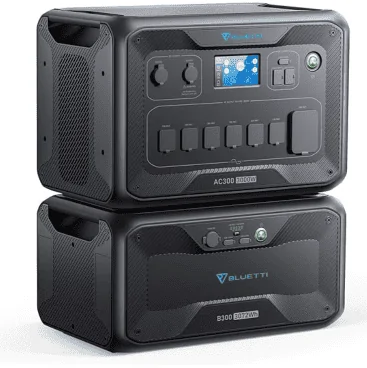

Enter the AC300. This is a 3KWh battery that can output 3KW with a TT-30, 30A plug. I think with the right adapter, the cybertruck will charge at up to 24A over 120V. The battery is expandable up to 12KWh or 24KWh when tethered to a second AC300. Also when tethered, it can provide 240V 30A. I figured YOLO and bought an AC300 and two expansion batteries (6kWh total) for about $3k on sale. The AC300 has two MPPT controllers for up to 2400W direct solar charging plus it can charge up to 3KW from the grid. I figure for the remaining $1K I can build a 1200W solar canopy and run a line to this battery. Room to expand later.
