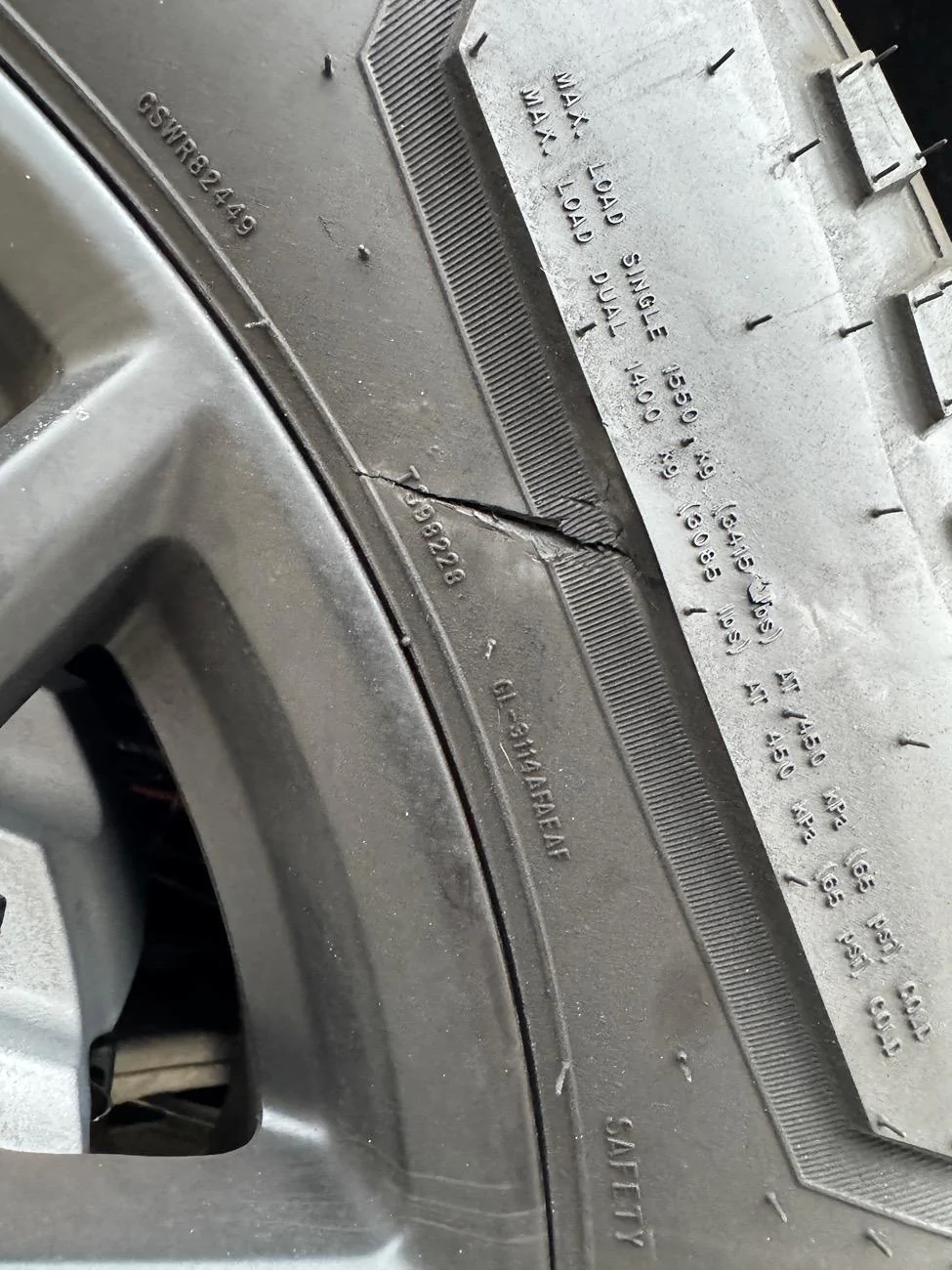

Someone sliced my tire. I'm not losing air, is it ok to drive on it until they restock with new ones???

Definitely road damage and not vandalism.
I would NOT DRIVE with this tire any more than necessary and not at highway speeds.

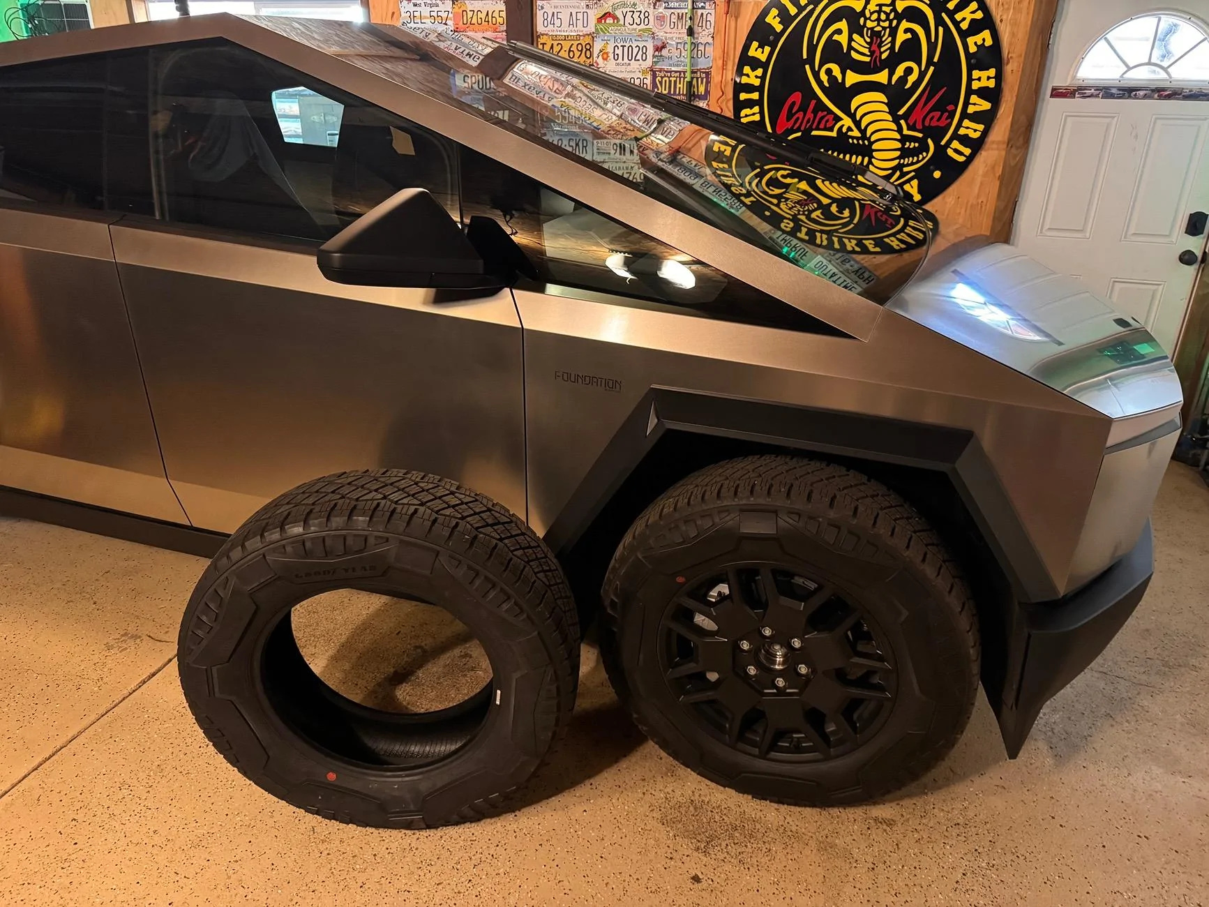

Tesla Cybertruck Someone sliced my tire. I'm not losing air, is it ok to drive on it until they restock with new ones??? IMG_1475

Make sure you post the sentry video, so hopefully someone will recognize the culprit....
There is no culprit. That is a classic cut from driving over debris that had something sharp sticking out of it and the driving over it caused it to rotate back towards the tire sidewall.

I would agree with others, does not look like malicious. 2 reasons, 1. It's missing some rubber out of the cut, do you know how hard it is to cut that rubber, let alone take a piece with it. 2. Why wouldn't they finish the job? If they had the strength to remove a chunk of rubber with it, then they had the strength to puncture it all the way through.

No one slice your tire, it was a curb of object in the roady or driveway. And, DO NOT drive on that tire. Sidewall cuts are bad due to the sidewall being much thinner then the tread.

Just local driving till you get it fixed.
Keep it under 100 (jk).
If it's a back tire your safer than it being a front tire. If it is a front tire and your wait for a replacement is long you might want to move it to the back to be a bit more safe in the event it starts a big leak.
