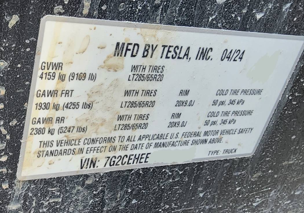

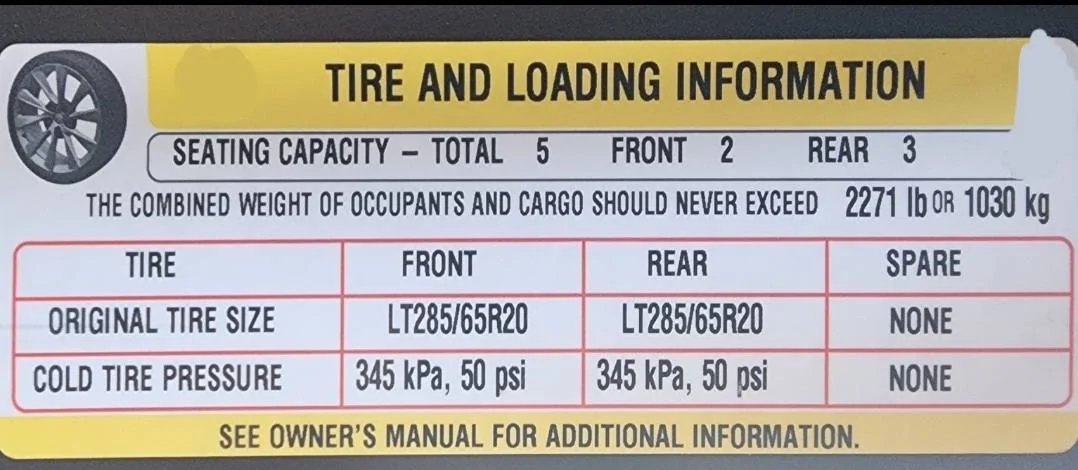

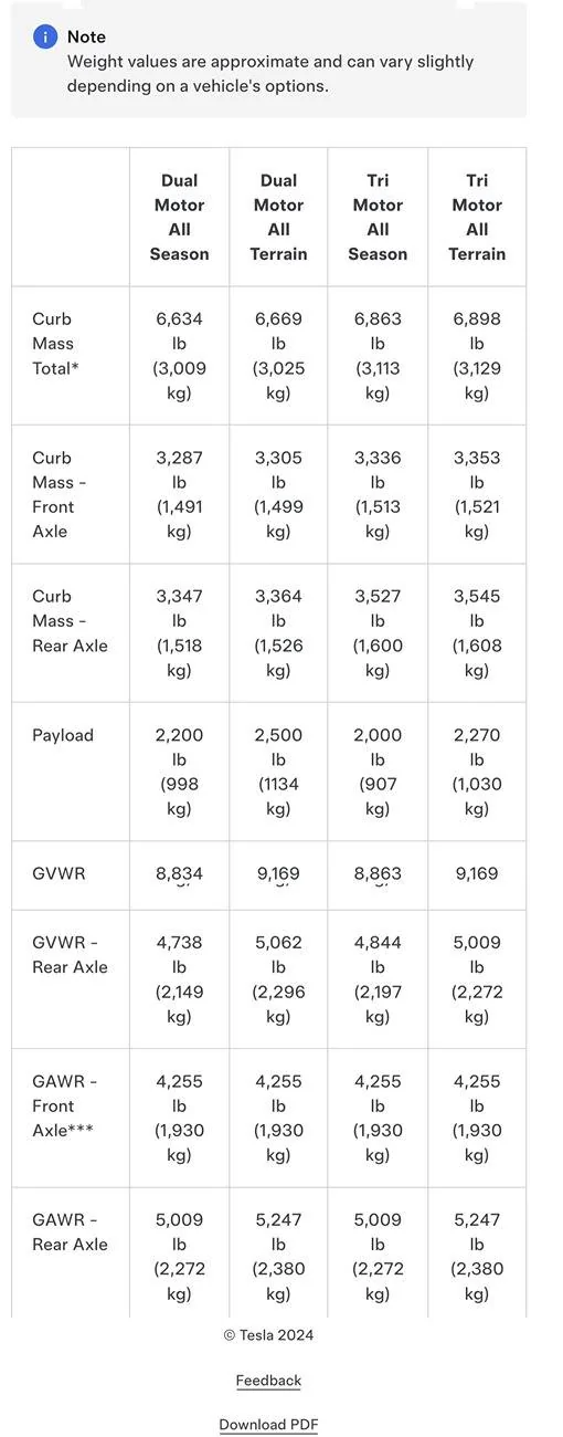

FWIW, the all Terrains are needed for the full payload capacity versus all season. If you need the last 270-300 pounds of cargo. The snow tires themselves are rated for higher load than the all terrains (127 vs 123), but no additional payload due to GVWR/GAWR limits.
This might be a stupid question but if you get the Core Wheels do you know if the actual payload sticker will say a lower amount?

The stickers are tire specific
The manual has the as-built options
Thank you so much! That’s kind of crazy. I wonder if when you get the AT Cyber wheels if there are any other hidden changes. With software or otherwise.

The all seasons aren't Light Truck tires and have a lighter load rating. I think they are 116 so 2756*2 = 5512 pounds max.
I wouldn't think there are other changes than the UI graphic showing all seasons.
