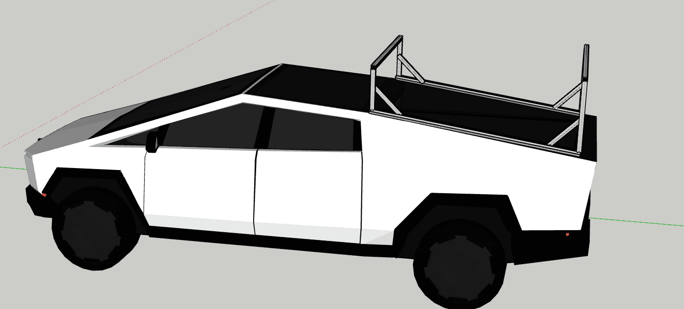

I bet you could use that exact product you linked. With the angle of the CT sails all you would need to do is only lift the rear bar. Just jerry rig the mounting points.
Otherwise this is something you could DIY build with extruded aluminum. 80/20 is a brand, but also the most expensive. tnutz.com is way cheaper.

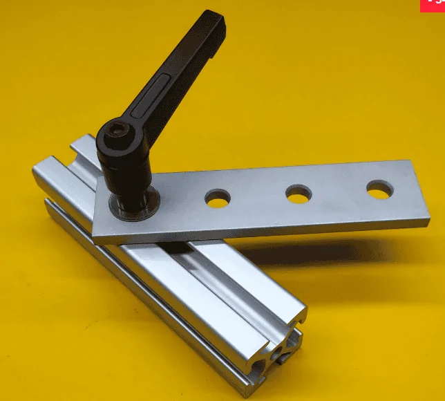

  • Use these quick ratchet locks to attach the pieces when you need it.: (LH-015-A) 15 Series M8 Locking Ratchet Handle w/washer and Standard T-Nut

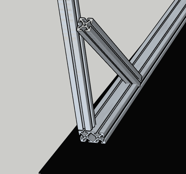

I love these standardized aluminum sets, they are like Legos for adults, and it cuts easy. As long as you design it for the weight to not be on the hinges, it will support a lot of weight. You can add extra beams to make triangles to resist the force on the load when braking and accelerating. The same design as the product you linked.
Other than the 2 long pieces attached to the sails and cross beams, everything else could fit inside the underbed storage box when not in use.
