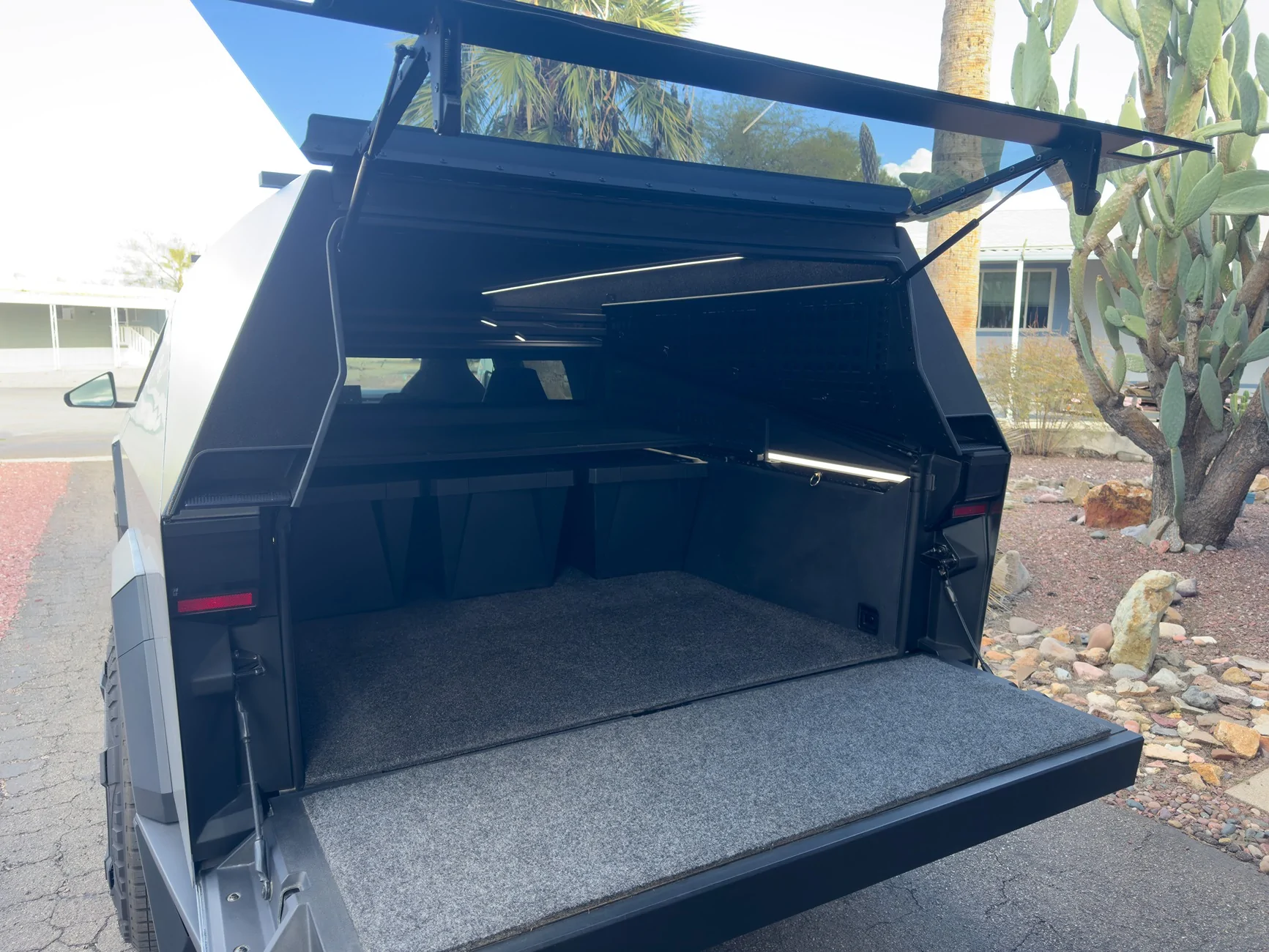

Yes, that's the item I ordered. There is no trim sewn around the edge and no logo. There was enough to do the bed and the tailgate and there was still a little bit left over. I used heavy-duty double-sided tape to secure the carpet to the tailgate and it has held fine. I did not make cut-outs for the D-rings, etc., or for the trap door, thinking that I'd use it for a while and see how I liked it first. I ended up leaving it with no cuts. Access to the under-floor storage is not a problem because the material is light enough in weight that it lifts easily without special slits. If I ever need to hook into a D-ring in the future, I'll just cut an opening at that time. If you've used a Bed Rug before, I don't have to tell you how great this stuff is. I will never have another truck without putting this material in it.

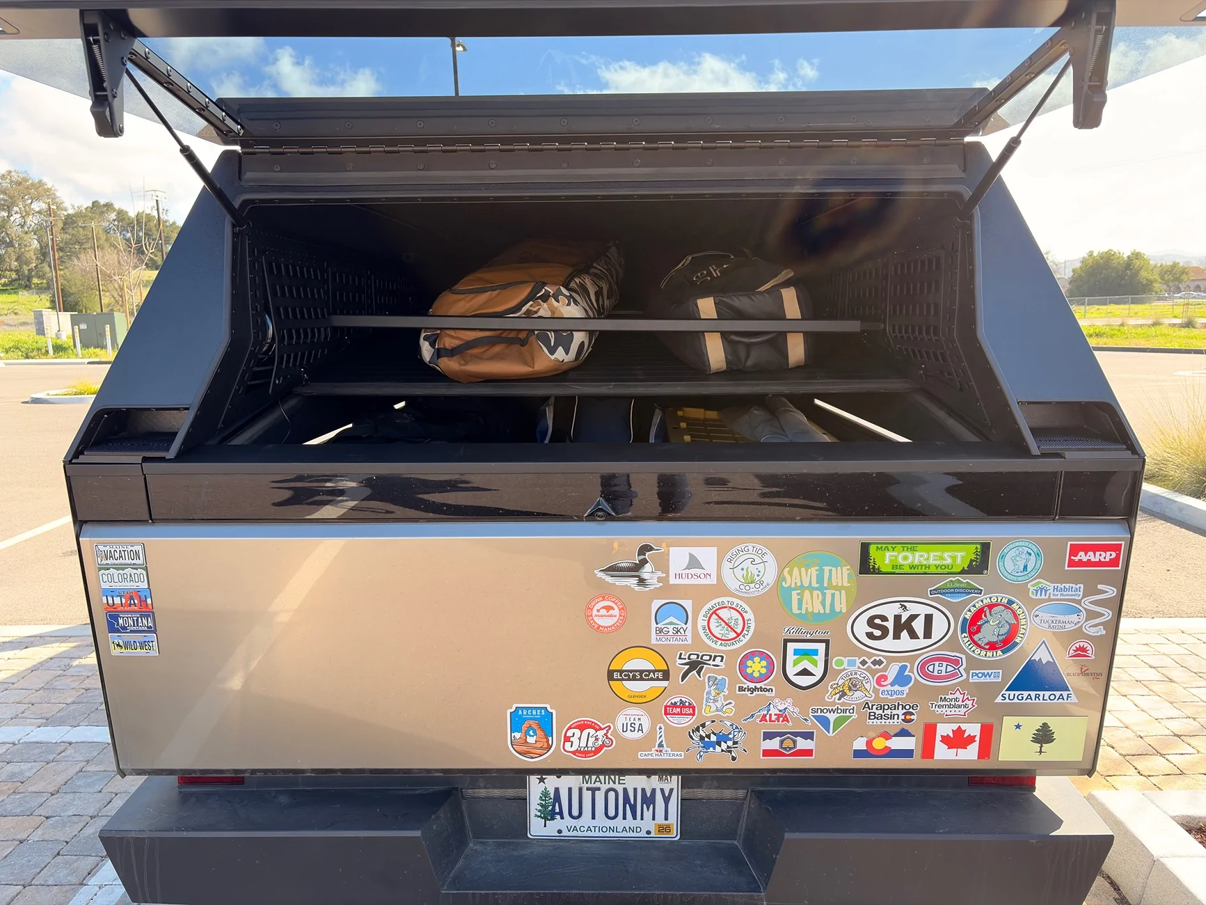

I’m in SLO right now getting my cap installed. Lee is here. Orion has the day off. I should have taken a pic with the cap suspended with all the accessories installed before they backed my truck in. Nice small shop.
im pretty psyched to finally get it.

I didn’t ask directly, but I joked that I wouldn’t come back unless they made a Wedge, and Lee did say they’d need to sell a lot of caps, first.

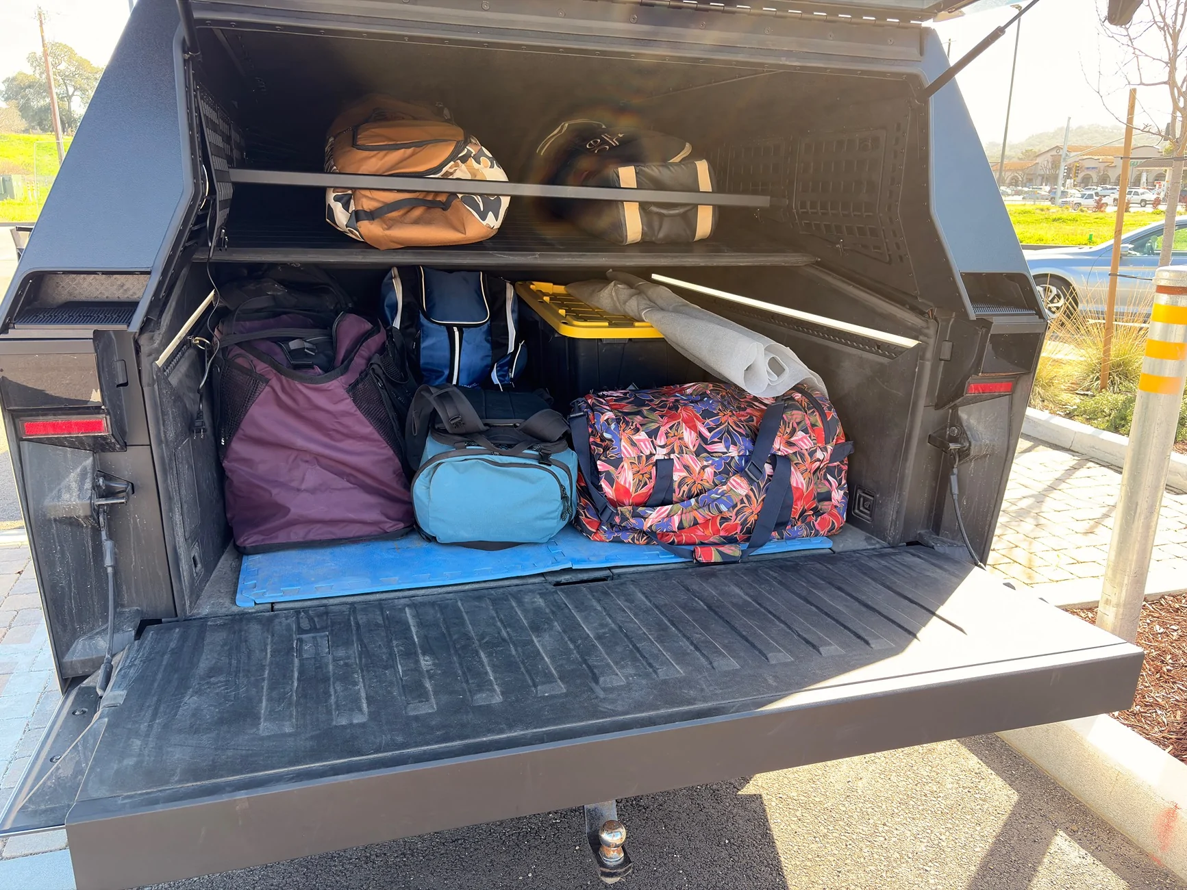

I like the interior crossbar that connects to the Molle panel. It can hold my two ski bags with 5prs of skis on top of the tonneau.
I drove to Mammoth tonite, 8hrs and initial impressions is that there’s no additional wind noise. And the efficiency seems to be 5% worse.

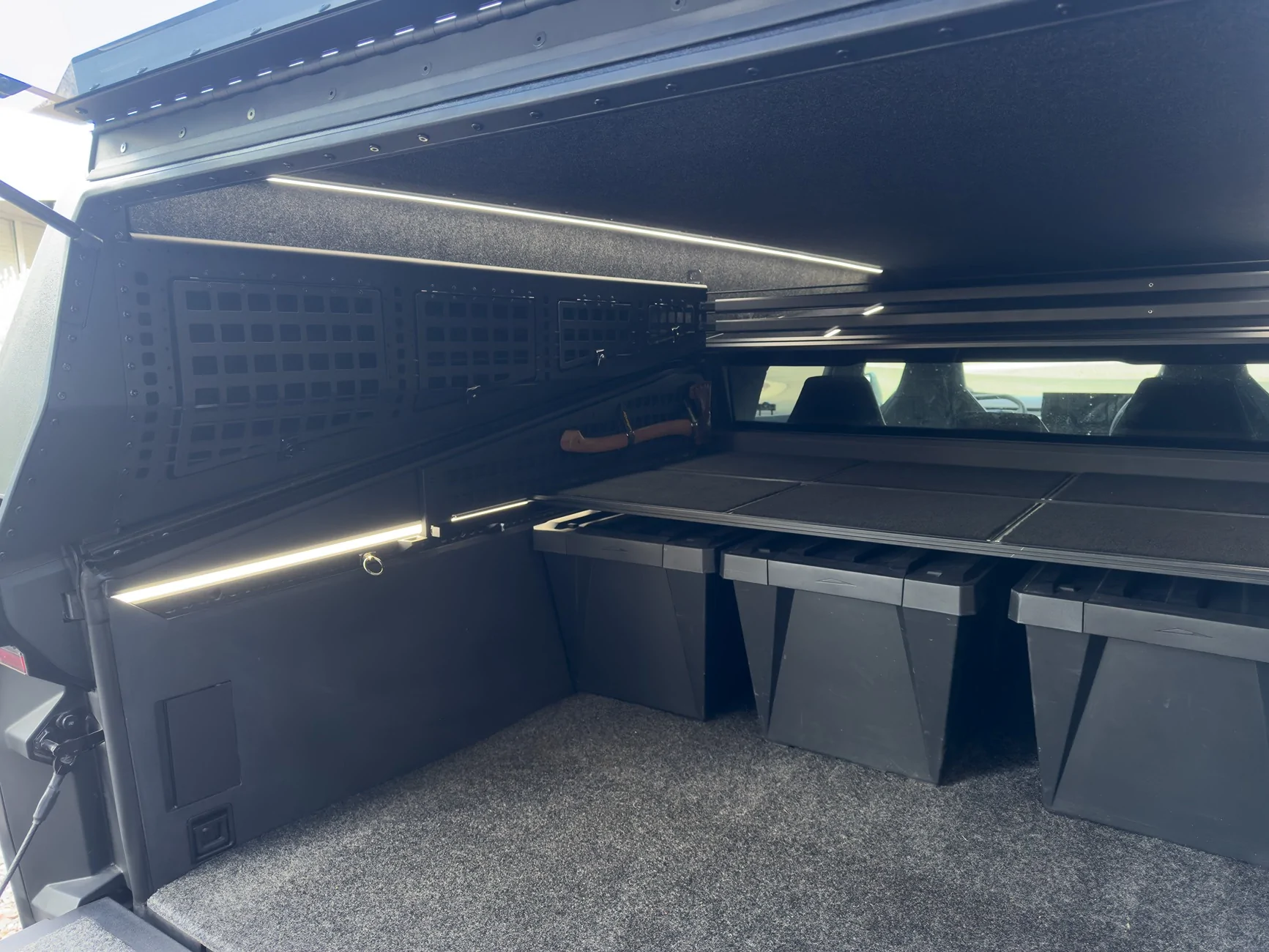

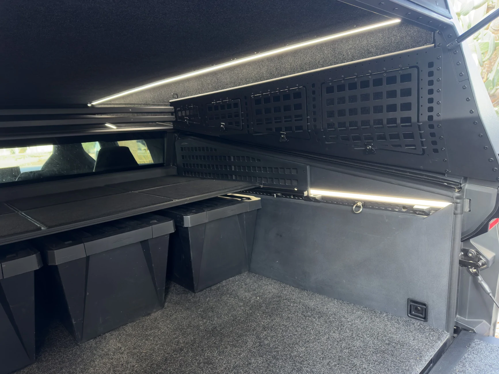

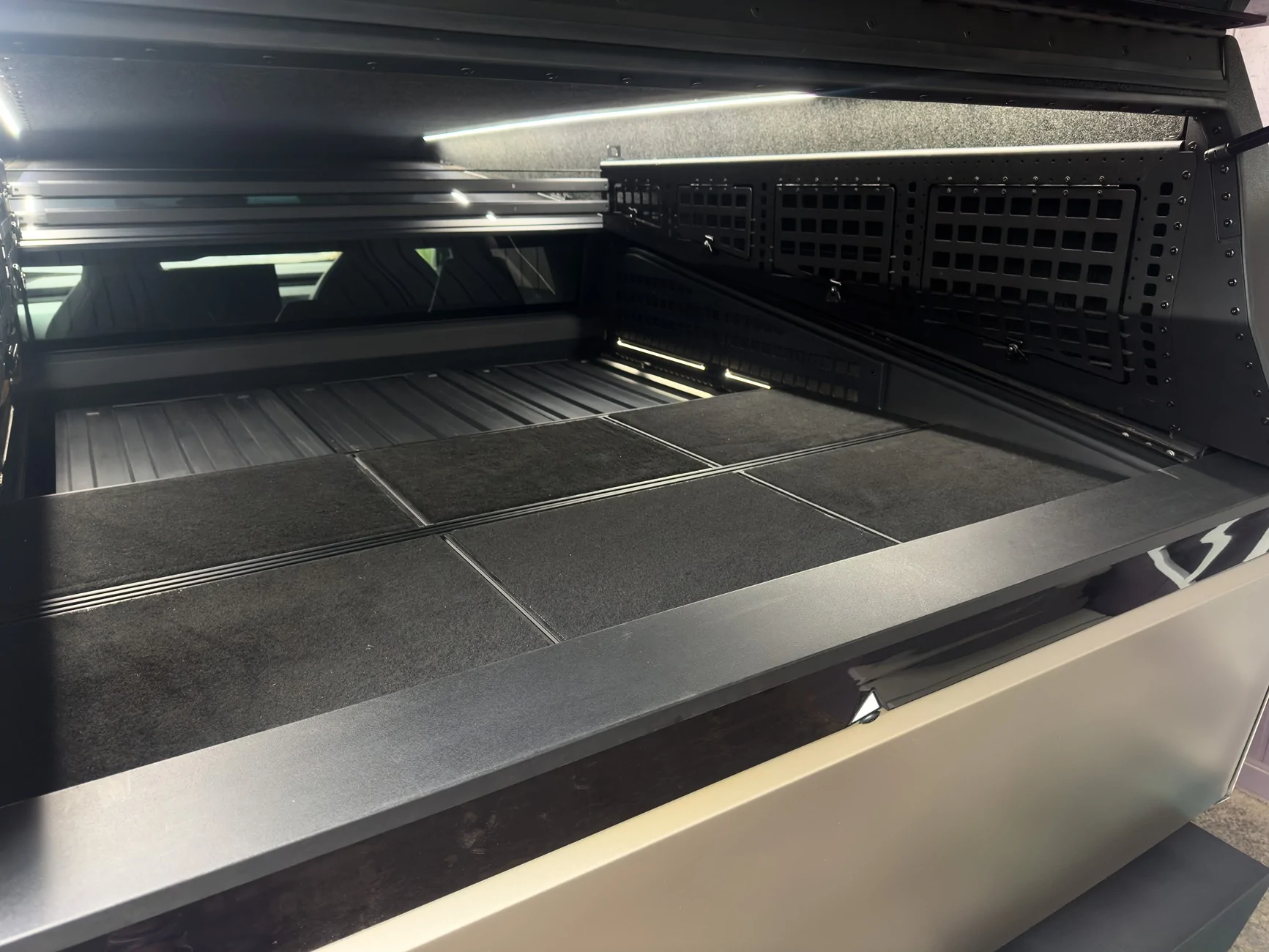

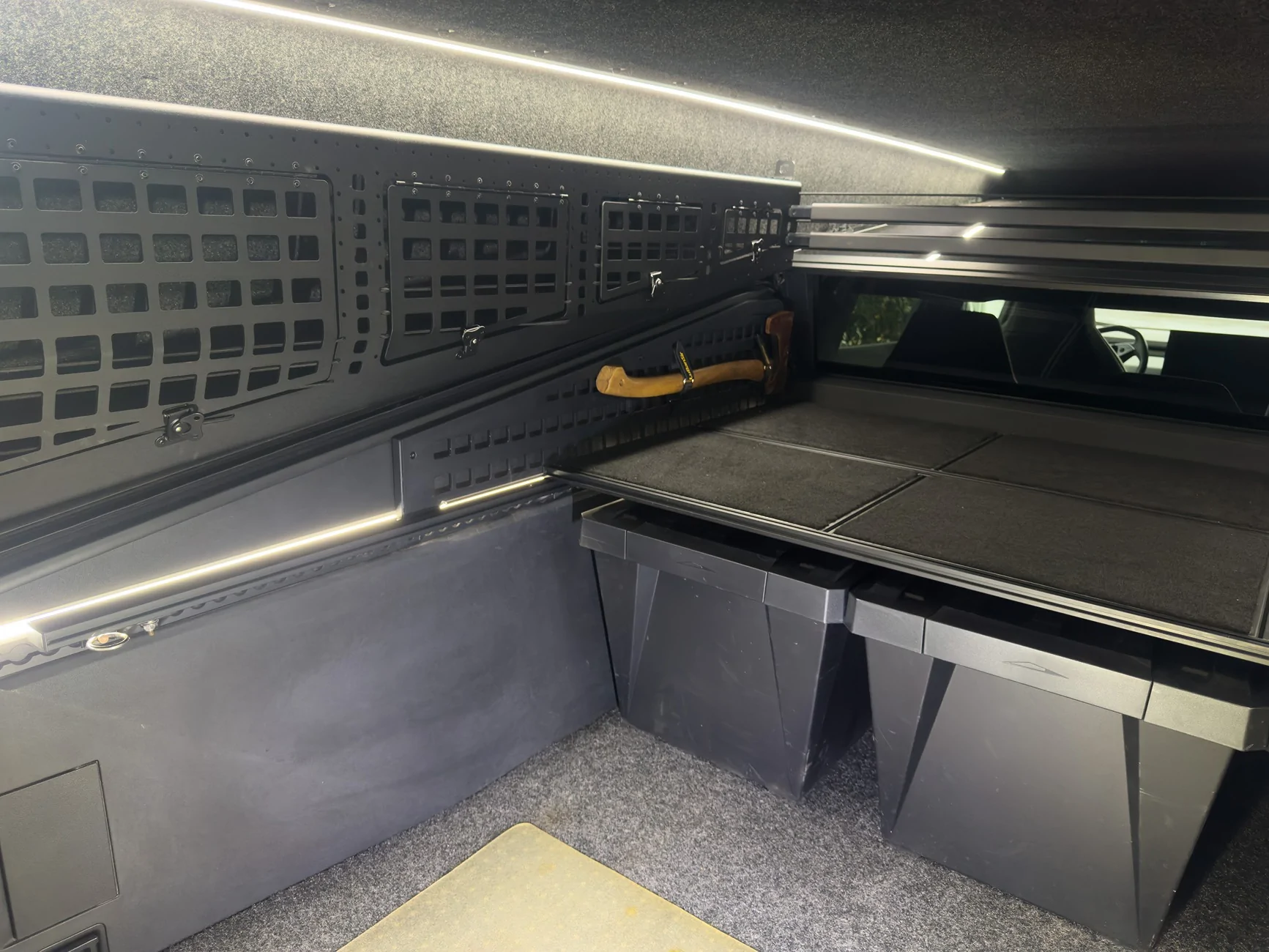

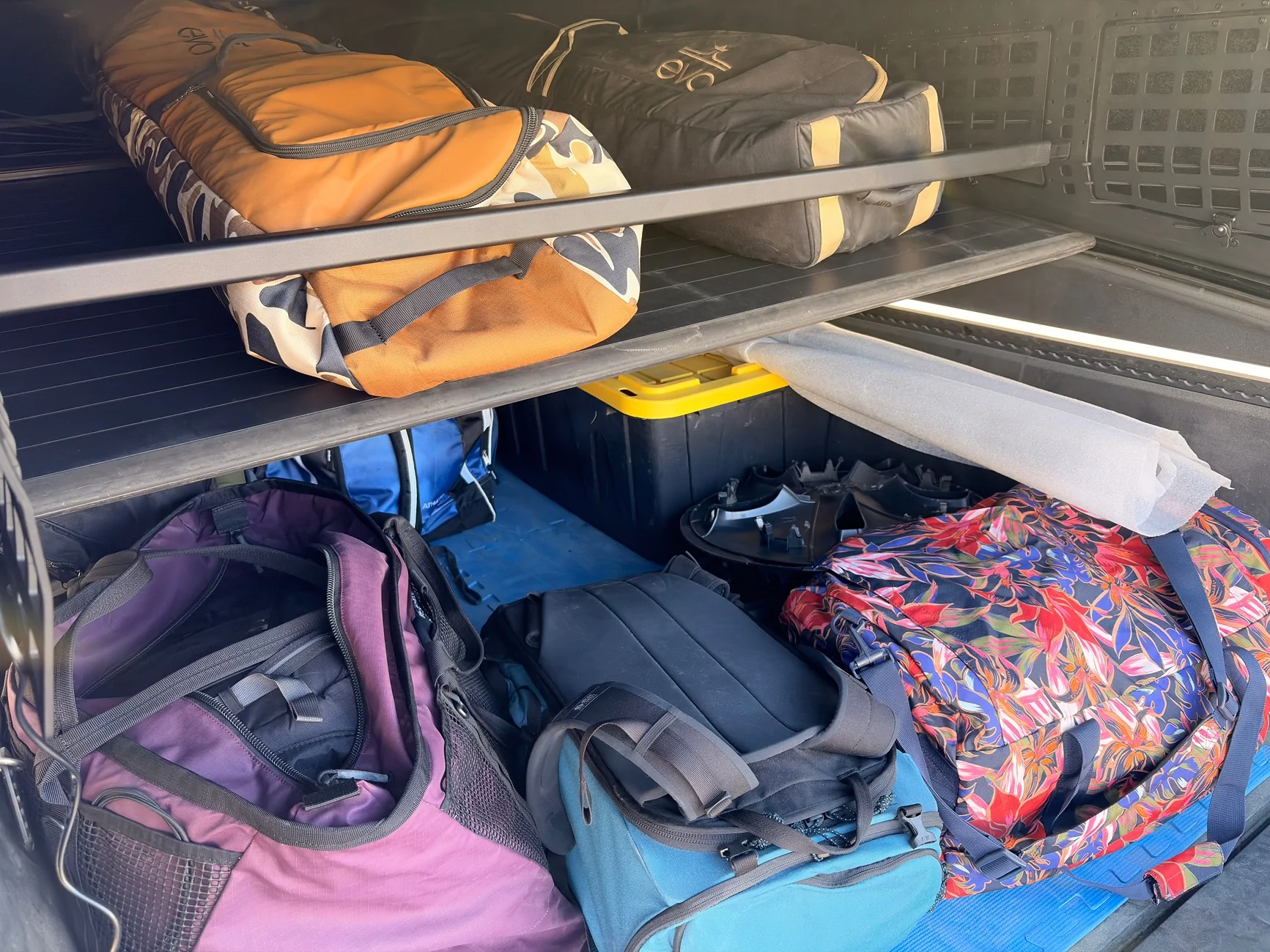

Made it out of black extruded aluminum (2020 and 2024?) from Amazon. There's two shelves which lay adjacent to one another and rest unattached on a rail that's attached to the vault's L-track on both sides. They're light weight and easy to remove.
The shelves are each 16" deep (so... 32" deep laying side by side, which is half the front-rear dimension of the vault) and 56" wide (the width of the vault between the Molle panels). The 2020 pieces form a frame in which removeable panels are inserted to form the whole shelf. The panels are made from 5/8" plywood wrapped in black felt-like material. They are held in place inside the frame by resting in light-weight aluminum "L" channel attached to the 2020 frame. This description sounds WAY more complex than it really is.
The rail that the shelves rest on is longer than the depth of the shelves so that the shelves can be slid forward to gain access to cargo beneath them if necessary. This design was important and useful when I made a similar one in my previous trucks, as I could reach in through a side window of the 'topper' without having to crawl into the box to fetch something. Of course that's not possible now with the CT plus Cap. However, I still like being able to simply slide one shelf up and on top of the other (or remove it all together) to make room for something too tall to fit beneath it. With the Cap now installed, I plan to replace the side rails with ones that extend all the way to the tail end of the bed and add two additional shelves. This will form a solid second layer over the entire bed area on which cargo can be placed either atop or beneath. If nothing is placed on top of that new rear section, the tonneau can still be closed. Or you could stack the shelves on top of the more forward ones or remove them altogether and set them aside. The aluminum 2020 rails are very rigid and need no support under them even with a hefty load resting on them.
Do you have any closer pictures of the shelf you made?

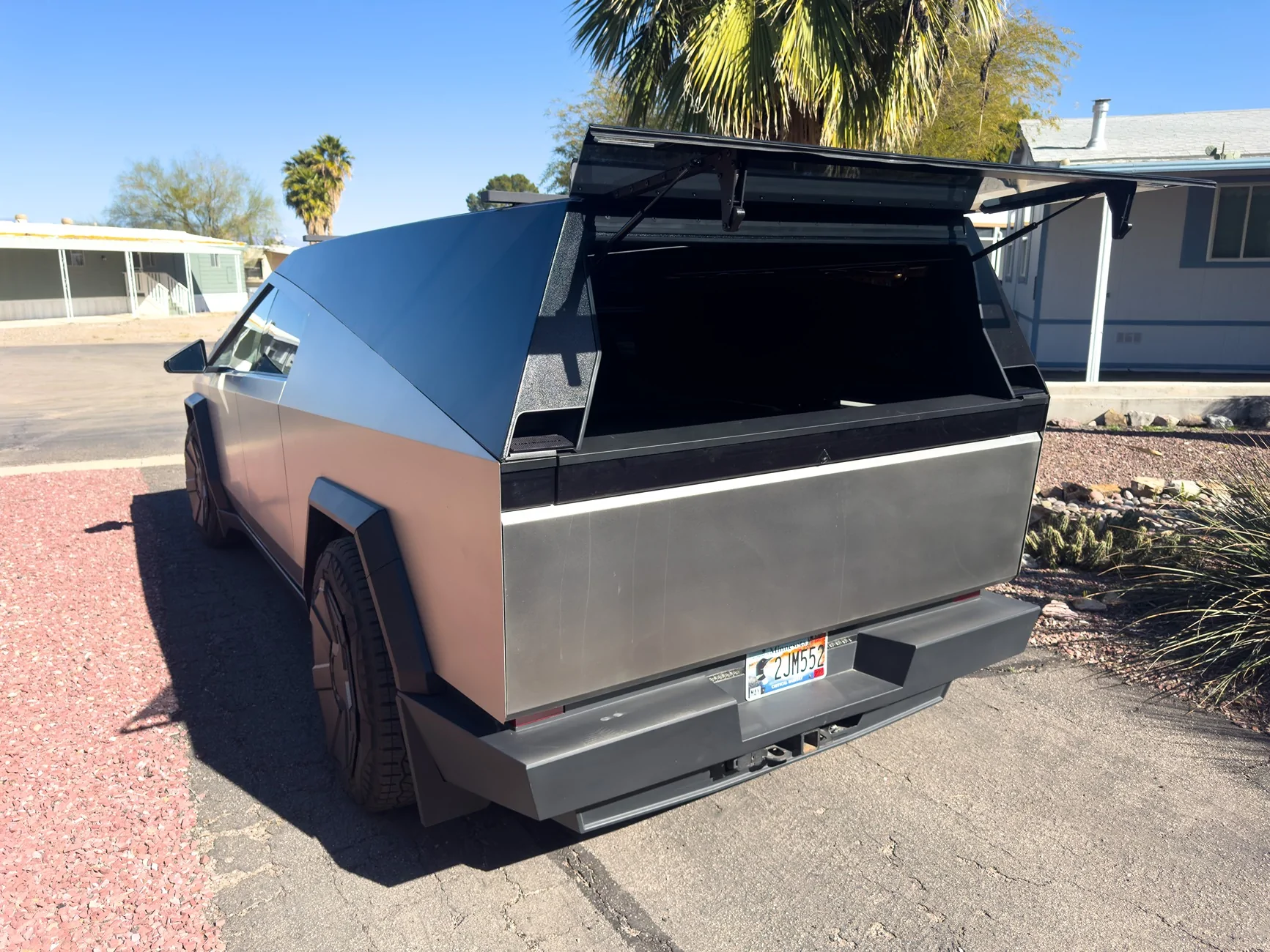

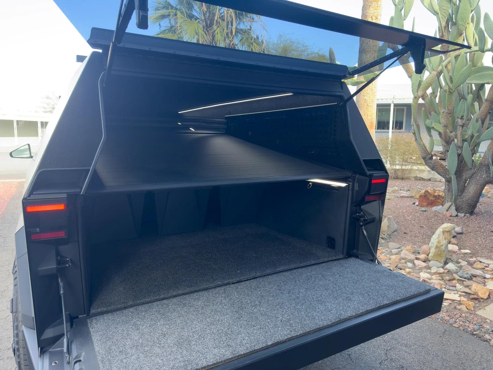

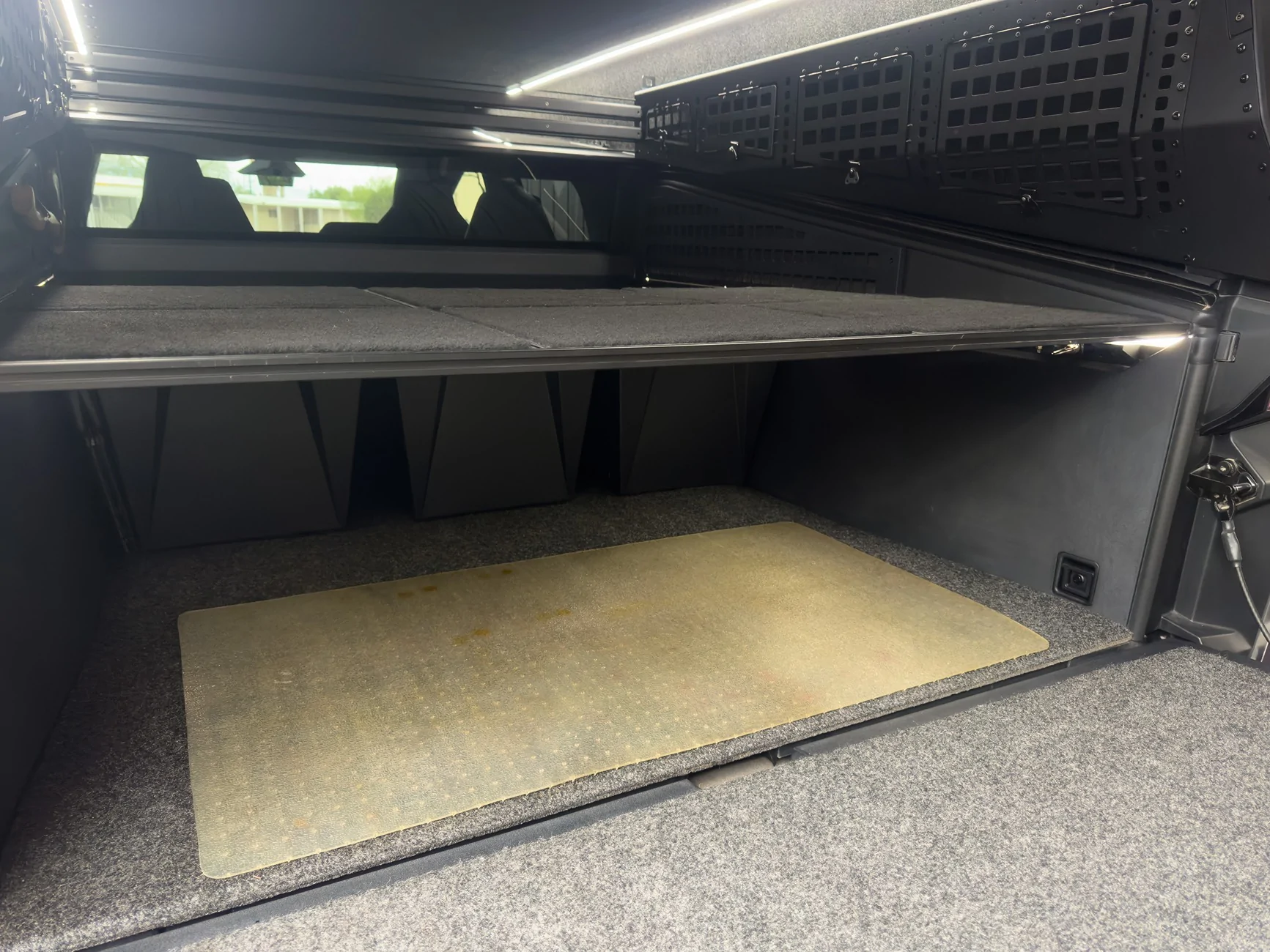

The first two pictures show the new rail which now extends all the way to the rear of the vault.
The third and fourth picture show the shelf units slid all the way to the rear end of the vault (#3 tailgate closed, #4 tailgate open). As I mentioned, I will make two additional shelf units that when combined with these will make a complete second level on which to store items. The last picture show how the shelf panels are constructed, with two of the inner panels removed. These two shelf units have three removable panels; however, I think the new ones will have only two, or maybe just a single panel.

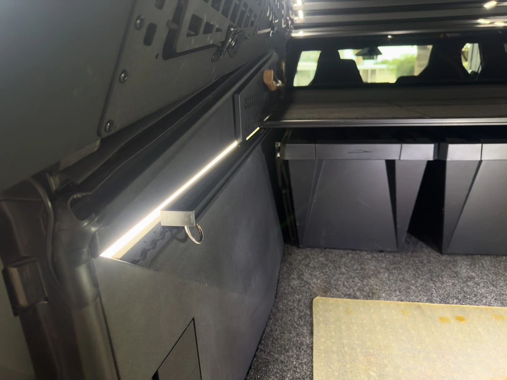

Here's another picture showing how the support rails are attached to the sides of the vault. I positioned Cybertruck L-Track Hooks in three locations across on each side, and secured a length of 2040 extruded aluminum rail to those hooks. The rail rests atop the L-track hooks and is held in place with a small carriage bolt hanging from the underside slot in the rail and through the opening in the hook.
The side support rails are made from 2040 extruded aluminum. The frame of the shelf unit is made from 2020 extruded aluminum. The extruded aluminum pieces, as well as the fittings to attach them all together, were purchased on Amazon.
