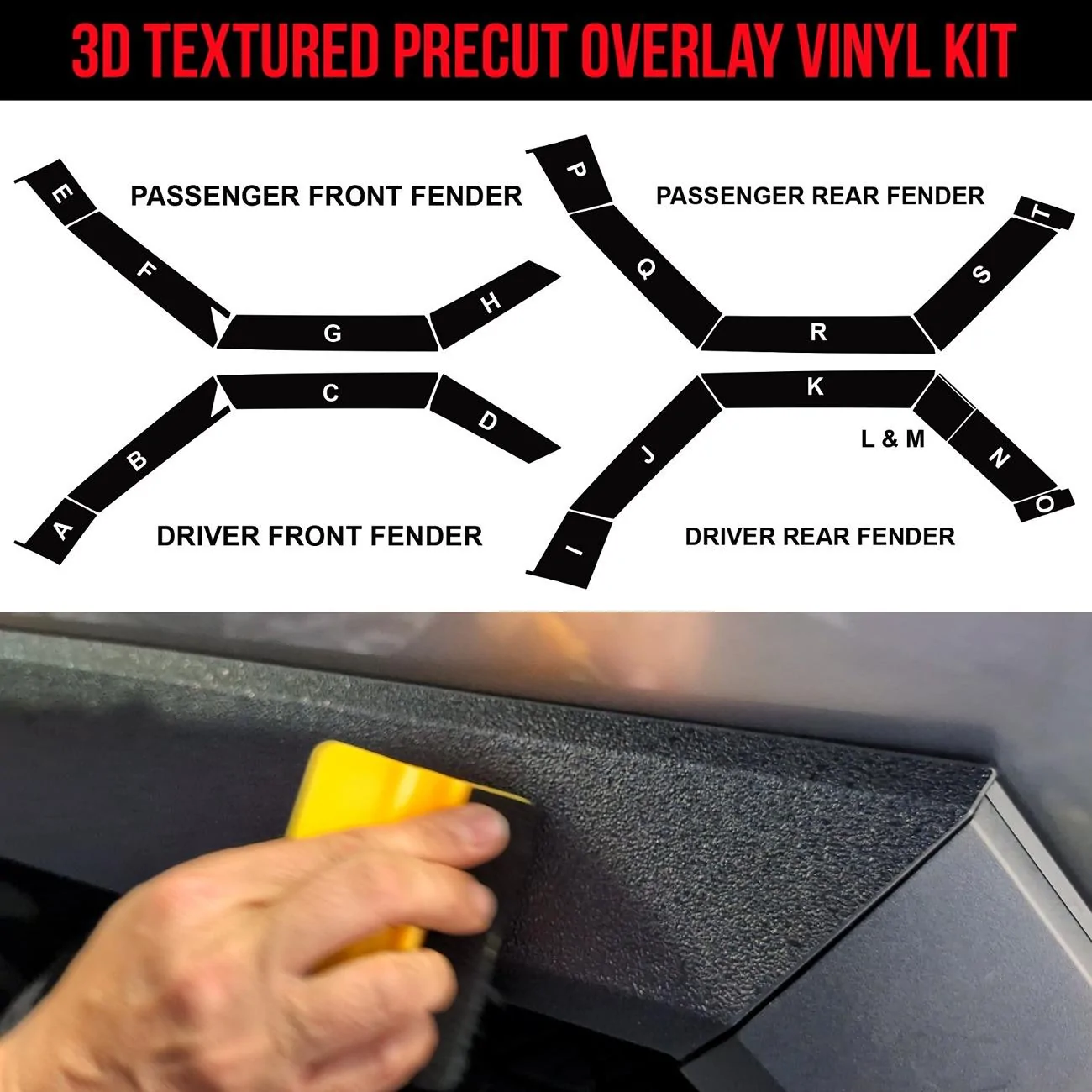

Additionally, don't forget to check out our DIY fender protectors. They not only enhance the look of your Cybertruck but also protect those easily scratched plastic panels. Click here to explore.

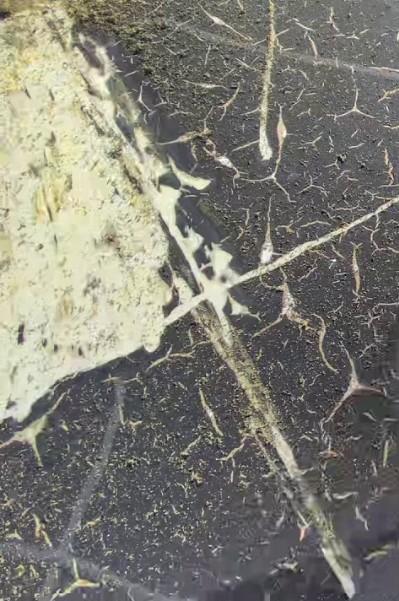

Ease of Removal:
  • PPF:
    • Ease of Removal: PPF is designed to be removable without damaging the underlying paint. The removal process usually involves applying heat to soften the adhesive, allowing the film to peel away cleanly. PPF typically leaves minimal adhesive residue, especially if pulled towards you at a 45 degree angel which can be easily cleaned off with appropriate solvents. PPF has a much lower chance of removing paint or causing damage to the paint if pulled off correctly and if the paint was done correctly. If left too long, way over period of removal, I've seen some 35 year old clear bra on vehicles, these can be very time consuming to remove.
  • Vinyl Wraps:
    • Ease of Removal: Vinyl wraps are generally easier to remove than PPF in the early stages of vinyl. With proper techniques, such as using heat to soften the adhesive, the wrap can be peeled off without much residue pulled towards you at a 45 degree angle. However, if the vinyl has been on the vehicle for a long time, especially in harsh climates, it might leave more adhesive residue that requires thorough cleaning, especially with brands such as Oraguard and KPMF. If left too long the wrap will come off in little pieces and most likely has done damage to the clear coat or paint of the vehicle. Please see attached image. Additionally, older or lower-quality vinyl may tear during removal, making the process more tedious.
