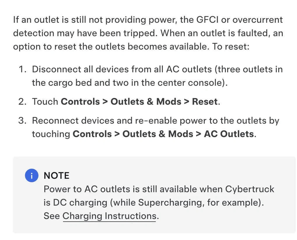

I get that it's not working on your truck and that service people told you it is expected behavior, but that is not the way it's supposed to be.
Not sure if this applies (I haven't dealt with the outlets while Supercharging personally):
Are you re-enabling the outlets after you park and get out of the truck? Alternatively, do you have "keep outlets on", or "Enable Cabin Outlets on Entry" enabled?
Check the service menu for alerts regarding the PCS, outlets, and ACDC converter.

Yep, since i was on a 2k mile trip 1 week ago, I have outlets on, outlets on on entry AND outlets permanently on for 12 hours.
And every single time I plugged to charge, my starlink would shutdown, fridge would beep into off mode, scooter and bike would stop charging and all outlet selections inside the menu become grayed out. As soon as I unplug, everything is re-enabled, starlink turns on, fridge beeps on, and scooter and bike continue charging.
I've had the reset outlets message popped up a few times, actually while not using any of the outlets and just entering the car in the morning. I'll say that happens once a week on any regular day, not during road trip. I just press reset and message goes away, and outlets working fine.

Something isn't right then. What current do you AC charge at?

I have had this happen until I started to receive a multitude of errors resulting in the PCS being replaced.
But you are wrong. AC outlets are indeed available when DC fast charging. I have 3 dogs that ride in the vault and I have a camera, ecoow wave 2, LED lighting. They do shut off for a second or so, but once the charge rams up the AC outlets become available.
Dude has everyone telling him that his PCS has an issue, but he doesn't want to listen lol

you are incorrect, I've had an entire discussion/complaint with Tesla service center, as I believe it to be ridiculous you can't use the outlets while charging the truck.
So go argue with them, but the vehicle WILL DISABLE all outlets automatically the moment you connect any charger to the truck.
I just went on a 2k mile trip from San Diego to Idaho and back, supercharged 8 times, and I wanted to charge my Stark Varg on 240v and a scooter on 120v I had on the bed while I was supercharging, and the answer is NO, you can't.
If you disagree as to why you can't, fine by me, I ain't a cybertruck engineer, but regardless as to why, again, the answer is NO, you can't.
I’m genuinely not trying to stir the pot here but I did this very thing just yesterday. Charged my Ecoflow power station while charging the car at the supercharger. I’ll grab you a video when I’m off work. The nice thing is you should be able to see the input displayed on the Ecoflow screen.
I’m not sure why that didn’t work for you. Was the plug maybe tripped by the stark varg or the scooter or both? Did you try check the outlets and mods screen for the reset?
