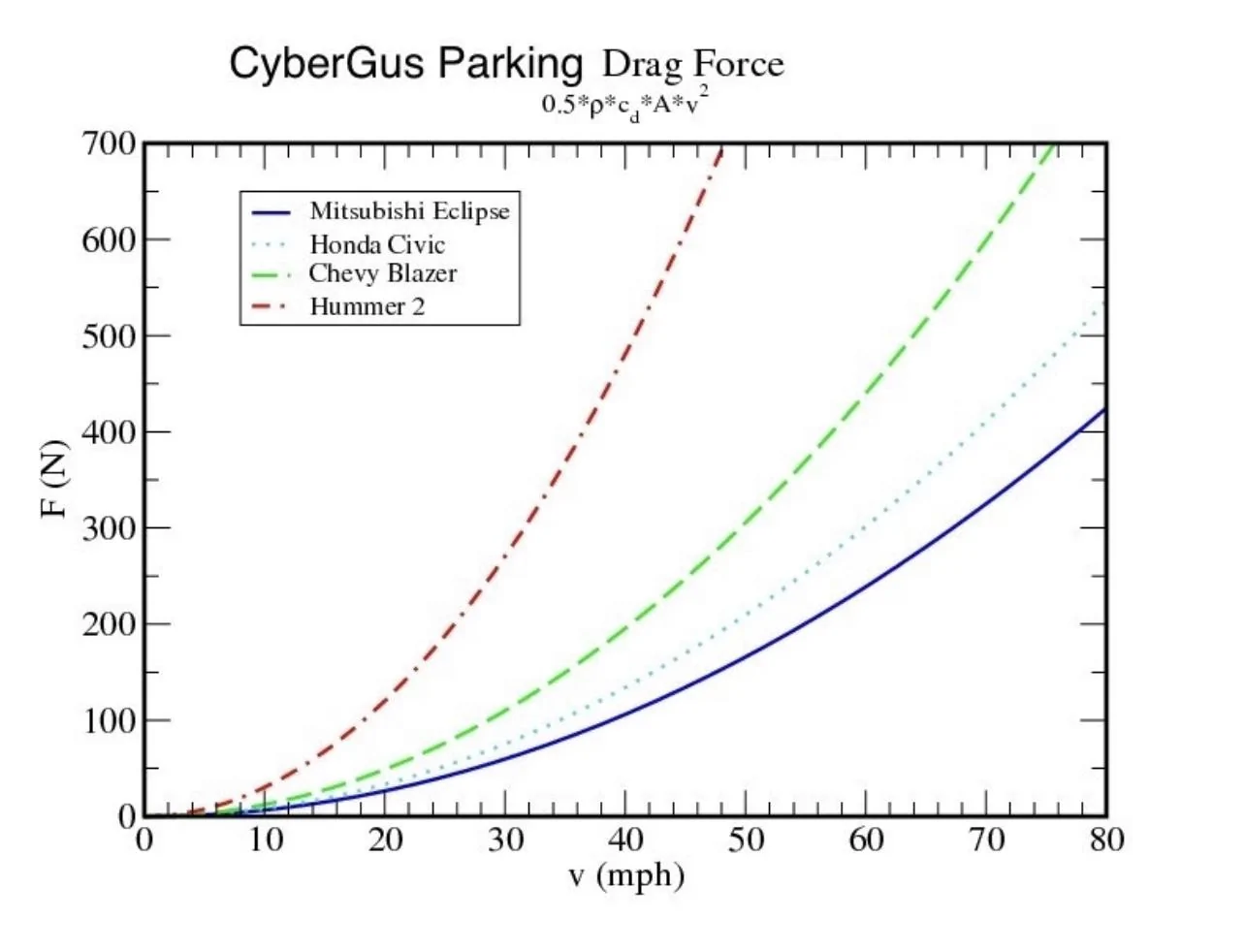

A Model 3/S/X/Y that gets 340mi of range at EPA combined conditions, and a Cybertruck that gets 340mi of range at EPA combined conditions:
(1) all else equal guarantees that the CT will not get the same range at EPA highway conditions, and
(2) as speed increases from those conditions (or temperature/humidity decreases), etc., the CT will get increasingly worse range compared to a Model 3/S/X/Y
Which is why earlier in this thread I mentioned:
The Cybertruck has larger battery than the Model 3 and Model Y, that's why it can match the cars. Also, I'm quite sure that when Tesla was unable to get the 500 miles, they then resorted to the next best thing, to match the range to the #1 selling car in the country. (after all is seems a lot of people are accepting that range)
We are already quite proficient with the coefficient of friction and exponential drag created by speed. You see, there's a Model X that's much bigger and heavier than the Model Y or Model 3 So there' not really any new ground here.
The range is going to be comparable, at the comparable point, which for Teslas is about 60-65 mph constant warm temperature. Just as the Model X gets worse a little quicker, the Cybertruck is going to get a little more worse.
But the range really doesn't mean much. The difference between 60 mph and 75 mph is rarely enough to skip a charging location. And for charging time, let's guess 10 minutes, but since you went 20+ miles further, it's a win!
The Model 3 starts with a coefficent of .208, Model 3 0.23, Model X 0.25 and now the Cybertruck 0.36. And both the Model X and Cybertruck are heavier.
Like you said it is simple math that we've been doing in the other forums well before this one was ever created.
Why did I ask if you had a car ? That's because you seem to be making a big deal that cars are different. Why did I ask about a Tesla? You aren't intimately familiar with the way Tesla does it's range numbers.
And yes, the truck is going to use more energy per mile. I'm guessing that it's going to be around 100 watts per mile more, which equates to about 30% more energy and slightly more time, since the battery charge rate isn't linear.
Remember, you tried to pull the car thing on me first.
7,153
13,769
you’re just repeating more things that demonstrate a certain level of misunderstanding.
at some level, a bat can’t tell a cat what it’s like to ā€œseeā€
It ā€œmatchesā€ the cars at EPA combined conditions.
That doesn’t mean it necessarily ā€œmatchesā€ the cars in other conditions.
that’s not how math/physics works, which is what I’ve been saying twice over - but somehow still not registering with you
If you need to witness this further, just think about what you’re saying when it comes to the eg Model Y vs the Lightning ER - which also both have an ā€œEPA Curveā€ that overlaps at ~320 for the EPA combined.
Here’s a 22 Y LP
Combined: 330mi
City: 342.3
Highway: 315
Notice the Y has a city-to-highway delta band of 27 miles, or 8% of its EPA combined figure.
Here’s a ā€˜22 F150L
Combined: 320mi
City: 350
Highway: 283
The F150L has a city-to-highway delta band of 67miles, or 21% of its EPA Combined figure.
The reasons for that, in the main, aren’t some magical mechanicals of the Tesla vs the Ford. The reasons are frontal plain and drag coefficient as relates to speed.
Your comment about the battery being bigger, having the same EPA combined, all meaning the have the same range across conditions is as misguided as is proven by the Lightning also having a bigger battery and same EPA combined.
I think you’re doing a great job of showing just how much new ground there is
because in addition to there being people who need to get up to speed, you’re additionally the case of people so cock-sure in their misunderstanding they refuse to believe anything but their own misunderstanding
The Model Y has a CD of 0.23. The Model X 0.25. Their frontal planes are nearly identical.
both are significantly different from the CT’s a Cd if 0.34 and frontal plane of a CT
Ultimately, if you haven’t grasped and continue thrashing against the basics noted above, zero utility in running out the maths of an Y vs an X vs a CT
