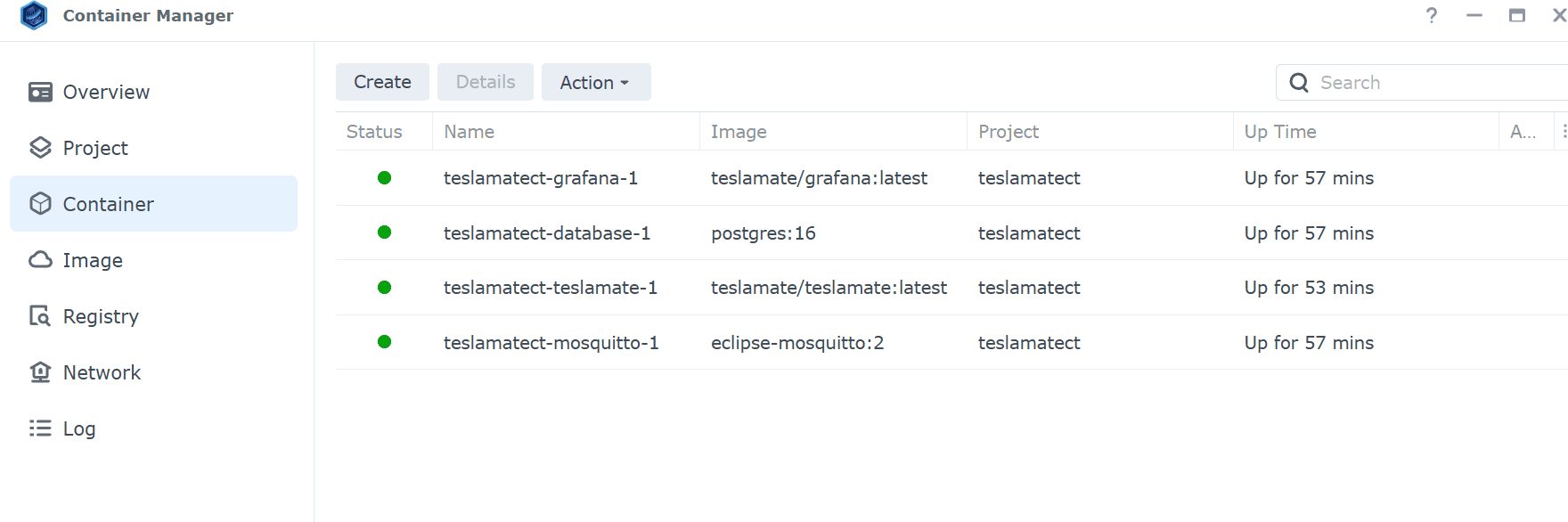

Any guidance on how to remove that old volume? I have deleted and started over a few times and can't find where this is being stored. I am getting the error that the db already exists and it is the wrong version. Would love some help here, as I am so close to finally getting this thing to work. Much appreciated!
alindner
Oct 15, 2024
Somewhere
Model S
sedetweiler
Scott
Nov 27, 2024
Sussex, WI
Well, at least all containers are showing green now, but can't seem to connect to port 4000. Getting " ERR_EMPTY_RESPONSE " Frankly this is further than my efforts using the portainer method had gotten me, so now to buckle up and see where this is going wrong.
Teslamate process logs show "waiting for postgres at database:5432", but the database shows are ready for connections.
