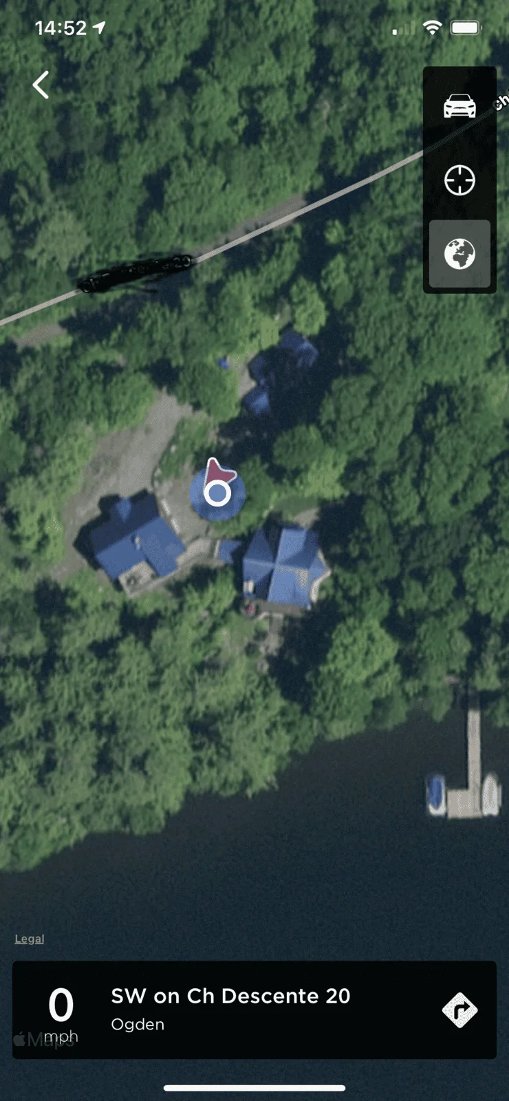

The GPS is not as accurate as you think. It's Federally mandates that the GPS has to be off. It was 300' but it might've been changed to 200' now.
You're not quite up to date. Bill Clinton certainly didn't do much good for the country but there was one exception. By executive order he killed SA (Selective Availability) in May 2000.
The image below shows where the car thinks it is at the moment (arrow) and where my cellphone thinks it is (I was sitting in the car). The symbols represent the actual position of the car an me to within probably better than a meter. I think typical 2drms for a modern GPS/GLONASS receiver under reasonable DOP is probably 5 - 10 m
Tesla Cybertruck Tesla's 700 Mile Battery Is Coming Sooner Than You Think IMG_1400.PNG
Sure 200-300' isn't that far, unless you have to go uphill to a charger.
No idea what you mean by this.
