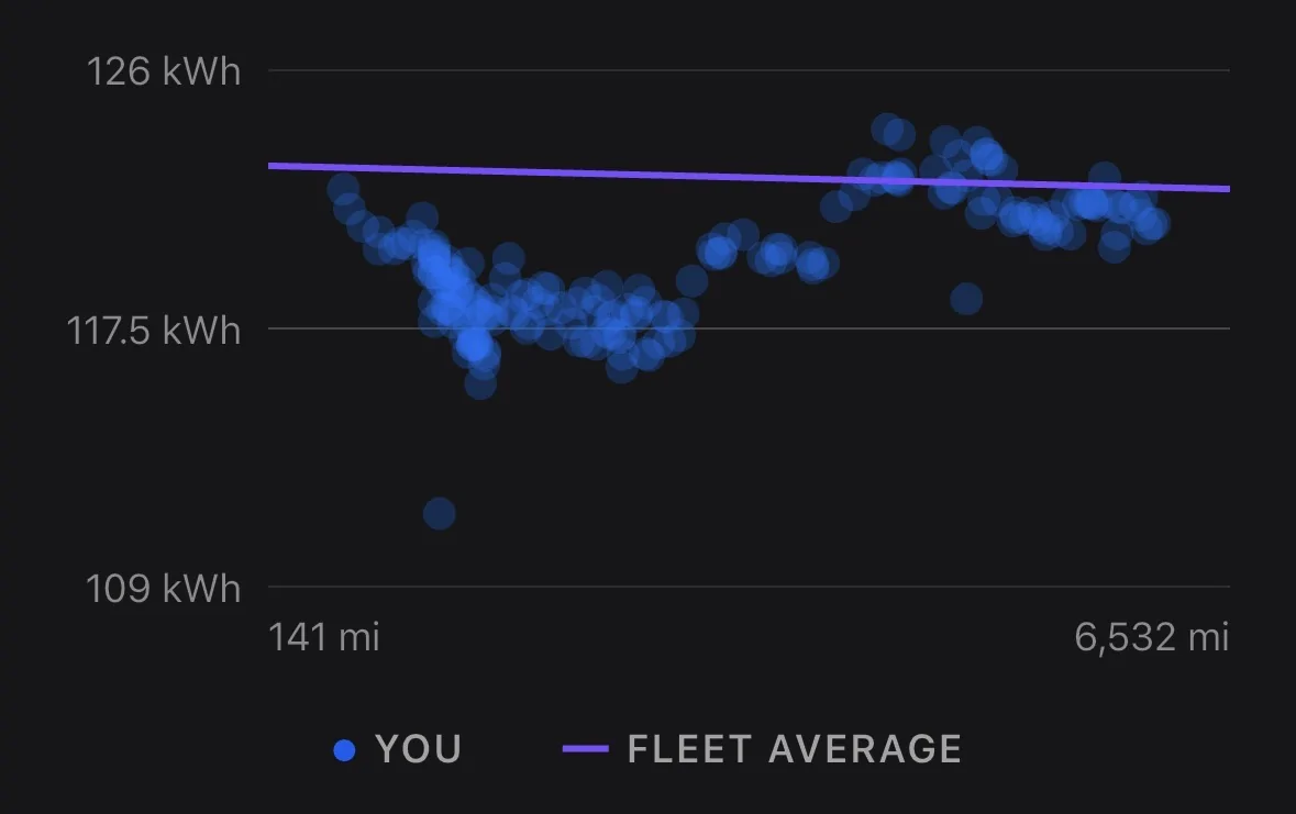

This is my capacity over time:
Tesla Cybertruck Tessie battery health IMG_1829
It was drifting down because I was doing small charges around 50%. The large jump upward was when I took a road trip and charged to 100% overnight.
The BMS cannot make an accurate estimate on the 0-100% capacity without getting close to those values, and will be a little off no matter what tool is used to report it.
Exactly! If the (mostly) full range of the battery is not used, there is no accurate method to determine the actual current state of charge accurately. Tesla uses very accurate methods and software calibrations to measure energy in and out of the battery in order to estimate the current state of charge at all times, but it will drift over longer time periods without having upper and lower calibrations to account for drifting accuracy over time.
If the vehicle has lived a month or more between 50-70% SOC, and then you drive it until it reads zero range left, you will probably have a nice buffer left but there is no guarantee of that because the whole reason for the buffer is to account for the fact that the computer "knows" that it doesn't know what the exact state of charge actually is (it's actually a range). Depending upon which side of that range you are on, there could be fewer than 5 miles of range left. Or, there could be 40 miles of range left.
If your battery has been taken up and down the SOC scale recently, you probably have a nice 20 miles of range left after hitting empty. If the battery has been stagnant in the middle of the range for a month, it's anyone's guess, there is no good way to tell. Of course this only matters if you need to drive past "0 miles of range left". I never need to do that (knock on wood).

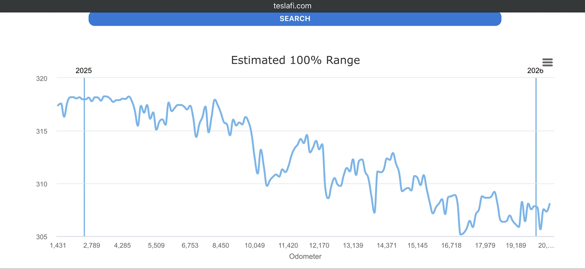

My stats. Charging to 80% when battery hits around 30-20ish %. Few trips, not a lot supercharging.
Is your graph from the Tessie app? What is your odometer reading?
