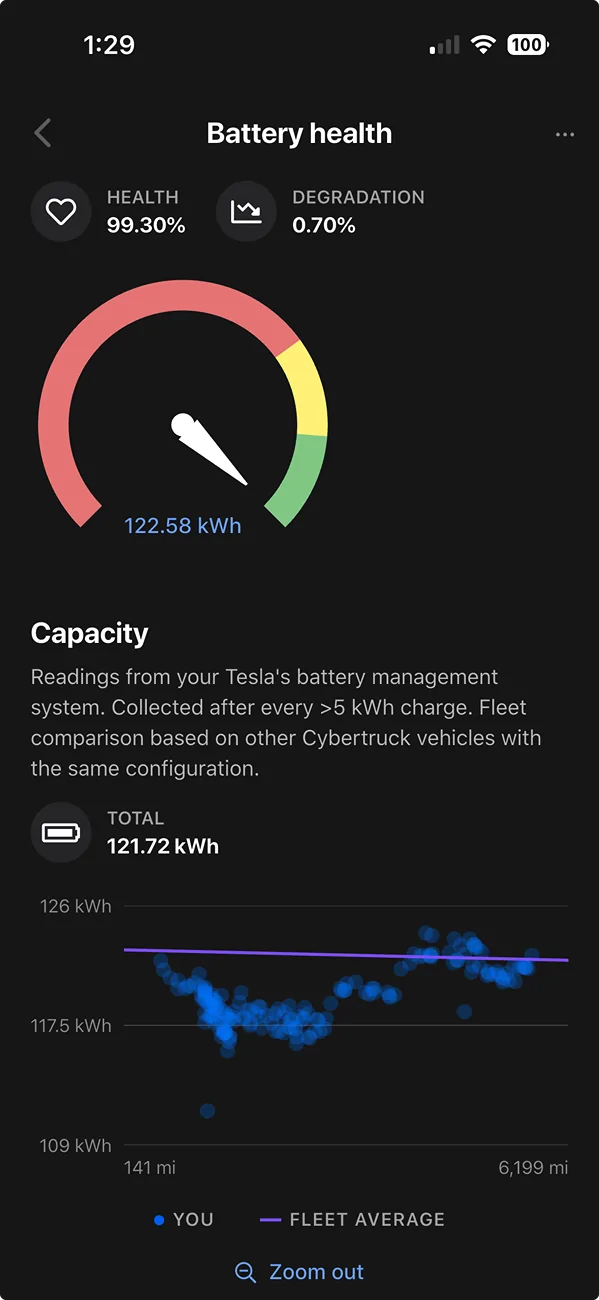

Is there any guidance out there to evaluate battery health and Wh/mile statistics, to see how my numbers compare to others?

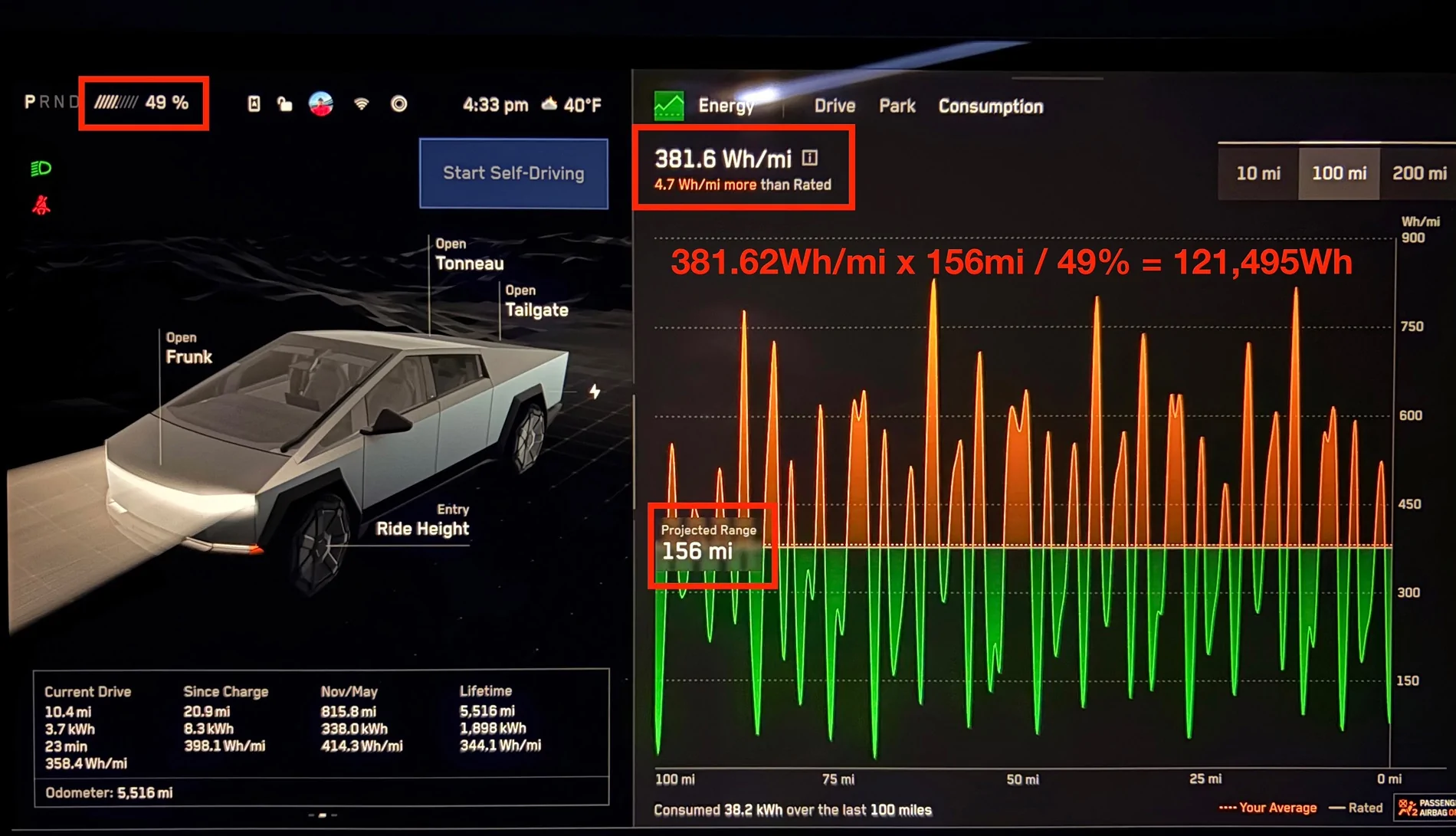

Sure, just go to the Energy screen, then Consumption and do the math. This will give you what the BMS thinks is the current battery size. It's got rounding errors since the SOC %age is rounding to whole units.
