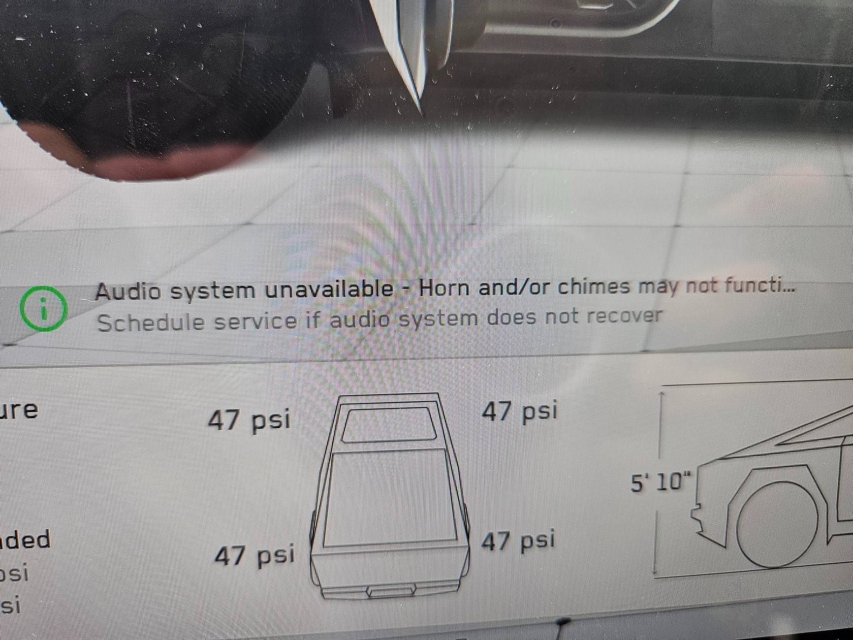

Ok, TesStudio reached out to me (after 3 months of my first email) asking for a video to show how things does not work. I left the cables in the car, so I thought it would be quick, just connect the wires and record it. It turned out that it works flawlessly! It no longer stops working in bright sunlight, no restarts, etc. Even without doing the software update on the mirror. First, I tried it with the mirrors just sitting on the dash, but it even kept working after I screwed it into its place.
I still have the "i" message about the sound system not working (it does), but I can live with that.
Not sure what happened. The only change in the truck was a few software updates on the truck.

I MAY HAVE A SOLUTION...this worked for me. I had the same problem as most of you with my S92 flickering and not seeing the rear camera.
After weeks of back and forth text messages with Tesstudio, they suggested that I lower the brightness in the mirror settings, and HOLY SH#T, it worked!!
I still get the "False" error message about the audio system and horn not working ..but at least the mirror is working...and I know it was the problem because when I turn up the brightness way up, everything starts to flash and flicker.
I hope this helps!:cool:

I tried it: my brightness was already pretty low (3/10 or something) and it rarely flickered. I moved up and it started flickering. I set it now to the lowest and will see. The brightness is actually pretty good on the lowest setting, too. Thanks for the tip.
