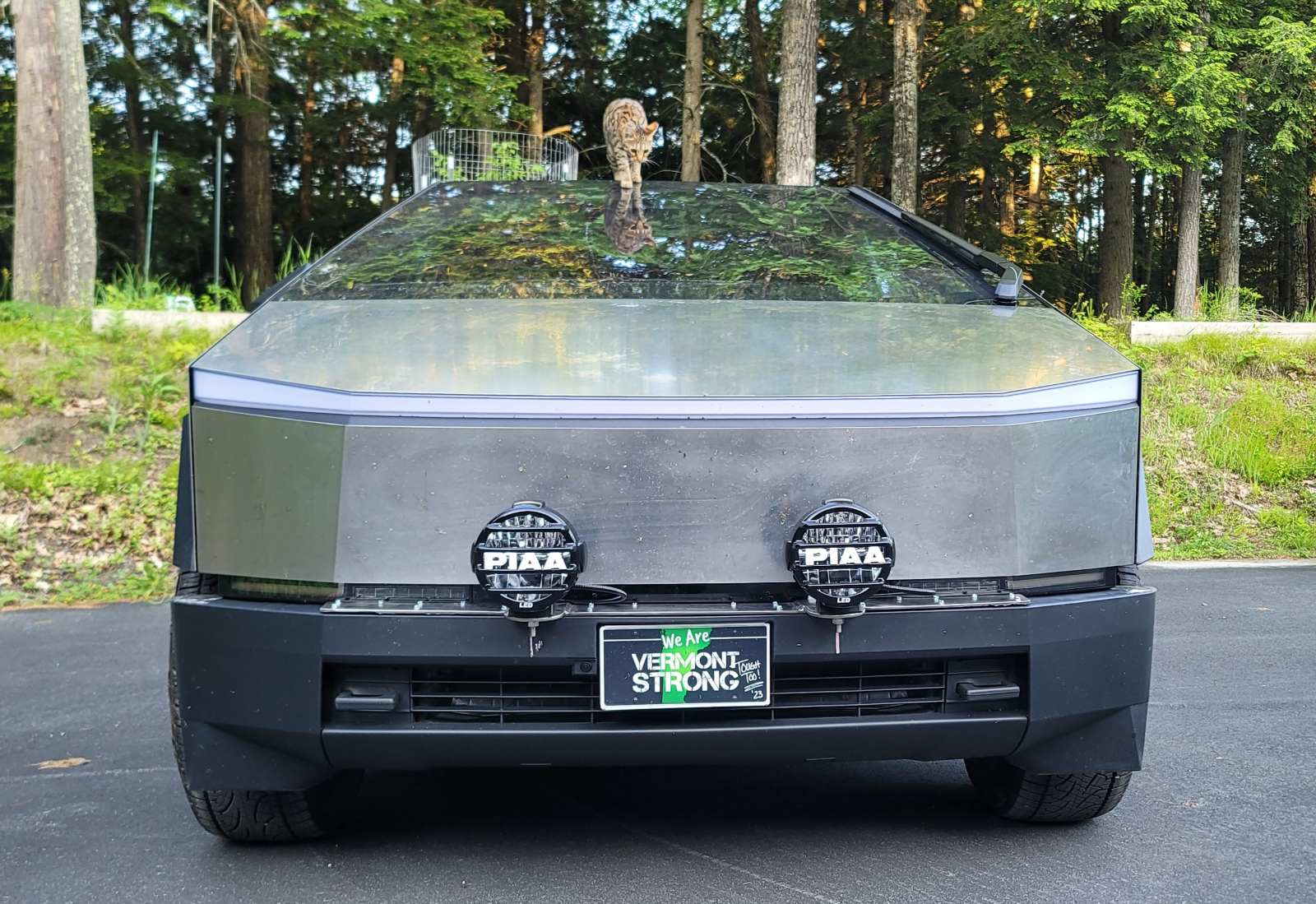

As promised, the best light for snow, fog and rain for just a few hundred dollars.

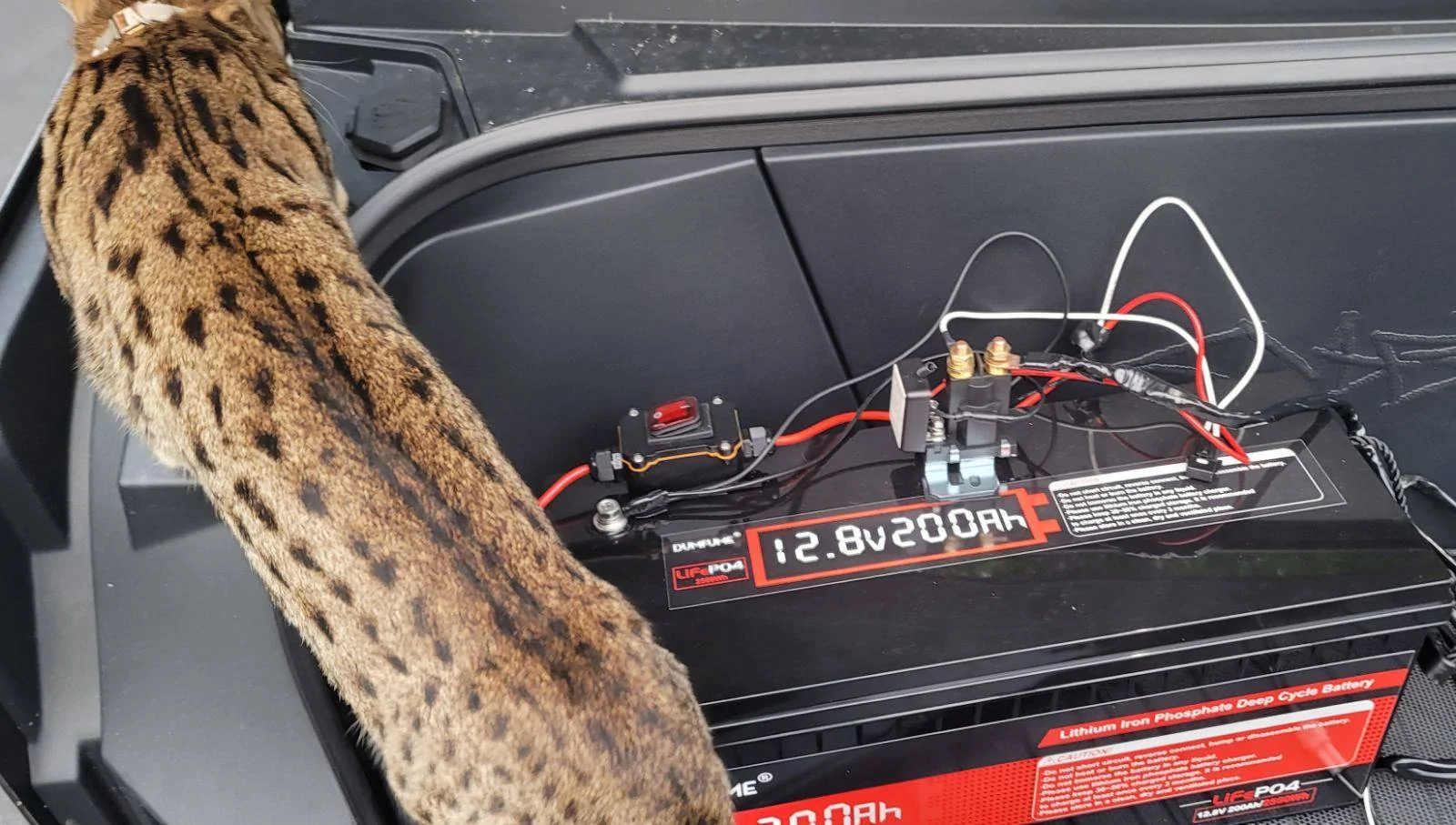

The headlights work for 60 hours on one charge. The electrical circuit of the axillary headlights is not connected to the electrical circuit of the CT and is charged individually.
12V 200Ah LiFePO4 cost $254.65, works GREAT!!!

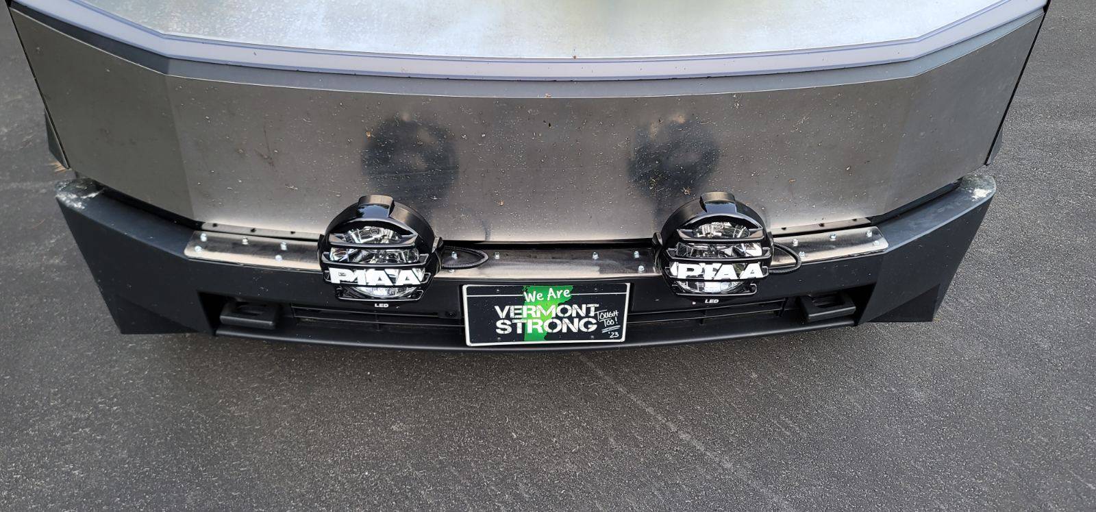

I thought about throwing out the factory bumper and installing a police one (Westin), but, unfortunately, this year the police bumper will not be on sale yet. Therefore, I temporarily installed these headlights at the factory. The original light is completely useless in fog, rain, snow.

This is a Long Range Driving Beam 7-3/16” light , 18-watt every light.
Despite the small power output, they work better than the origina CT light thanks to the large reflectors.
Thanks to low beam, they also work well as fog lights and do not blind oncoming drivers.
The headlights remove and install within 2 minutes.
I bought similar 120-watt headlights for traveling on Vermont night roads in condition of extreme limited visibility.

T-Sportline is a Great Company.
I especially like T-Sportline prices on batteries for CT auxiliary light.
Well, I'm not an electrician, not an engineer, and not a mechanic, but a professor of medicine, and try to do Common Sense on everything.
The 48V battery is responsible for steering of the CT, and in case of front end damage, or any other short circuit, can cause the CT to become uncontrollable.
In my case, these two electrical circuits are not combined, and in case of collision, only the fuse on the light battery will blow out, and the car control will not change.

I should also note that there are devices designed for lithium iron phosphate batteries that allow you to pull 13.8 volts exactly while also charging the battery with the appropriate (higher voltage) charger...or solar array, etc. That would allow you to maintain a full charge when driving.
For that matter, a buck converter on the 48 Volt supply would give you the voltage and current you need, without any concerns. And you could switch it from the screen and eliminate the battery entirely.
