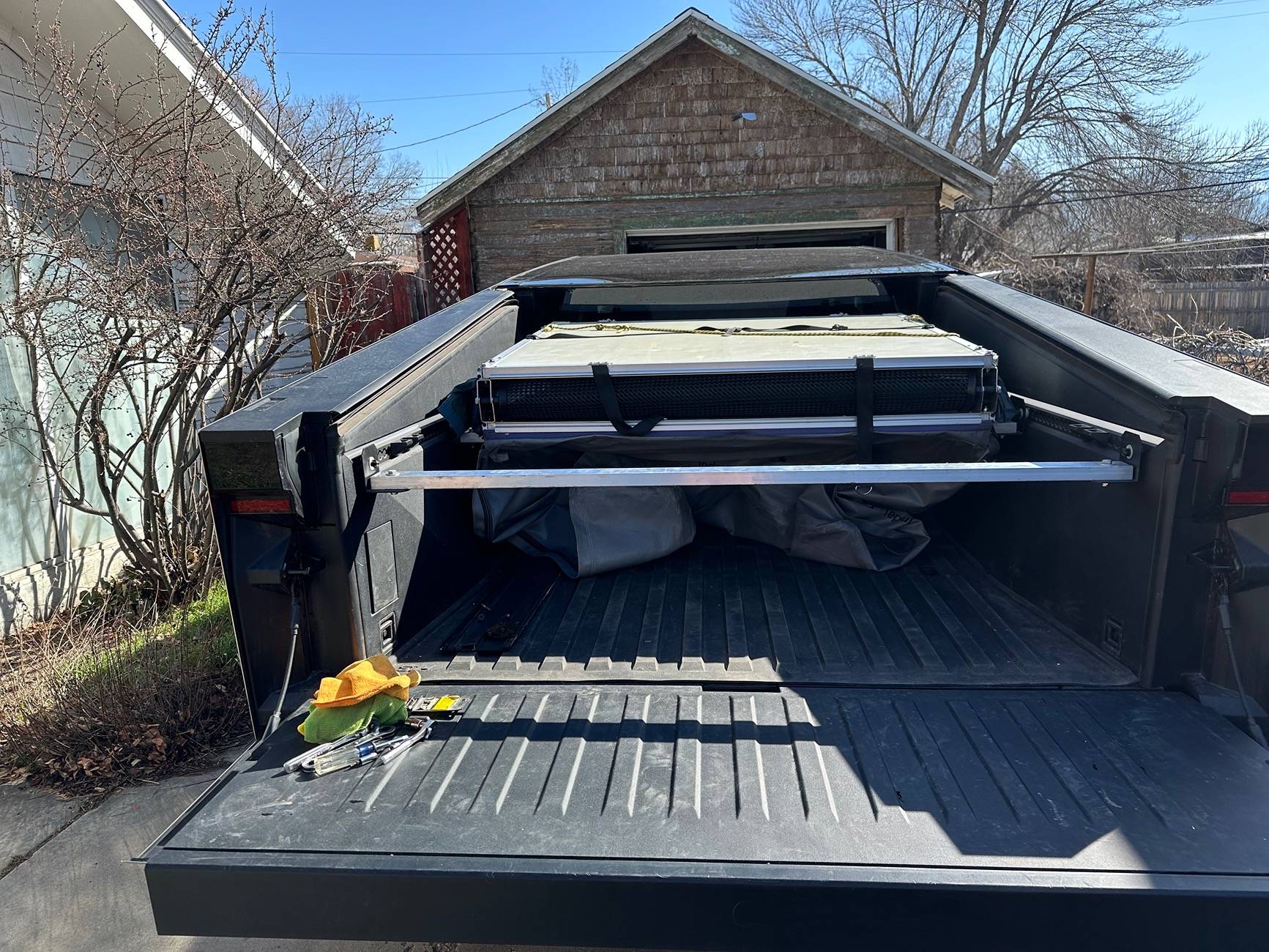

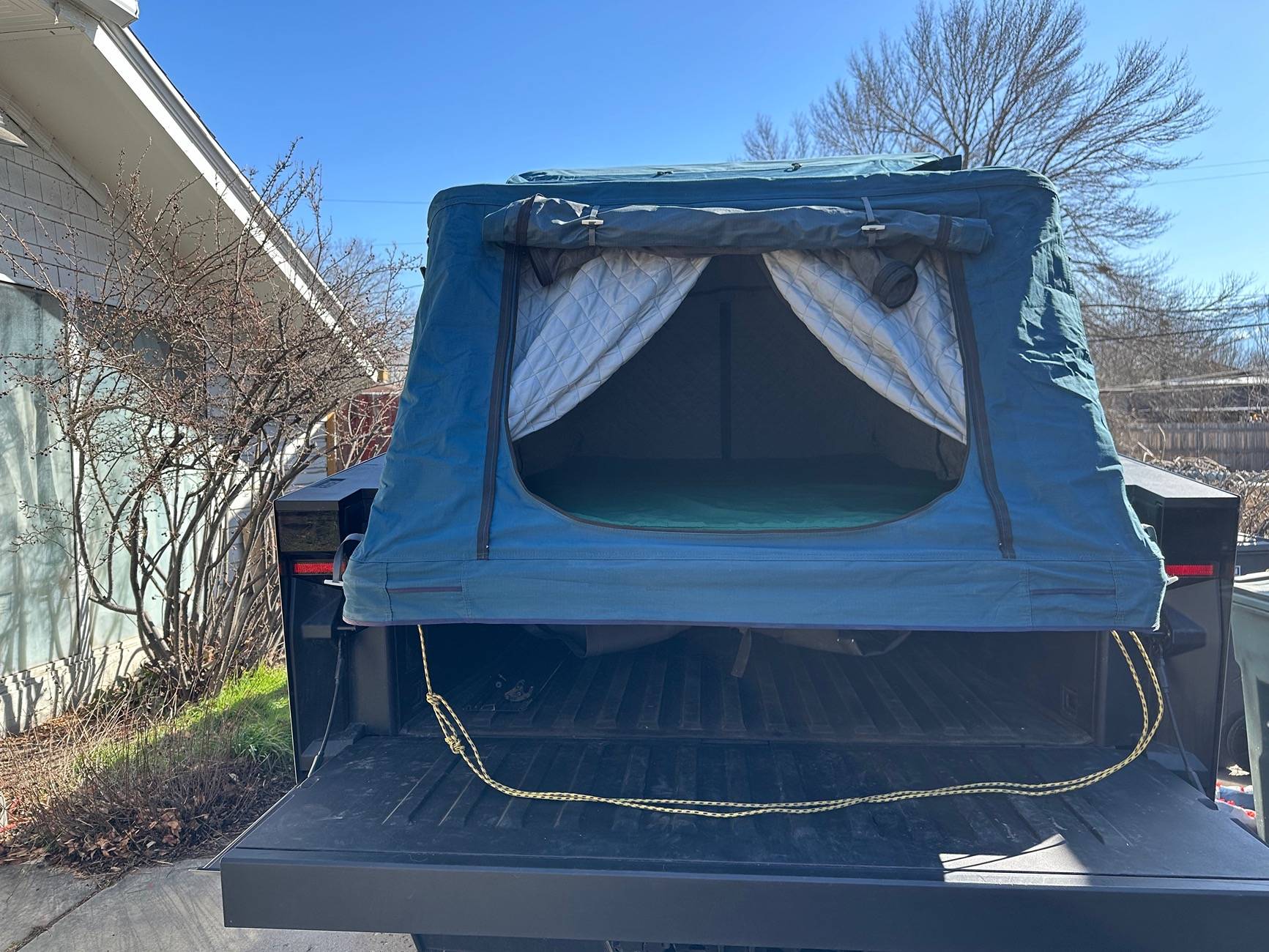

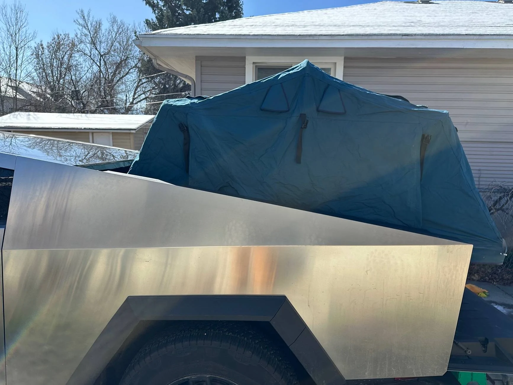

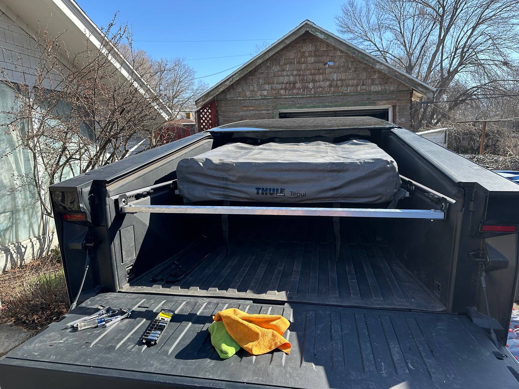

All in it was about 1k.
To each their own. You do you. I didn’t do it for money, but once I was building it it is fun to try to build it cheap for sure. My tent is overall much faster and less fuss. Cross bars come out in the time it takes to loosen the bolts on the L- track and brackets. I use a drill. What? 5 minutes maybe. Hardly permanent. The Aeroflap, silnylon, and elaborate time consuming setup and takedown of the CTent is a no go for me. I can deploy my tent once mounted in the bed in less than a minute. Same to fold it up and stow it. Speed at the campsite is my important metric. CTent is lighter. 70 pounds to 95.
Once someone makes a hard sided topper like hiatus https://hiatuscampers.com/ or a similar top for the Cybertruckco/Urander rack(s) then that wins. Until then, a tent is a tent is a tent. The Thule is 260g poly-cotton blend, reinforced with 600D ripstop polyester. Oxford Cloth. With a separate 420D silnylon rain fly. The CTent is 420D silnylon. My tent has a winter quilted liner as well. True four season tent. I already used it in 13 degree F conditions with a simple under desk panel heater. Slept with a light Patagonia Nano-Puff blanket. I was too warm and had to turn down the heater. Also in 98 degree temps with my little bouge rv ac. Dark, cool, and cozy. I like to sleep in. A silnylon tent simply won’t perform like that. Silnylon is hot in summer and cold in winter.
If I were going current RTT on a rack I would go FreeSpiritRecreation Explorer XL—or other FSR RTT. Excited to see the new Urander tent with removable floor, but FSR uses quilted wall material. To me quilting is absolutely necessary without the best option of a hard side. Hopefully the Urander tent will have a quilted liner. If it were hard sided I would buy it day one.
FWIW - I just sold my Gen1 Urander Bed Rack .
Didn’t care foe the wind noise and Range Hit.
I’m going to experiment with your idea and some 8020 extrusion on drop brackets tied into the L Track. The Front Runner RTT looks like the best current production RTT as a candidate.
