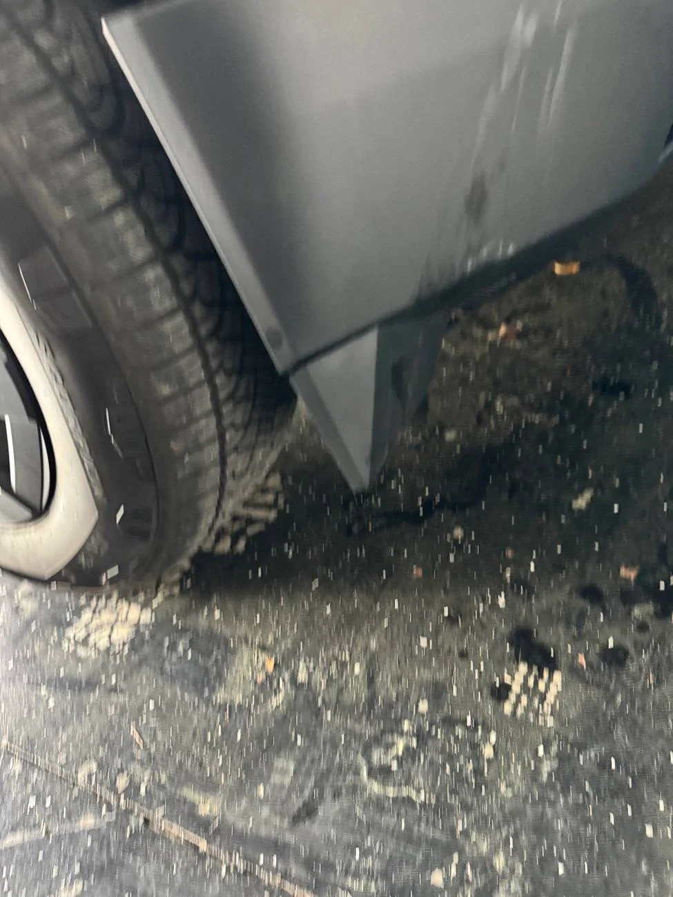

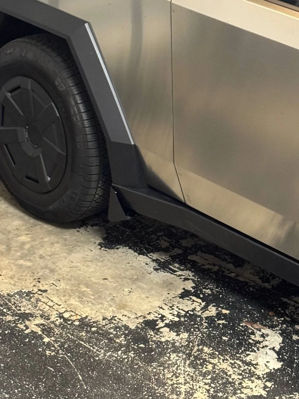

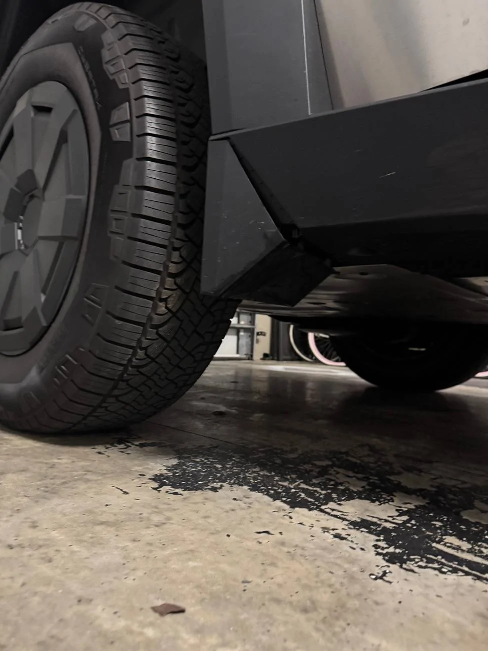

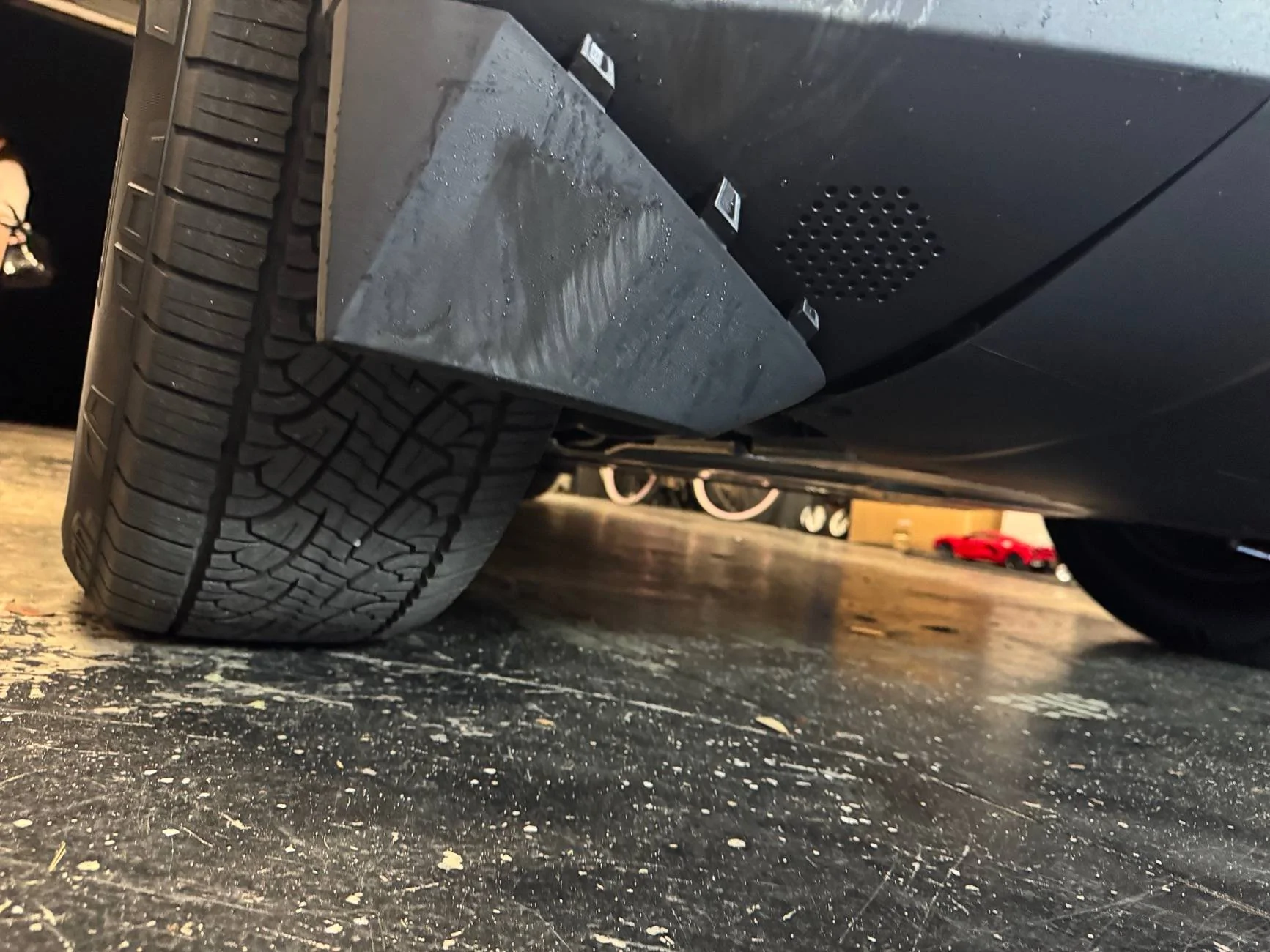

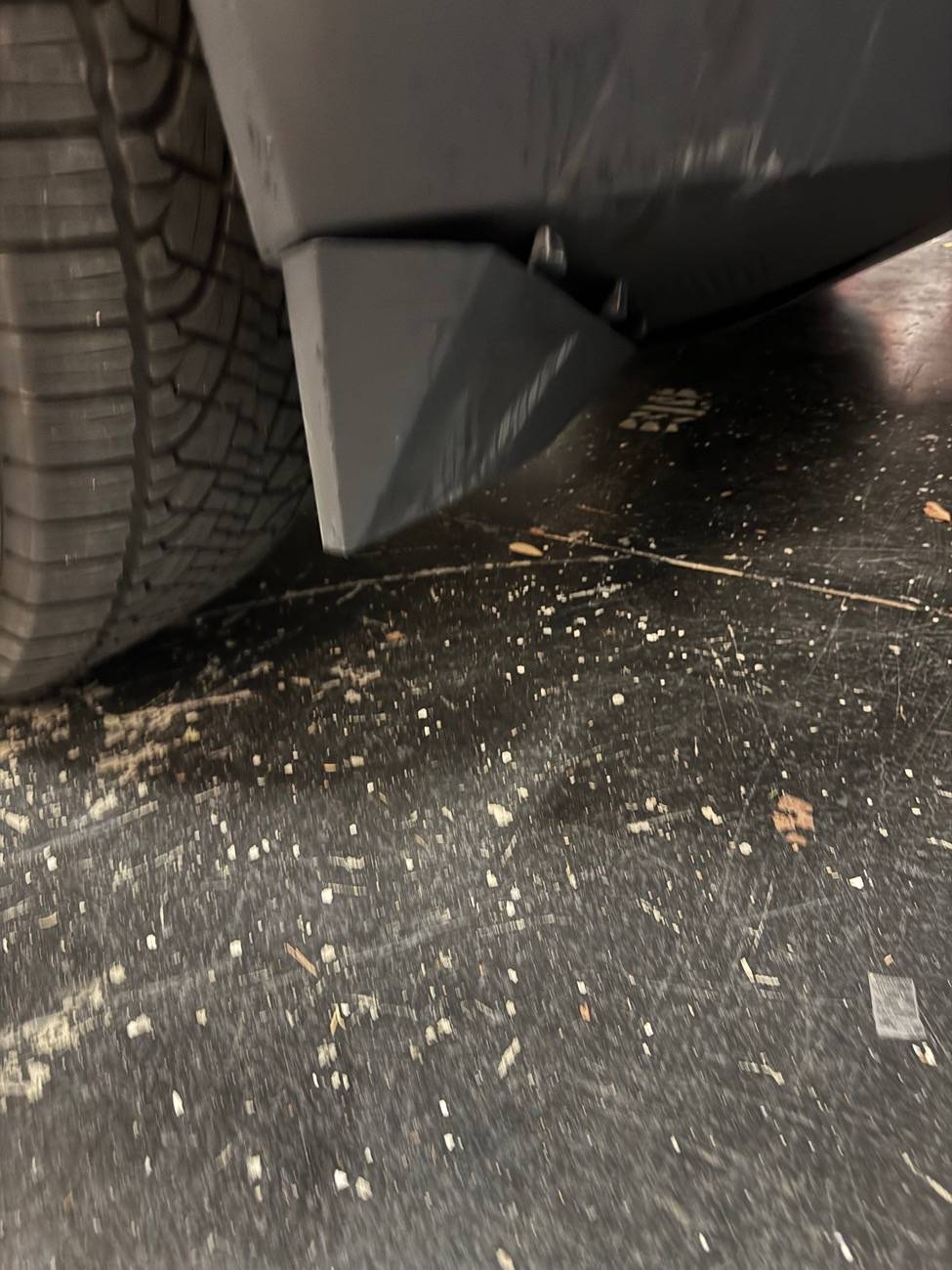

Anybody with any thoughts on how to fix this …a tire on the highway came off a trailer and ran right into right side of CT. Made insurance claim then realized it’s all plastic underneath , with push pins that came off and trying to do myself … see damage below
any thought greatly appreciated and maybe on cost the of r wheel fairing?? that came offf and the underside plastic center piece it connects to , don’t know the name of it, but plastic portion that clips into place along plastic center undercarriage also broke off….that connects to R wheel fairings ..damaged
I was able to get new push pins and hold these pieces up in place so cosmetically looks better but still has some damage? Any thoughts greatly appreciated
Below is the damage before and after I attempted to fix it ..looks cosmetically better but some bolts came off on the wheel fairing and center plastic part ( I don’t know the name ) but it’s All plastic , thoughts on how to fix this the fix I did cosmetically looks better but very loose , thoughts and recs appreciated
last 2 pics are after I tried to fix it my self thanks guys any thoughts appreciated
below are also the pics after I used push pins to push it but it’s not holding like original

Just posted the befor efix the after fix looks back to normal but the wheel fairings are loose because a bold was broken also center undercarriage that connects to fairings got busted but this finished product cosmetically looks good . Thank You!
