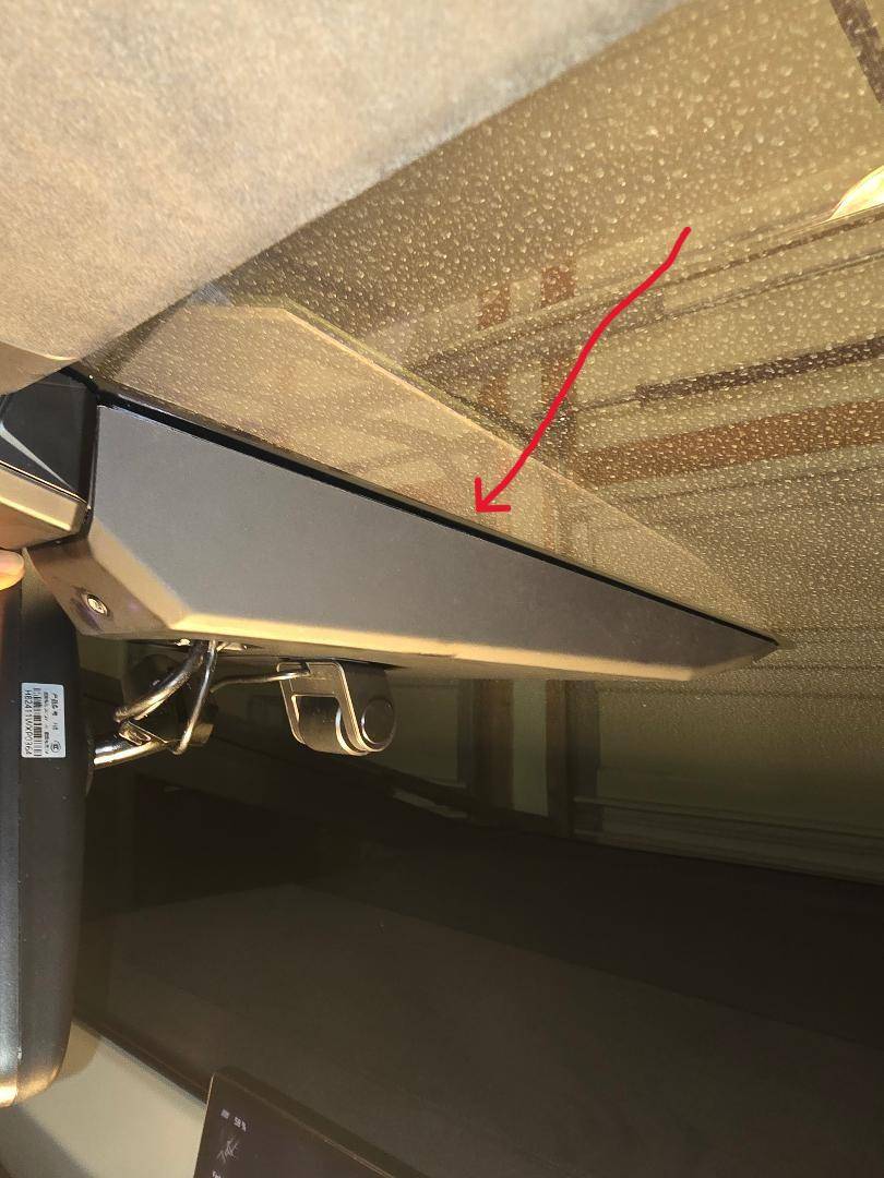

Tesla's service department did not install the light bar, claiming that the third-party rearview mirror camera was too heavy, causing the components under the triangle area housing the FSD cameras and other components to separate from the windshield. The only fix is to replace the windshield.
Tesla service claims that the weight of the rearview mirror camera has pulled the area housing the FSD cameras away from the windshield so much that it has caused the front FSD camera to lose calibration. The service department claims the only fix is to replace the entire windshield, as the laminated area separated from the windshield cannot be repaired. The Tesla service department suggests that I not re-install the camera once the windshield is replaced at my own expense (because it is a third-party installation ). I’m calling it bull that the camera's weight is so heavy that it has pulled the laminate off the window, causing the issue with the FSD cameras.

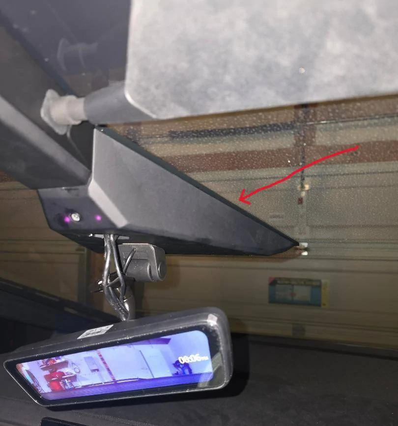

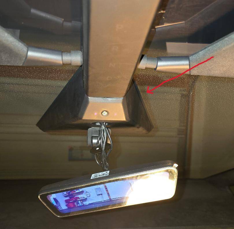

They claim that the components under the triangle plastic area have pulled away from the windshield due to the weight of the third-party mirror, causing the FSD cameras to fail calibration. They gave me the truck back with the rearview mirror camera hanging by its wires. According to them, the windshield would have to be replaced anyway.
Red arrows point to the area they say is separating from the windshield... due to the weight of the rearview mirror camera.

Did you put the camera back or remove it? This post had my second guessing my rear view mirror camera installation, but, there is no way that little bit of extra weight should cause anything to pull loose like that. If it does, Tesla needs to reevaluate their installation.
I put the camera back after first removing it to evaluate the service techs claim. Everything was tight, sturdy, solid! I put the rearview mirror camera back in place and calibrated the cameras via the service menu. Everything is operating fine, like it all never happened. The service tech did not need to and should not have removed the rearview mirror camera.

There was no damage caused by my installation. That's the point. The tech was mistaken. There was no cameras sagging or loose lamination. He simply saw an error on or around the time period that I installed the camera and assumed all the rest. All the truck needed was a camera calibration. There was no need for him to touch that rearview mirror camera, let alone remove it. I believe he experienced how hard it was to get that screw back in and decided he'd better get a waiver.

You'd have to be seriously dumb to believe a 3 lb camera is gonna delaminate glass that has been autoclaved to 200+ degrees and put together under hundreds of PSI of pressure.

I was thinking the black beauty border on the windshield or the bracket bonded to it detached, not the two panes of glass.
Sort of like the old school rear defroster terminals.

That whole front electronic section is glued and snapped together very weakly. The PRNDL box feels like it's held together with bubblegum. Mine literally fell down and was dangling several times, after several service visits it still feels like it's not on there correctly.

the front overhead console (gear tunnel) is due to the clips, not the glue

Wasn't there a service by bulletin for the camera housing falling by itself?it was all over the forums a few months ago.
