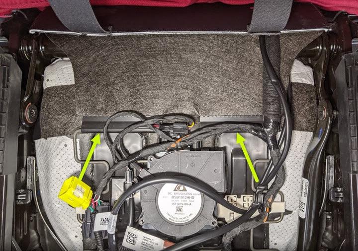

The seats have their own ventilation fan. It might be worth peeking underneath to ensure the electrical connector is secure. You might be able to feel the ran running...?
I looked under both seats. I could feel leaking out around the fan on both seats. I’m not sure if it’s supposed to be air tight down there or not.
Heating up already this year, did you ever get your ventilated seats cooling fairly well.
