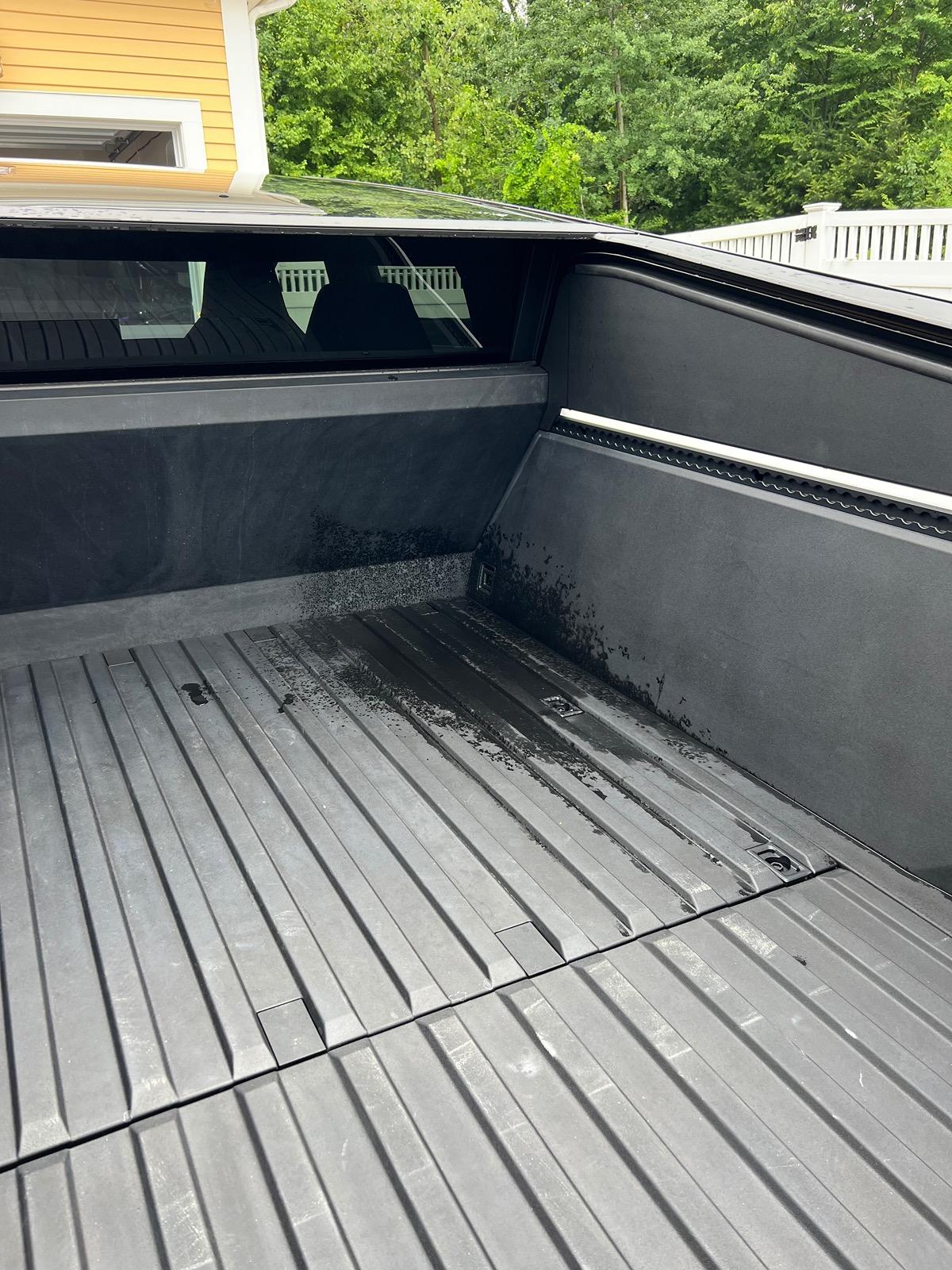

After heavy rain and washing there is some water in the bed. Not sure where it’s coming from.

Same spot as both my CT’s. Guaranteed they didn’t run a continuous piece of foam tape. Like they ran out 3/4 of the way and started with a new roll. Unacceptable. I took mine apart and used a better quality single sided foam tape. Then I added the same tape to the underside of the tonneau cover cap at the bottom, farthest away from the roof. 100 times better quality seal and I have Zero leaks now. The tape is 1/2” x 1/2”. The tape just barely touches the cover as it rolls and unrolls. My cover seams to have a flat spot at the top, so if you were parked on an angle the water would find its way between the cap and the rolling cover.

Can you link to the tape you used? What do you mean by “took it apart”? Any more clarity on the fix would be much appreciated. Need this to be waterproof! That’s the whole point. I haven’t spent much time but the wet area is strange in that it’s only the bottom. Ie. There isn’t a long drip coming down the side.

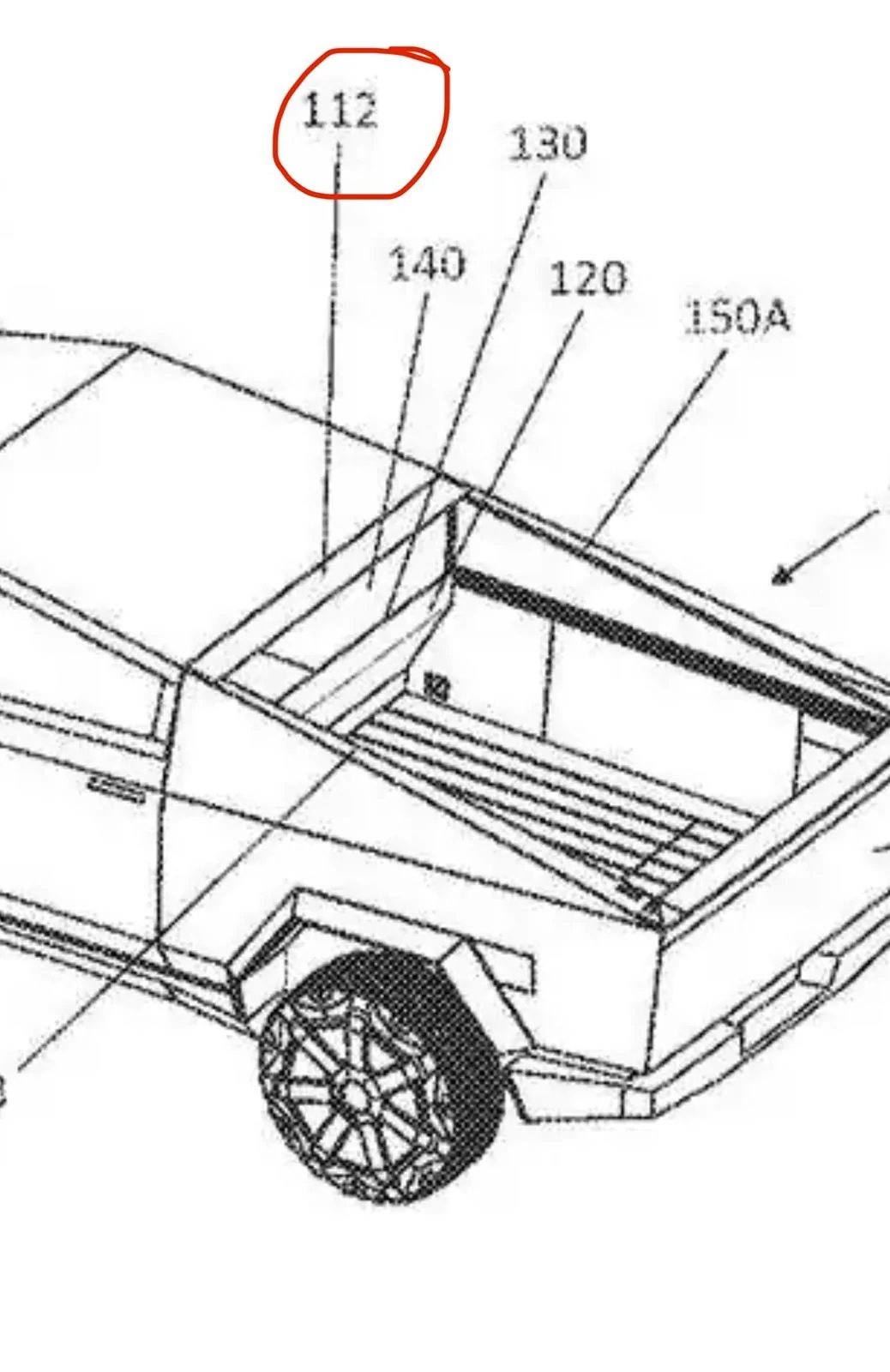

There is a small lip at the edge of the tonneau cover cap. Lay in the bed face up with your head towards the back seats. Run the foam tape along that edge. The cap has a slight angle and every tonneau cover has different gaps, so moving the tape either towards the tailgate or towards the back window will give you different reveals and tightness to the tonneau cover. Mine had a small gap so the tape was pushed more to the back window side. The other had a larger gap, so the tape was more towards the tailgate. The tape should brush the tonneau cover as it is closed and opened.
Tesla Cybertruck Water in truck bed after heavy rain or washing IMG_0822
Part #112 is the cap in the picture.

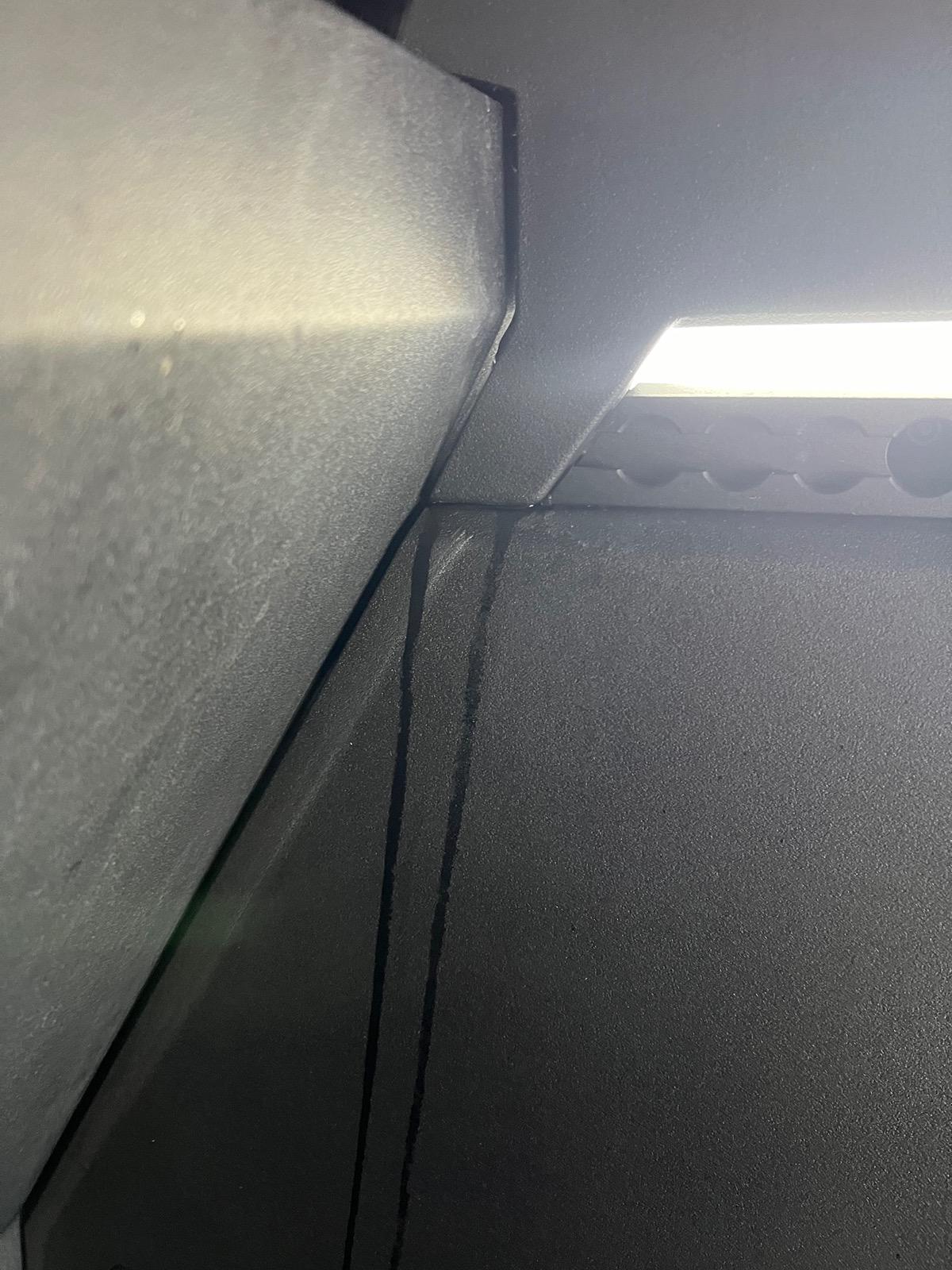

In addition to some dripping from the top of the cover, which I think weather stripping should solve…I think the majority of the water comes from the picture below. Same story on both sides. Seems the top corner opening of the cover allows water to find its way inside. This one may be a tougher fix. Thoughts?

This is if you have water coming in from the gap between the cover and the cap. The other problem is if you have water coming in from the back of the window towards the top of the cap. That is when you have to take things apart. This is the most common. To check……….. put a towel on the cap with the seam open., pour a cup of water along glass seam and tonneau cap then look inside.
Geez……….. That’s one I haven’t seen. I think alot of the problems are coming from the transition from bottom of roof glass and tonneau cover cap. I think I’m just gonna tear mine apart tomorrow and take some pics. A little Father’s Day’s alone time.
