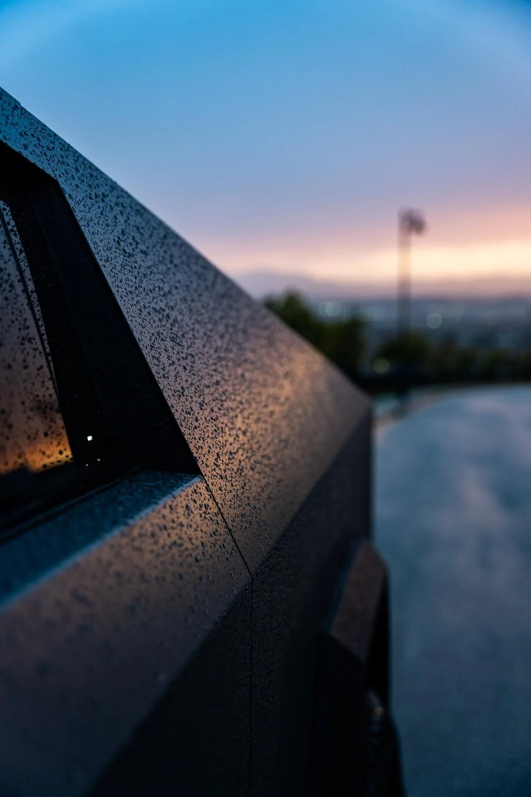

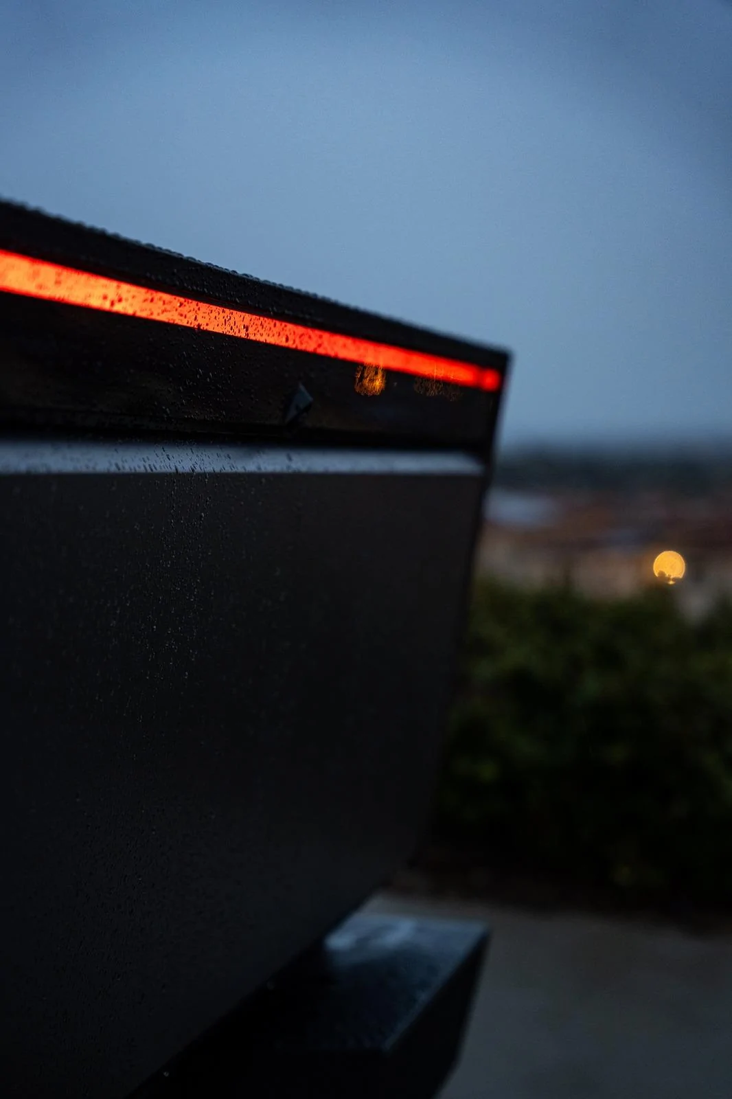

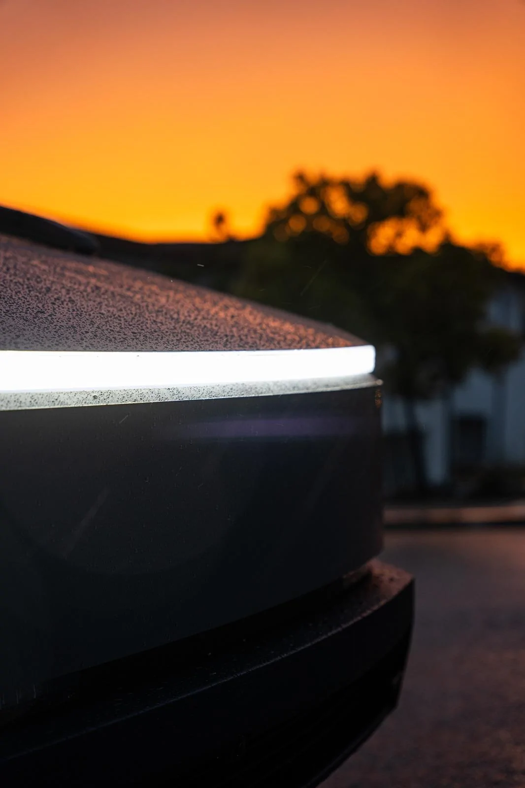

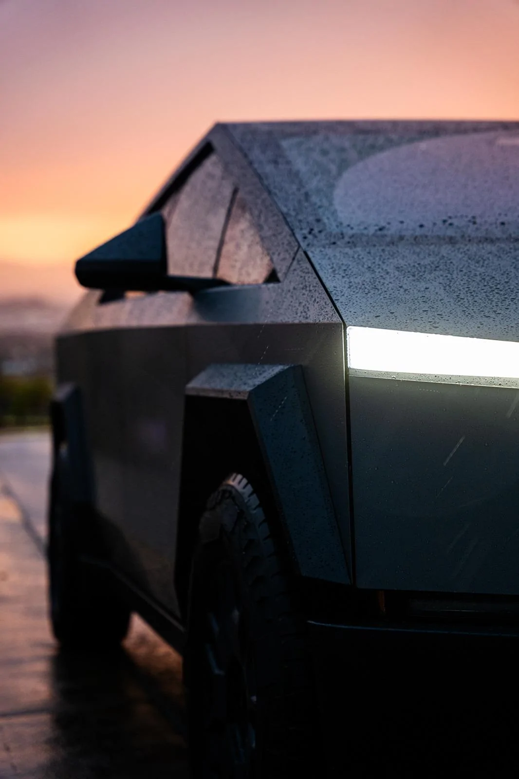

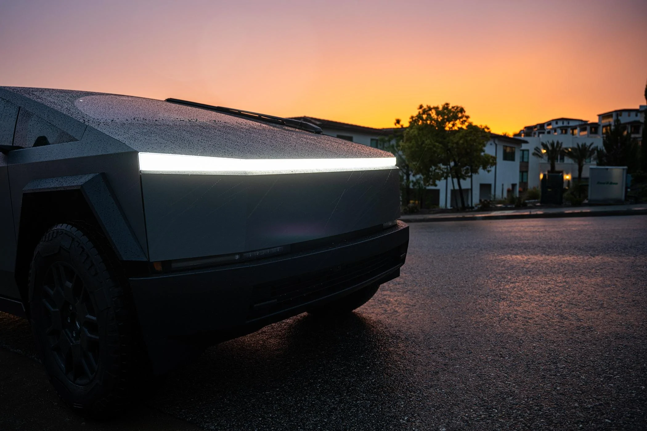

I got these cool pics thanks to the rain though:
