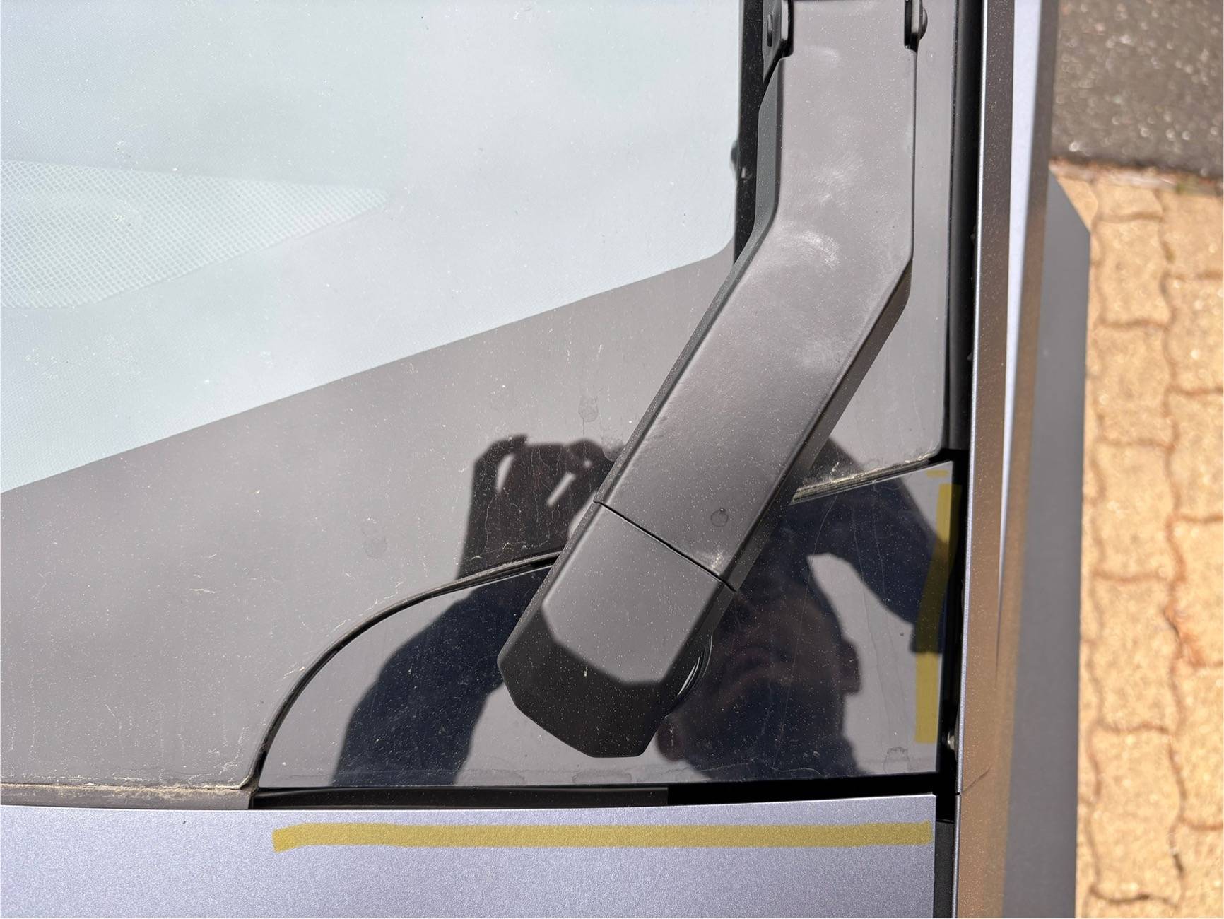

I had service on my wiper several months ago but just now noticed around the wiper unit there was no rubber seals. I don’t recall if it was there before the service.
can someone confirm if they have rubber seals around the highlight yellow area? Notice rubber ends right at the wiper unit.

ok - so the bottom seal came off somehow when I was working on the frunk .. and I can't figure out how it goes back on correctly? there isn't much of a groove in the rubber seal to slide it on the plastic ... and it is different than the other long seal over the rest of the frunk ... anybody know how to attach?

It's just attached with adhesive. Use a rubber cement to reattach it, unless you don't care and are lazy like me then you can just use super glue ?

I was wondering if it was adhesive, thanks. I saw *some* sticky residue, but not a lot so wasn't sure. But it also seems if you have the frunk go as high as it can, that the frunk arm will hit the seal (and over time it will then dislodge)... at least on my truck...
