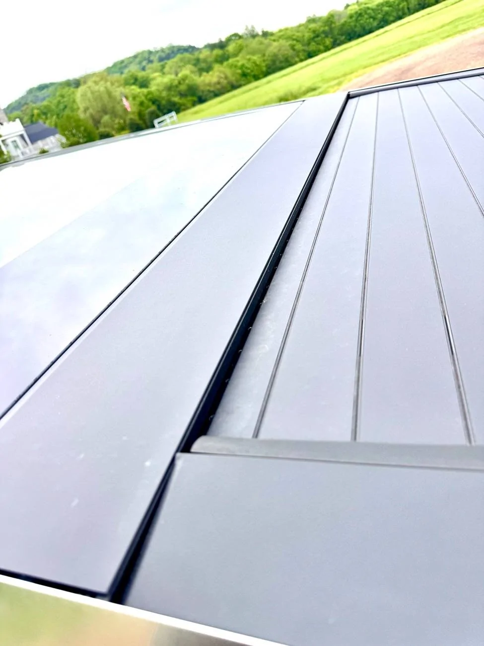

Here’s my holes, since you showed me yours. (And, yes I’m sure it’s in another thread but this thread is sooo much cooler so please don’t grump on us.) I’d love to see someone without holes.

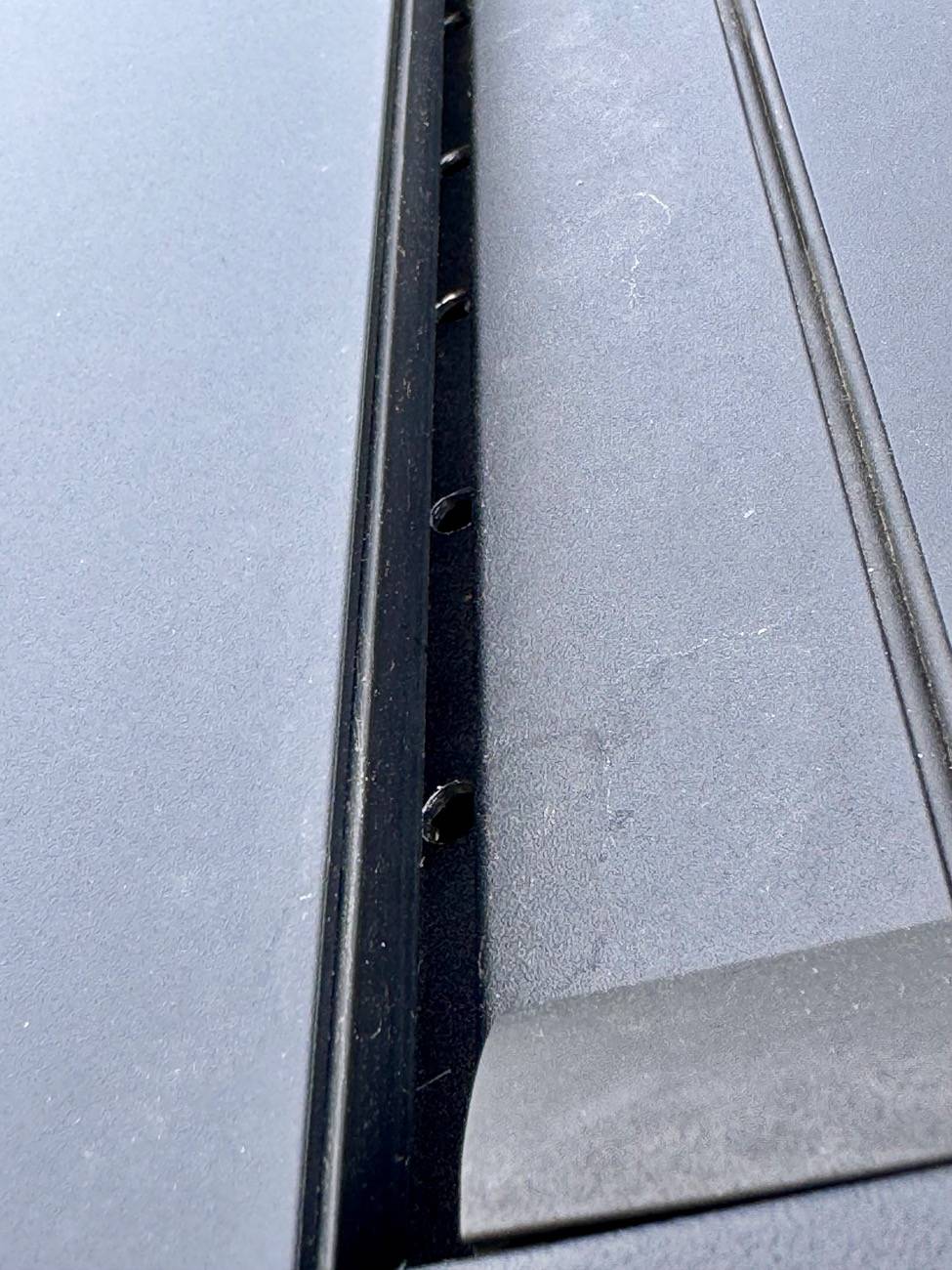

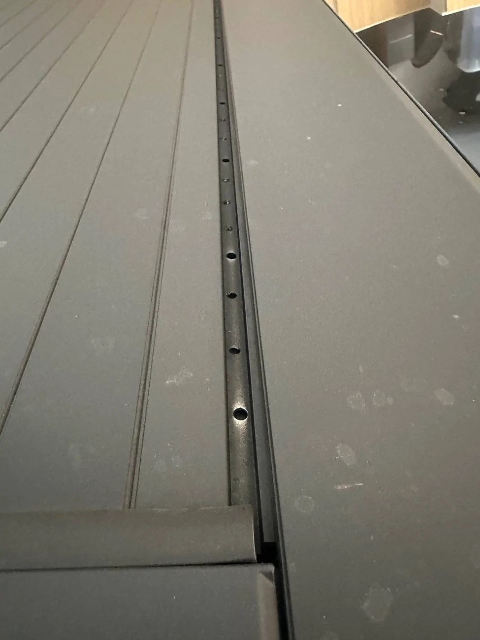

Noticed these holes between bed cover and body. Does all the trucks have this?
Truck is a 2024 model Dual.
Those holes are there to let a bunch of water into your vault.
Should submit a service ticket as you are missing a tonneau slat, likely a sub 35k VIN #
Holes aren’t straight through. Mine are very prominent and water doesn’t get into the vault after Tesla replaced the seal between the roof glass and appliqué. 44k VIN. IIRC, up to low 50k VINs are also affected.
