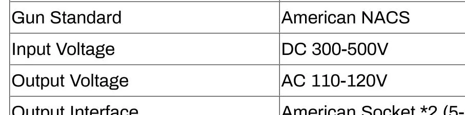

Fair point. How is this overcome with all those aftermarket v2l devices? I would have thought those would produce similar faults
Which devices?
The Powershare V2L uses the charge port and onboard inverter
Others take HVDC from the vehicle and have a separate inverter
You can build your own fast charger that uses batteries, but it won't charge while driving

It’s pretty interesting they are able to get DC output from the charge port like that.
