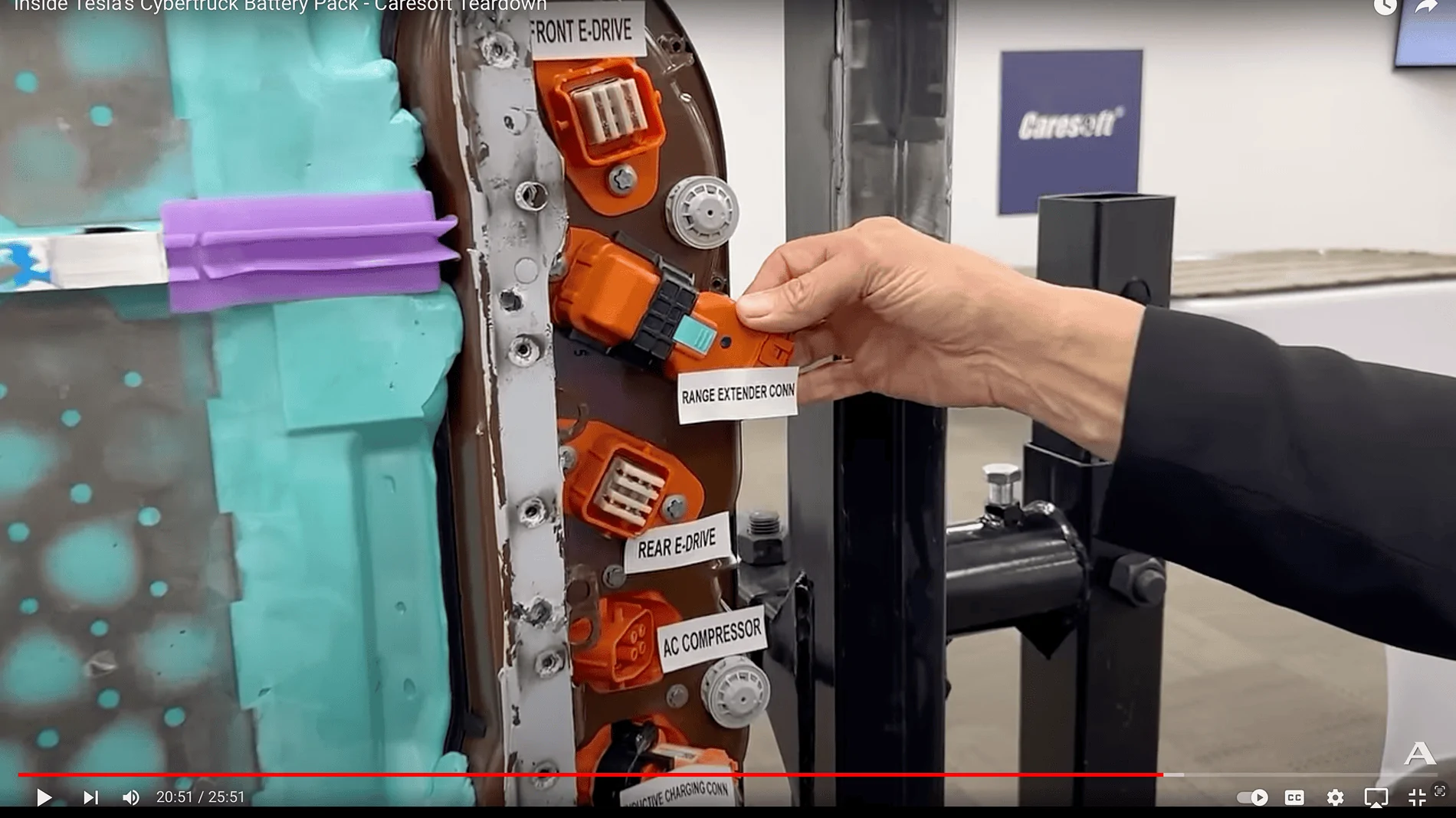

As far as I can tell from the service manual, there are no existing connectors for it to plug into. It may require a different penthouse or get placed inline with existing connections.
Regardless of connection, the vehicle software would not play nice with an unknown pack. Even if you could get matching chemistry and series cell count.
This could be it and/or a connector for inductive charging:
Tesla Cybertruck Range Extender Alternatives Tesla connector
Yeah, I originally though that might be for extender, but the size and service manual call out for inductive charging (along with the photo only showing two pins populated) changed my mind.
@Beyond found the same answer I did, while watching Inside Tesla's Cybertruck Battery Pack - Caresoft Teardown (minute 20:50):
Tesla Cybertruck Range Extender Alternatives Screenshot 2024-07-22 at 8.48.25 PM
@prizla, I think what you want is something that can plug directly into the "Range extender conn" and mimic the official extended range battery?
I went down a Cybertruck teardown rabbit hole a few weeks ago and learned that the official extended range battery is a "smart" battery, mostly for thermal management. It mostly likely will be connected to the Cybertruck's heatpump as well.
Out of curiosity I checked out the Cybertruck service manual and it does not mention how to connect external batteries to the range extender. It doesn't even describe the regeneraive braking system, which might be another option for charging the main battery while driving.
Anyway, I think your best option is to simply drive a lot slower... but then it's smarter to just drive normally and stop at a Supercharger.
Some dude actually did the 9.5kw generator test that I mentioned in my earlier post, even used the exact same model of generator. Cool to see that the idea actually works.
Except that the port labeled range extender is actually for the second rear motor on Beast...
