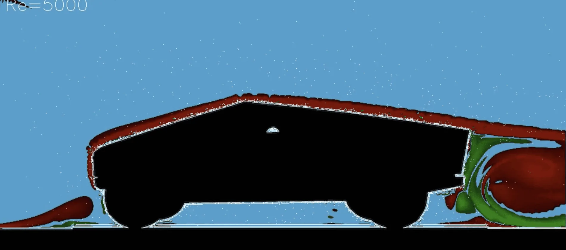

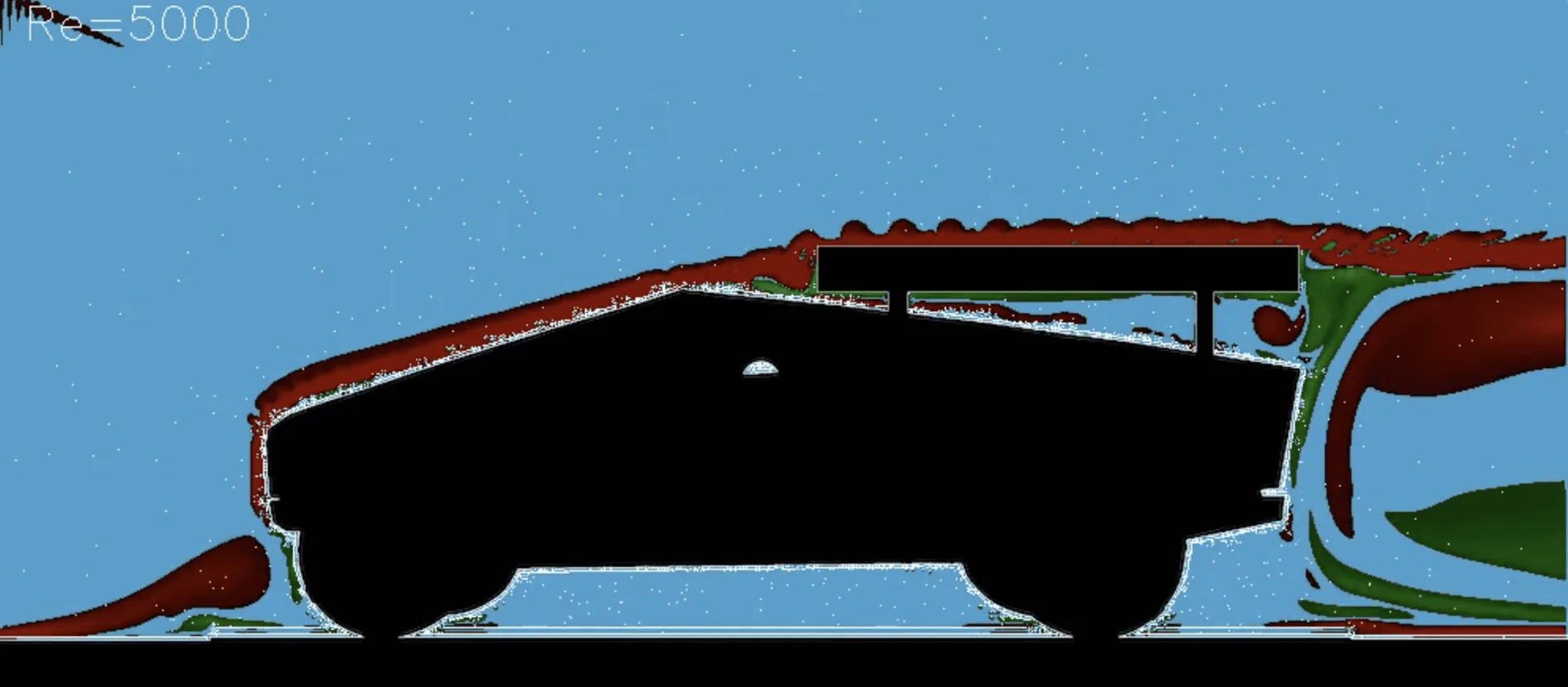

Forgot to ask you about documenting the 10% range loss. Is this simply your experience? If so, what's it based on? Have you found aerodynamic test results that give you technically accurate information? Not challenging you, I'd just like to see some actual test results of all Teslas and any of the CT that might have popped up. I'm wondering if there's simple air-flow app or website that can use a 2D or 3D model to give an idea of how much loss there would be, both because of the attached structure and additional weight (my Roofnest Sparrow weighs 130lbs, add 30-50lbs for the rack without anything extra attached to it).
Here's something I ran using Flow Illustrator. It looks pretty and does show the turbulence caused by the RTT but this is not scientific. It uses a jpeg file and I didn't use the maximum resolution I could use so it shows turbulence over a rough surface. It was fun using it. Now I just need a real airflow expert to run some airflow tests with and without something on the roof rack. I have the videos but they might be too large for this forum.

That's pretty typical of roof top tents. I've heard as much as 17%. Yours is more flush with the roofline, but EVs are more sensitive to this than ICE cars.
I think Rivian quoted 5% in the bed and 10% on the roof of the truck. This is somewhere in between, but the Cybertruck has a much cleaner design.

Yeah, the Cybertruck being more aerodynamic will take a bigger hit for the same thing bolted onto it as it brings it down to the worse vehicle's aero.
That's just the breaks. Drive slower.

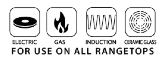

Actually, lightweight aluminum pans won't work on induction stoves unless they have a metial inside that supports a magnetic field. Check out https://cookeryspace.com/cookware-induction-ready/. Aluminum is not magnetic. Cast iron, stainless steel and carbon steel are. Many new pans with flat bottoms, also a must, are induction heating compatible. See following chart.
Tesla Cybertruck What I need to camp off-road and off-grid Screen Shot 2021-09-22 at 2.30.58 PM
Actually, a properly seasoned cast iron skillet is the best thing to cook in. Easy to clean with hot water (never use soap), keep it seasoned and it will last forever. Doesn't matter what the heat source is. BTW: the website I referenced says "Almost 90% of the heat generated by induction cooktops is used for cooking as compared with 65-70% with gas/electric."
