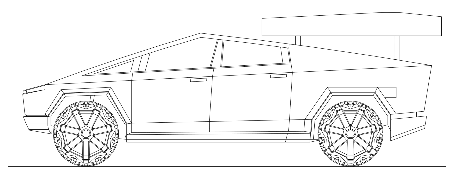

I've been playing with a 2D drawing of the CT, adding different things. Here's a simple drawing showing my Roofnest Sparrow rooftop tent attached via a custom roof rack (not really, just a couple posts, would add a full, flat side for carrying things). I'm more or less trying to keep the RTT low enough not to create a huge drag but understand the air flow going over the CT would be interrupted.
That is likely going to cost you 10% of range.
