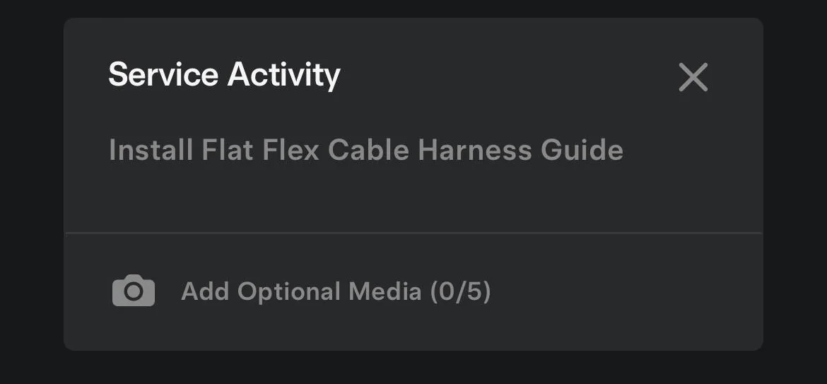

I took my CT for the wiper motor and sail applique recall but after the service, they schedule another service for flat flex cable guide. I didn't see anyone posted here for this item.
Btw, i got the model X for the loaner. The interior space is much smaller than CT but FSD was nice.

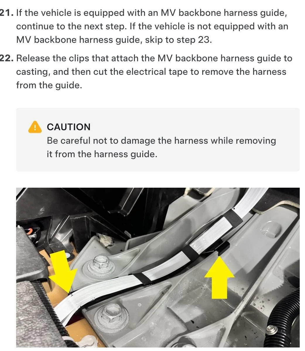

That's the cable that runs along the floor and connects the right and rear control modules.
Procedure:
https://service.tesla.com/docs/Serv...004_Install_Flat_Flex_Cable_Harness_Guide.pdf
