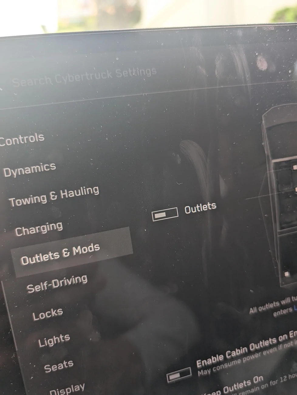

Well...I think I may have found my issue🤞🏼 Somehow(maybe via the last update)under the outlets and mods tab... the outlets was switched to ON.
Switched to OFF(pic).
Whirring stopped.
Hoping it stays that way.
Still curious what that noise is tho
I hope this helps someone else down the road.

That’s not normal, I have my outlets on 24-7. I use the 120 plug to charge my iPhones via Apple bricks and Apple MagSafe. You should take it to a different service center bc should be no noise or change when enabling or disabling those outlets.

It's the coolant pump. You can bring up the service mode and verify it. Also turning on the bed outlets will force to start running too.
