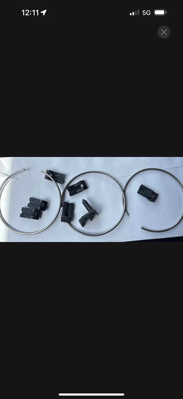

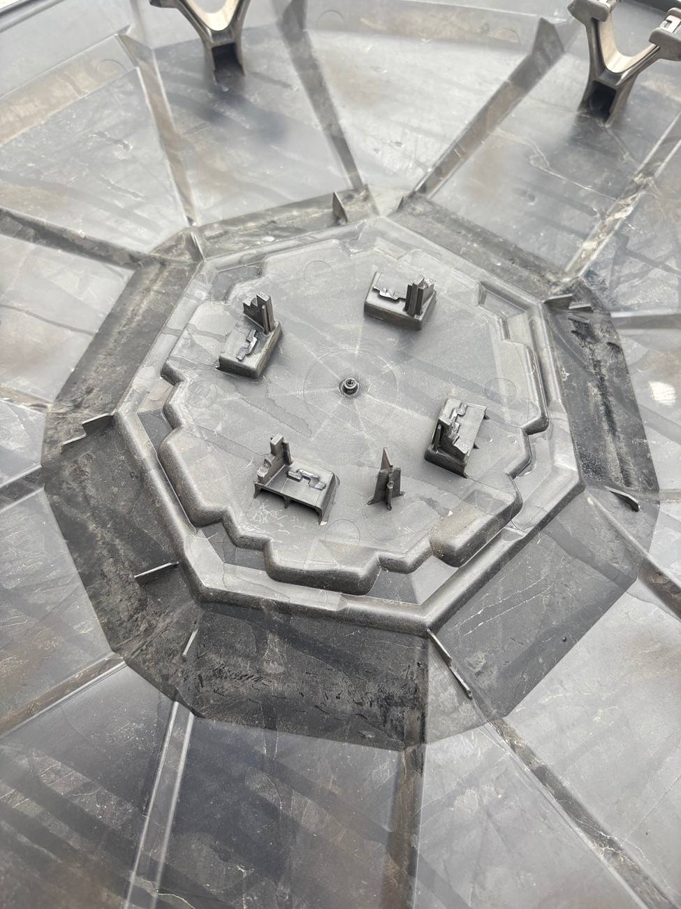

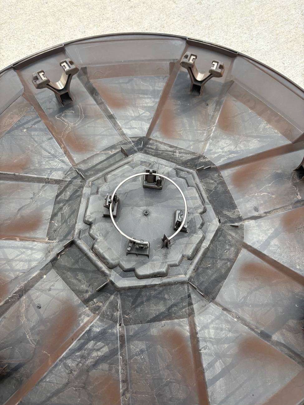

I have had my truck since November and I kept hearing a rattle. I took off the wheel covers (for the first time) and all 4 covers had broken plastic clips? this normal? Nothing other than city miles. No damage
Tesla Cybertruck Wheel covers popping off... IMG_0129
Tesla Cybertruck Wheel covers popping off... IMG_0136
Tesla Cybertruck Wheel covers popping off... IMG_0137
Tesla Cybertruck Wheel covers popping off... IMG_0133
Tesla Cybertruck Wheel covers popping off... IMG_0134
