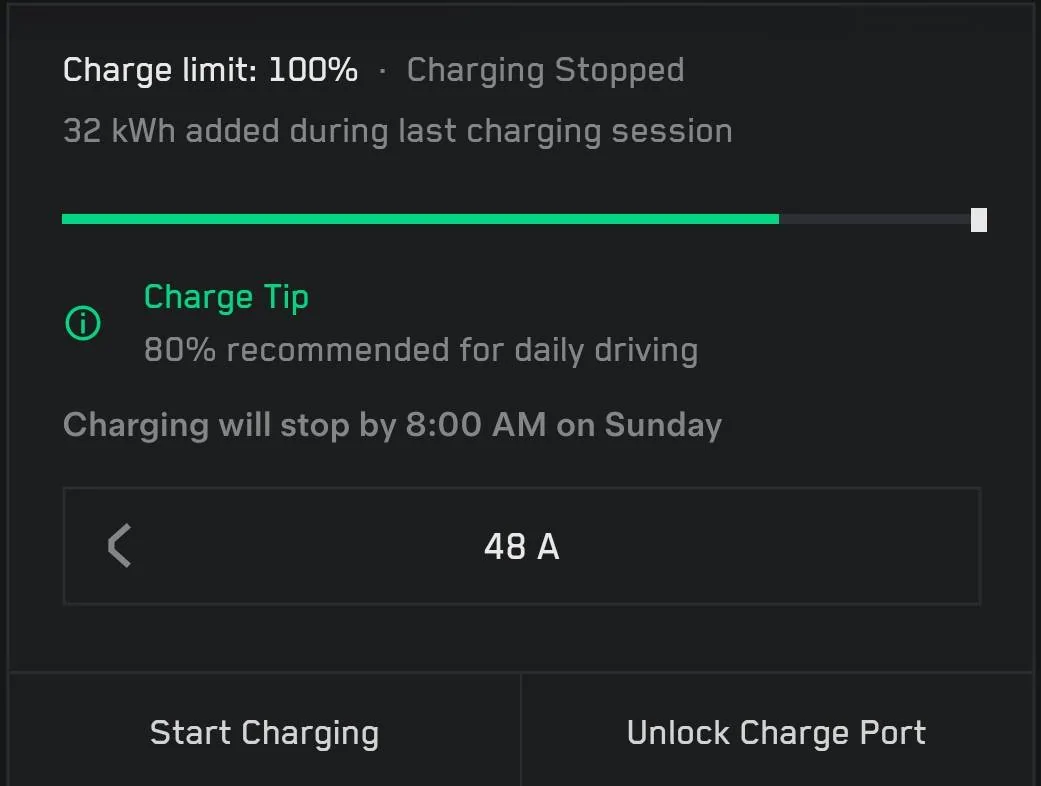

This does what you are asking for :
That wouldn’t work if it’s Saturday and you crank it to 90-100% and want it when you leave.
I had to check sat and sun, then tell it to start 5am then stop 8am.
Would be far easier to just set the desired SoC by the time and let it sort it out.
Yeah it does. That's how I do all our road trips. Set scheduled stop time, crank limit to 100%. Usually set it the day before.
If may start up to check your charging rate. If it starts a normal charge cycle, tap stop charging.

correct! currently, the most accurate and reliable method is to start charging with the limit set at 100% and subtract the estimate from your preferred departure time. I don't even both with setting a temporarily schedule.
Also, please note for everyone out there:
charging to 100% is only recommended if you absolutely need it; also don't leave your truck at 100% for a minute longer than you have to. Be accurate about your departure.
