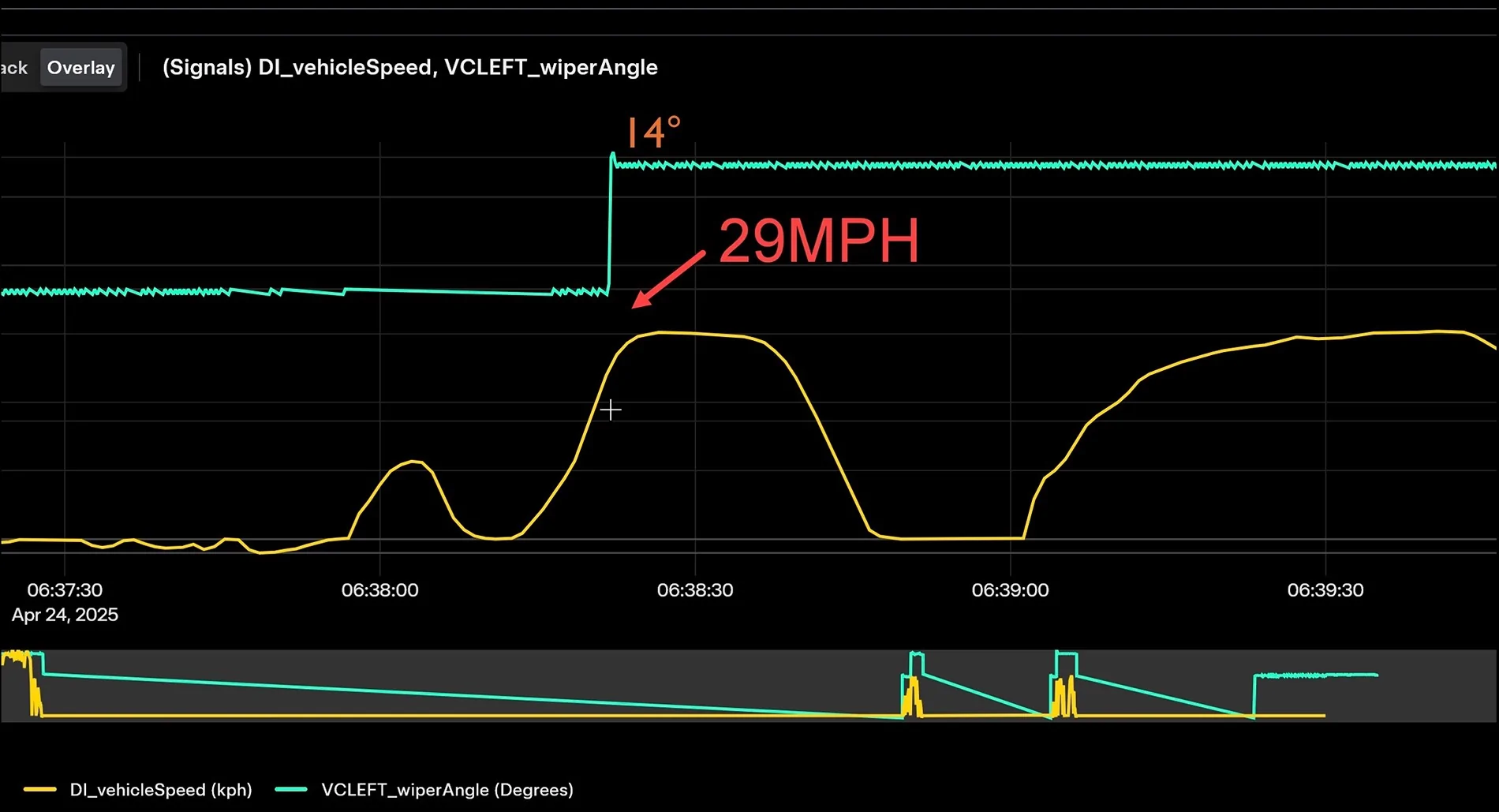

This is an aero advantage move. Here’s from a log showing that it moves from 10° to 14° at 29MPH:

Yes, at 29/30mph+, the wiper shifts 2-3 degrees for aero efficiency. Totally normal.
That said, if the wiper motor is ever replaced, there's a very specific way to reinstall the motor so that the wiper is aligned correctly (check the service manual and you'll see the specific steps). The service center messed it up on mine back in February, and the aero position was at least 1 inch into the windshield / driver view from the 'black' part of the windshield. I only mention this in the small chance that the motor wasn't calibrated properly.
