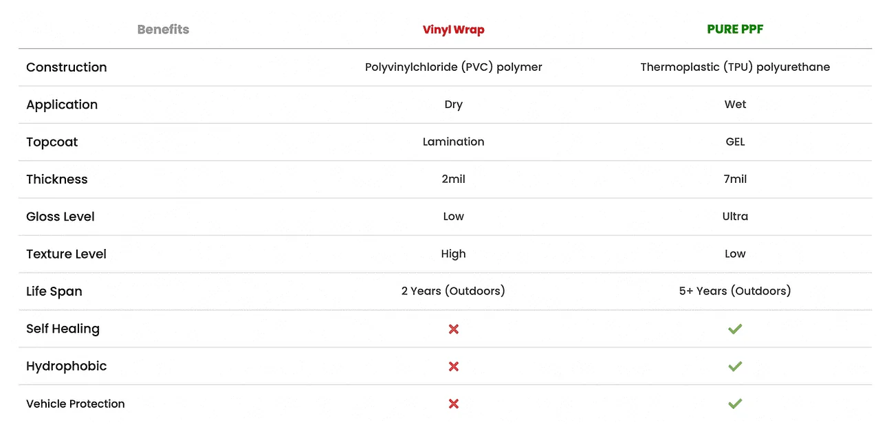

In terms of PPF vs vinyl, it's mostly been covered above, I'd add two more points:
  • PPF is easier to apply. There's technique to both, but the chances of wrecking a piece are 5x with vinyl vs PPF, which you REALLY have to screw up to make it unsalvageable. Once I angrily removed a frunk section of PPF, screwed it up and chucked it in the trash. After I'd watched a few Youtubes, I pulled it out the trash, removed the dog hair and other fluff, and reapplied, you'd NEVER know.
  • Can't print on PPF, so if you want a pattern, has to be vinyl for now.
If it's a cost decision, I'd still recommend installing PPF yourself over paying a shop for vinyl. It's such a do-able project, and extremely satisfying.
