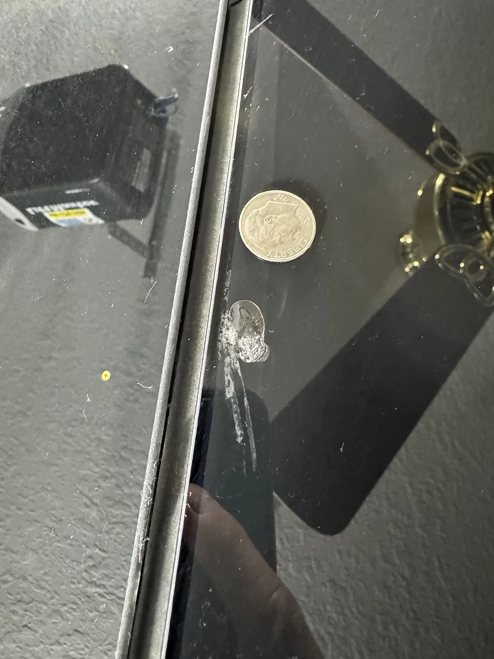

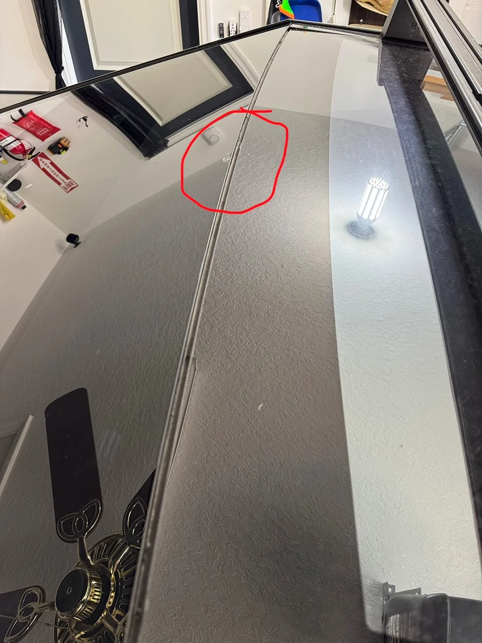

Noticed small spot of what looks like a kicked up debris hit on top of my windshield. Further inspection though showed no damage to the exterior surface of the glass and the damage is originating from the interior side or maybe between the glass. Has anyone ever had this issue? Right now it’s close to a dime size.

Looks like some kind of delamination of the urethane from the glass. Id take that to service and point out that theres no external damage. Thats something that might get you a new windshield
Ya, windhield replacement is the only fix for it that I can think of.

Yeah this happened to mine. Bubble got worse over time so put in a service request and they changed out the whole windshield under warranty.
