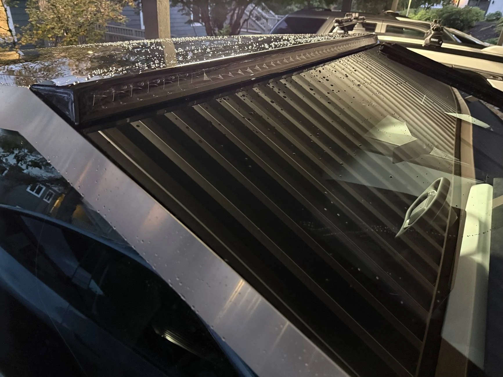

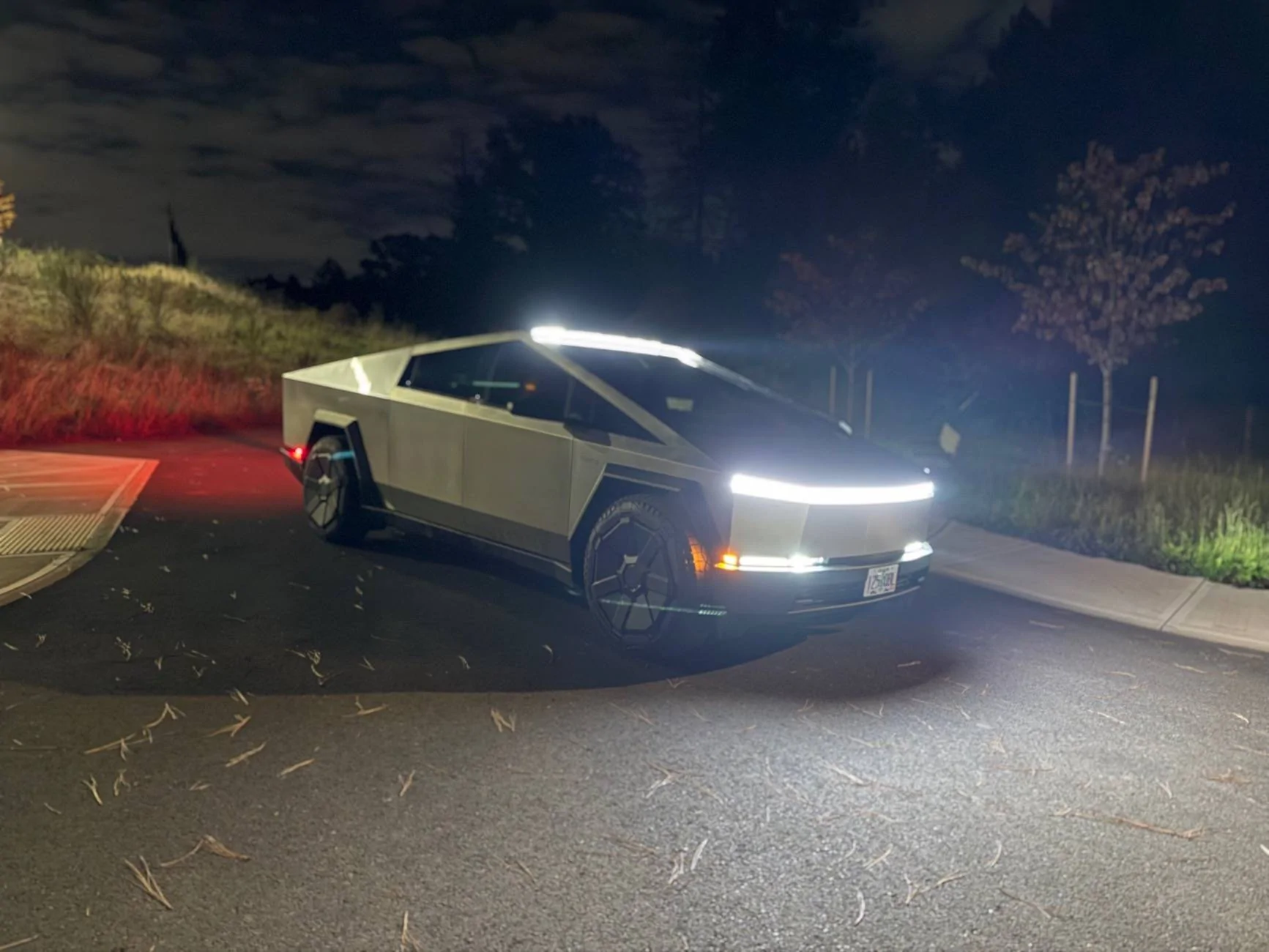

Scheduled a service appointment this past Friday for a few minor panel alignment issues and added a task for the light bar. It was a bit of a Hail Mary , but when I went in for my appointment today, I asked if they were installing the light bar. They informed me that they had it in stock and had planned to install it. However, they didn’t connect the wires. Apparently, they were still using the old process, where instead of soldering the wires and then disconnecting the connector they didn’t connect at all and left the wire package in my cup holder. So, I’ll have to take care of that this week. I’ve attached a picture of the light bar.
I believe that is the current way of doing this, not only did they not soldier the wires, but they also disconnected the B pillar harness on mine. I ordered some water proof 3 prong harnesses, so I could easier discount at the roof(also to easily test a theory about connecting it to the frunk connector, so I could use it in non-off road, but it works like that on the roof). But the delivery of the harness wasn’t expected until 7pm. And I wanted at 2, so I soldiered them, I’m impatient, hence the foundation model.

Hiding the wire is easy, take a plastic tool(or screw driver if you’re brave) and just shove the wire under the light, around the windshield. See my second image

Was able to hide the wire around the glad instead of up and over.
