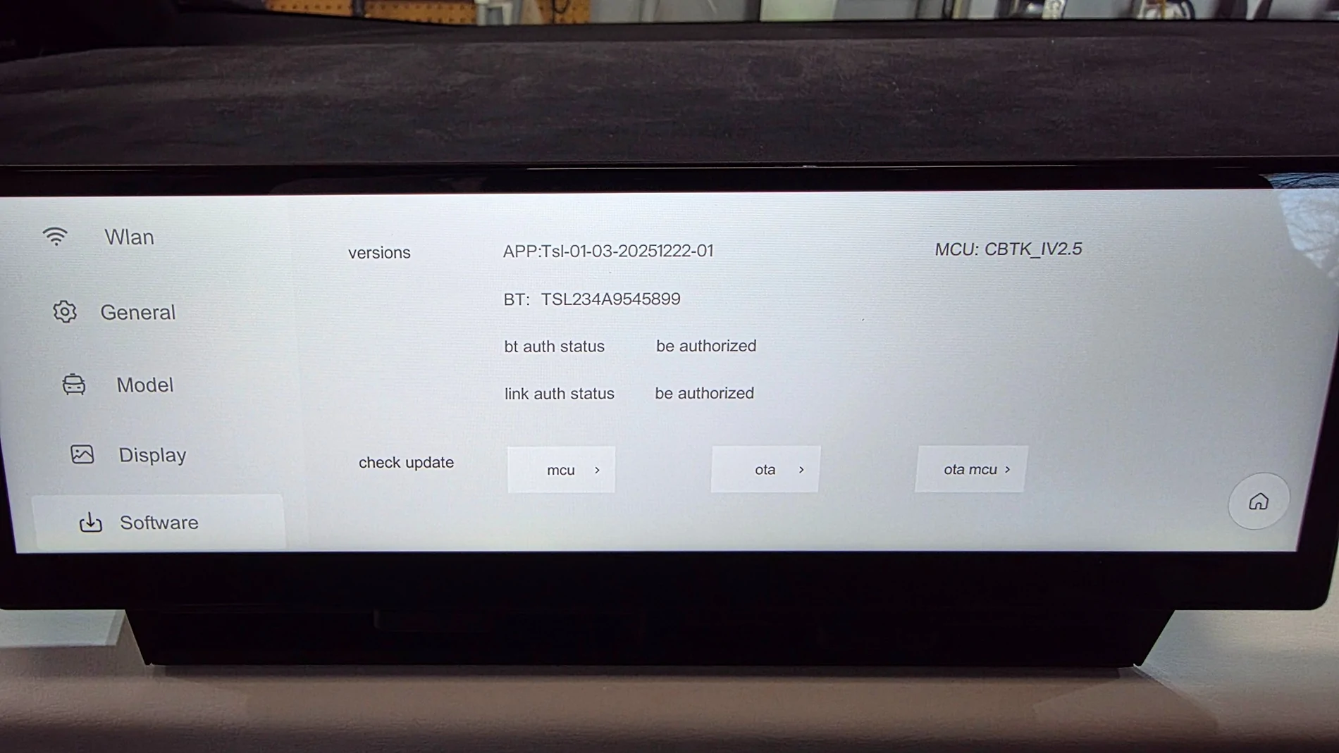

Well I had the secondary screen install go sideways today when after I updated the screen over the air the screen no longer displayed information from the truck. What version are you running on your screen? I took a picture of the version on the one I have so we can compare. Did you ever update yours over the air? Additionally, the 3 places that you tap in, for the small one under the carpet I only found a fitting to plug into, there wasn't really a need for a male and female connector because there was nothing to daisy chain. Was yours the same way for that connector? The ECU connector and power connector both needed to be daisy chained.
Here is the pic:

That is just Covenant cryptoghraphic code...I think they are to your presence on Earth and apparently hacked your console. Just get Cortana or 343 Guilty Spark to help you decipher it....may take the the Sacred Icon depending on the level of Covenant cryptography used...
