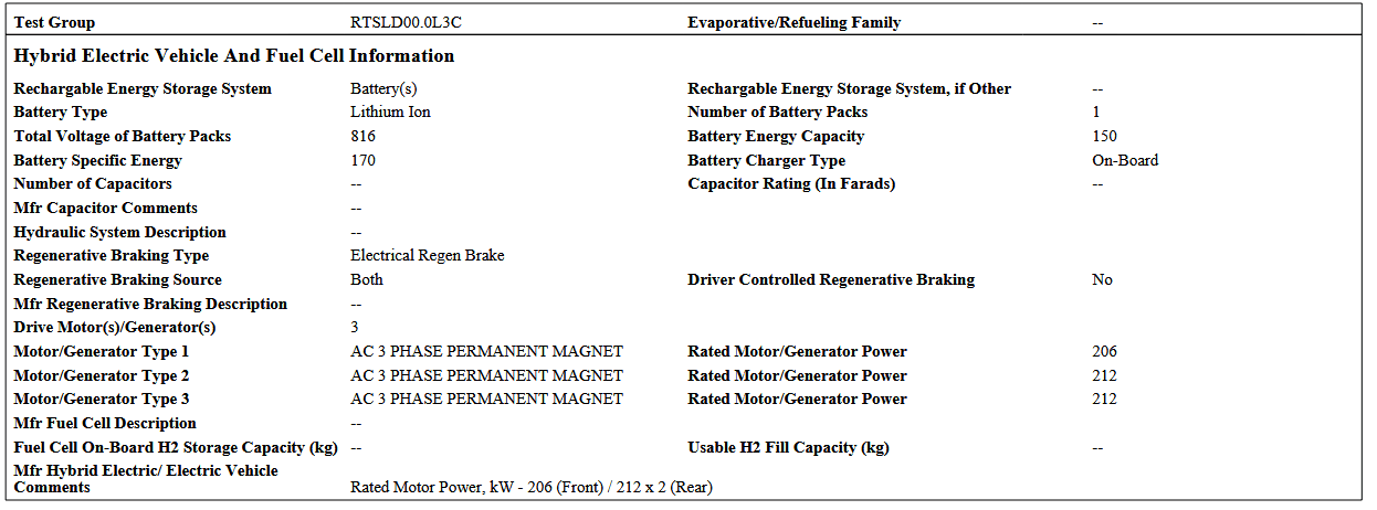

Interesting block of information. Am I reading this wrong? 150 kWh battery capacity (buffer takes it down to 123 kWh) and 3 permanent motors (no induction)?
Tesla Cybertruck Heat pump, battery size, Class 2b division (light-duty pickup) classification confirmed in EPA Cybertruck documents 1701734953190
To me it looks like 170 kW with 150 usable, but I am not familiar with the format of these documents.
Battery Specific Energy: 170 Wh/kg
I think this is the pack's energy density.
So 123 kWh usable is 18% buffer. I think the 100kWh battery has a 5kWh lower buffer and some batteries had an upper buffer, but probably not in this case. 27kWh lower buffer does seem like a bit much, unless they're reserving a larger amount because of the 48V system.

If the total energy is 150kWh, that’s 82% usable at launch. If that going up to 93%, that would be ~140 kWh and 385 miles. Maybe software locked or sandbagging. If the pack size is really that big, the castings, exoskeleton, 48V and cams saved a lot more weight than we thought.

815V x 150Ah = 122.3kWh, rounding error away from 123kWh.
Since there's no units on those lines of the doc, I'm going with that as my guess.
I sent Bard the photo of that page and this was its response:
According to the EPA filing for the Cybertruck, the battery pack has the following specifications:
  • Battery Type: Lithium Ion
  • Number of Battery Packs: 1
  • Total Voltage of Battery Packs: 816
  • Battery Energy Capacity: 150 kWh
  • Battery Specific Energy: 170 Wh/kg
  • Battery Charger Type: On-Board
This means that the Cybertruck battery pack has a very high energy capacity, which is what gives it its long range. The battery pack is also relatively lightweight, which helps to improve the vehicle's performance and efficiency.
Here is a table that summarizes the specs of the Cybertruck battery pack:
| Specification | Value | |---|---|---| | Battery Type | Lithium Ion | | Number of Battery Packs | 1 | | Total Voltage of Battery Packs | 816 V | | Battery Energy Capacity | 150 kWh | | Battery Specific Energy | 170 Wh/kg | | Battery Charger Type | On-Board |
yes, it’s a listing of 150Ah, not 150kWh - converts to 123kWh
This submission of the performance data is apparently of dummy data, and not yet final data for EPA rating
