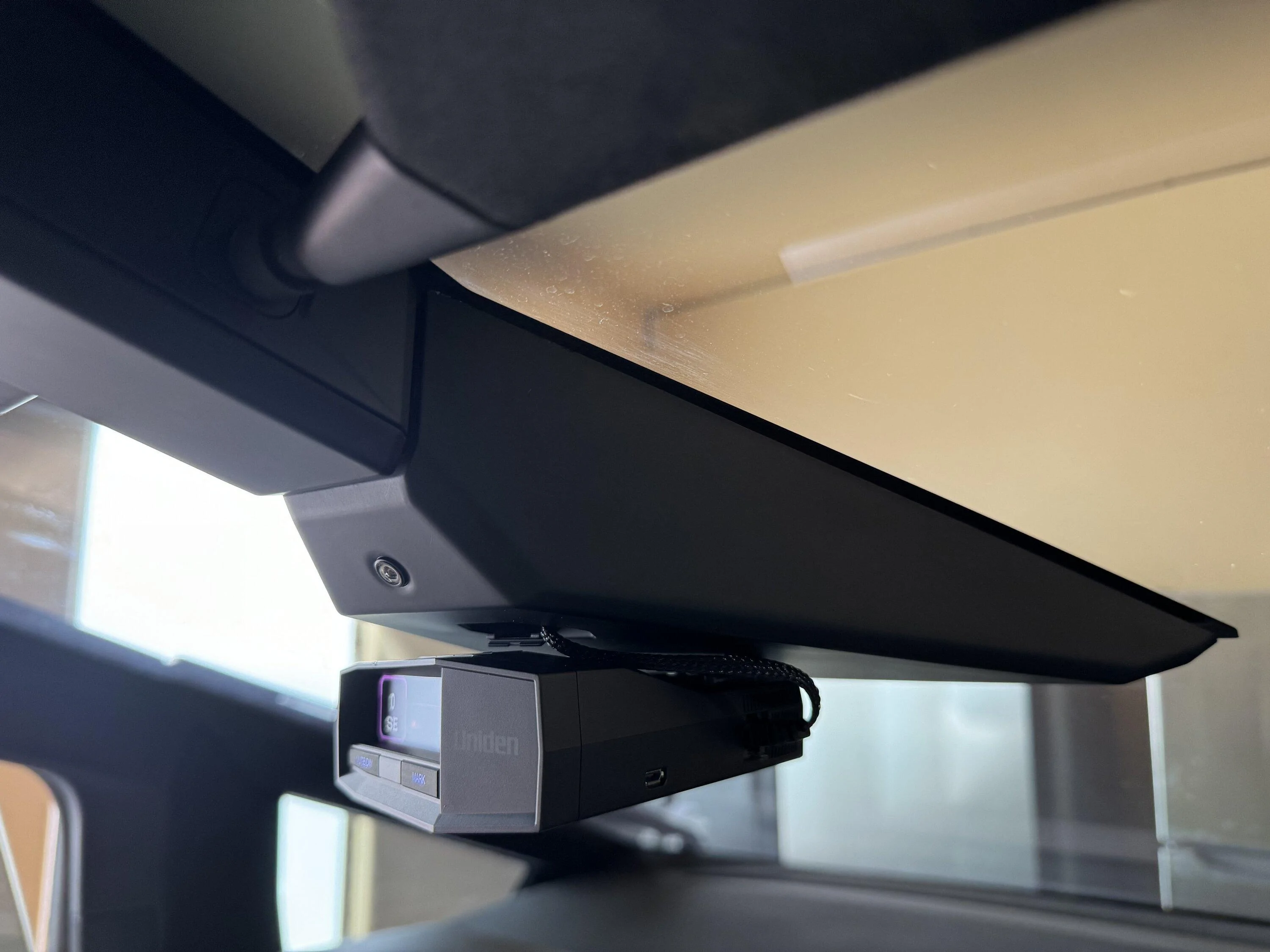

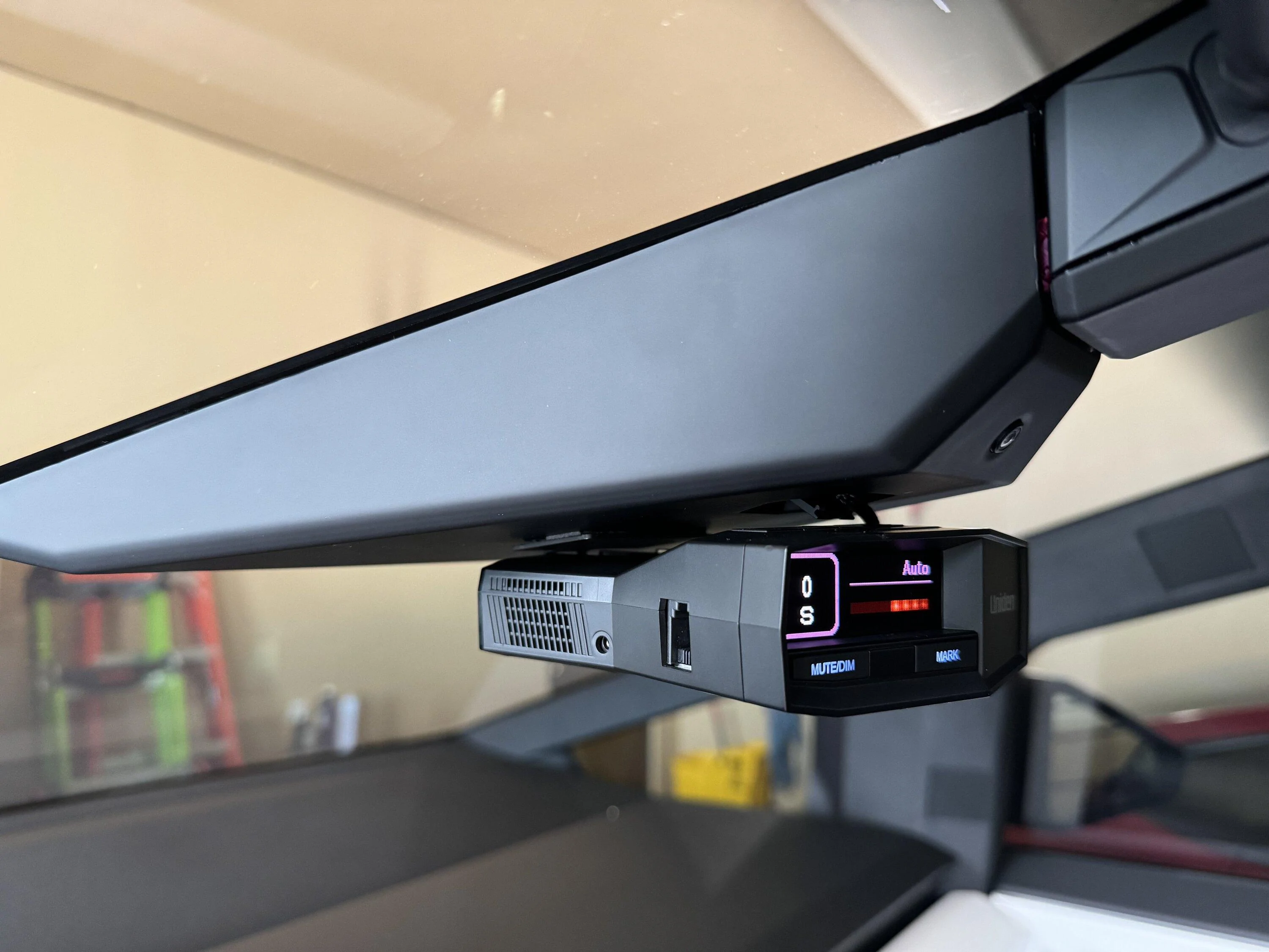

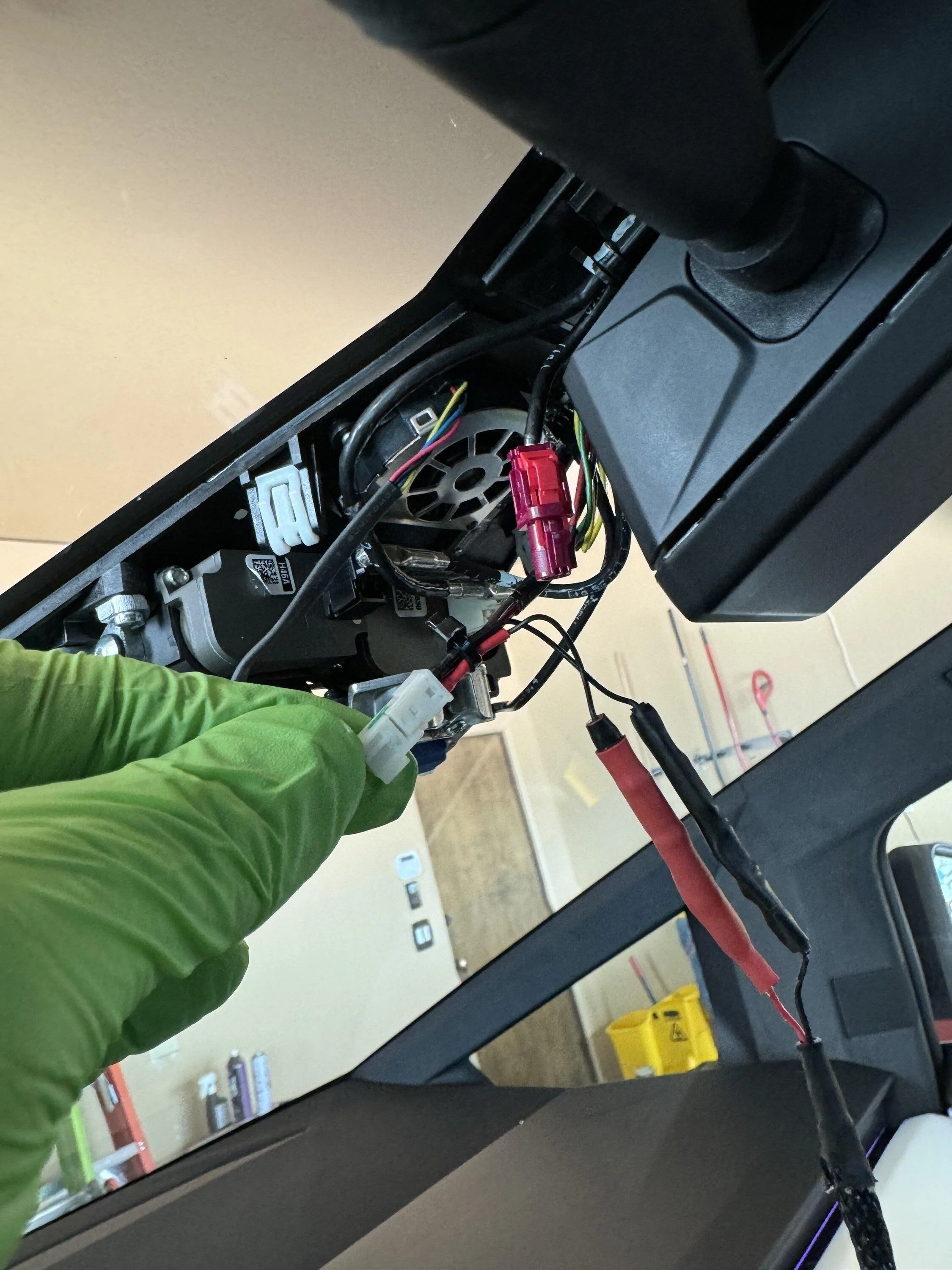

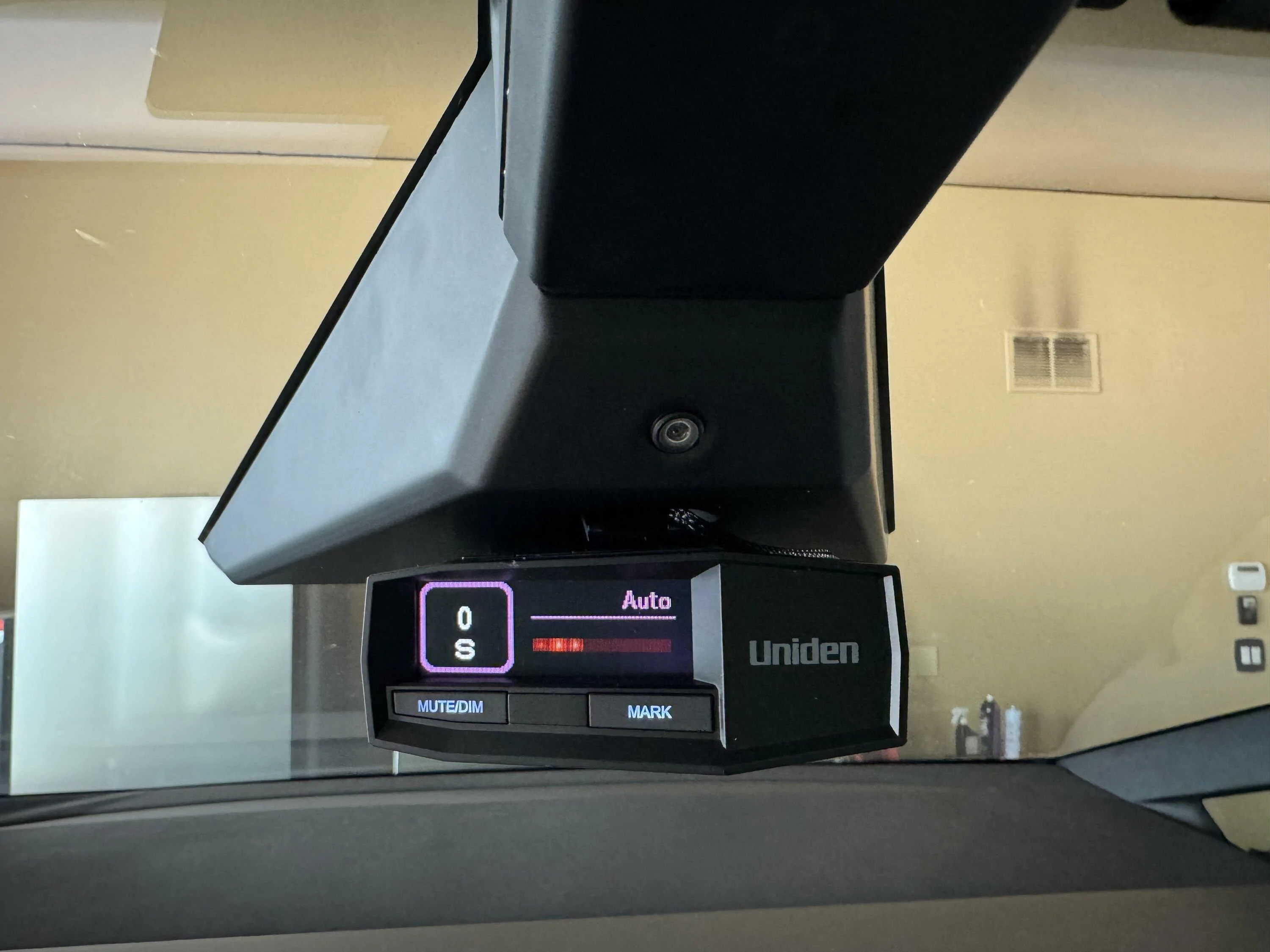

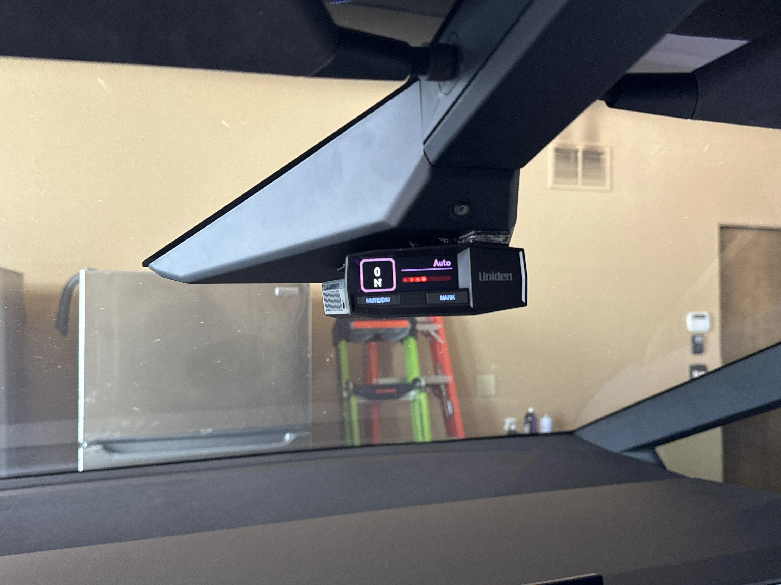

Alright dude... give up the goods!!!! Need the whole how-to! NICELY DONE!!!!
I mounted it using a double sided mount that I typically use on all of my vehicles because it is very minimalistic. I am looking at this as a permanent mounting location as it does not take windshield real estate and did not have to poke any holes for wiring as I am using rear view mirror door.
Long story short after testing a few leads I found this has Switched 12V power that turns off when truck goes to light sleep. It seems to power a small fan and possibly the temp/humidity sensor there.
This is just for information purposes, I reccomend you do proper research before wiring anything up!

I mounted it using a double sided mount that I typically use on all of my vehicles because it is very minimalistic. The Velcro up front is temporary. I am looking at that as mounting location for now as it does not take and windshield real estate and did not have to poke any holes for wiring as I am using rear view mirror door.
Long story short after testing a few leads I found this that has constant 12V and is power for all accessories here. It might always on, I will test soon enough, however my radar has an auto off feauture so personally not worried about that.
Whats the power draw on your detector?
I would check to see what the 12V is powering before using it without knowing the rating for that cable. Maybe measure the voltage drop on it when you turn the detectorr on?

Its between 275-400ma depending on whether its detecting radar or not. That looks like 16-18ga wire which means it can likely handle up to 10A without too much trouble for a short run.

Those power levels should be ok, but I wouldn't be going by the cable size to determine the rating, as cables are normally oversized to reduce resistance especially on things that are on all the time. Cable size might also be required because there is a load of that size on there already. A DC clamp current meter will tell you whats going through it when its on, and measuring the voltage sag when you turn your devices on will give you an idea if theres enough available.
Remember that every low votage under 48V you find on the CT now comes from a buck converter not a 12V battery, so peak watt output will be severely limited in comparison to the battery.
Also theres no reason to guess what the cables are for, you can look it up on the electrical schematic in the service manual online.
I do wish that they would include more LV power connections throughout the vehicle and I also wonder how much power is available for RV charging through 12V. Electric trailer brakes take a few amps too so there should be a spec for that somewhere.
