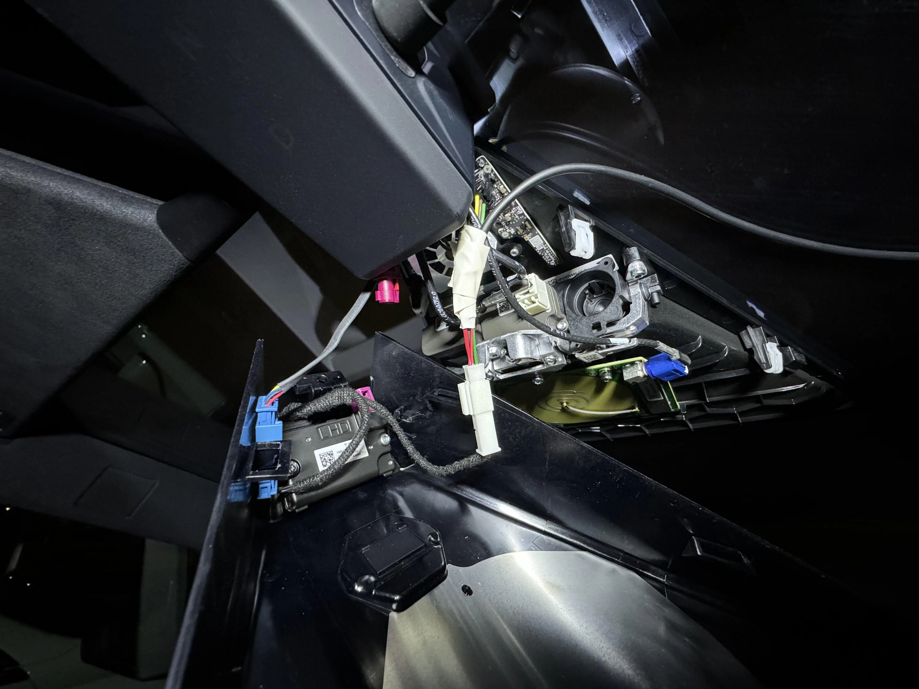

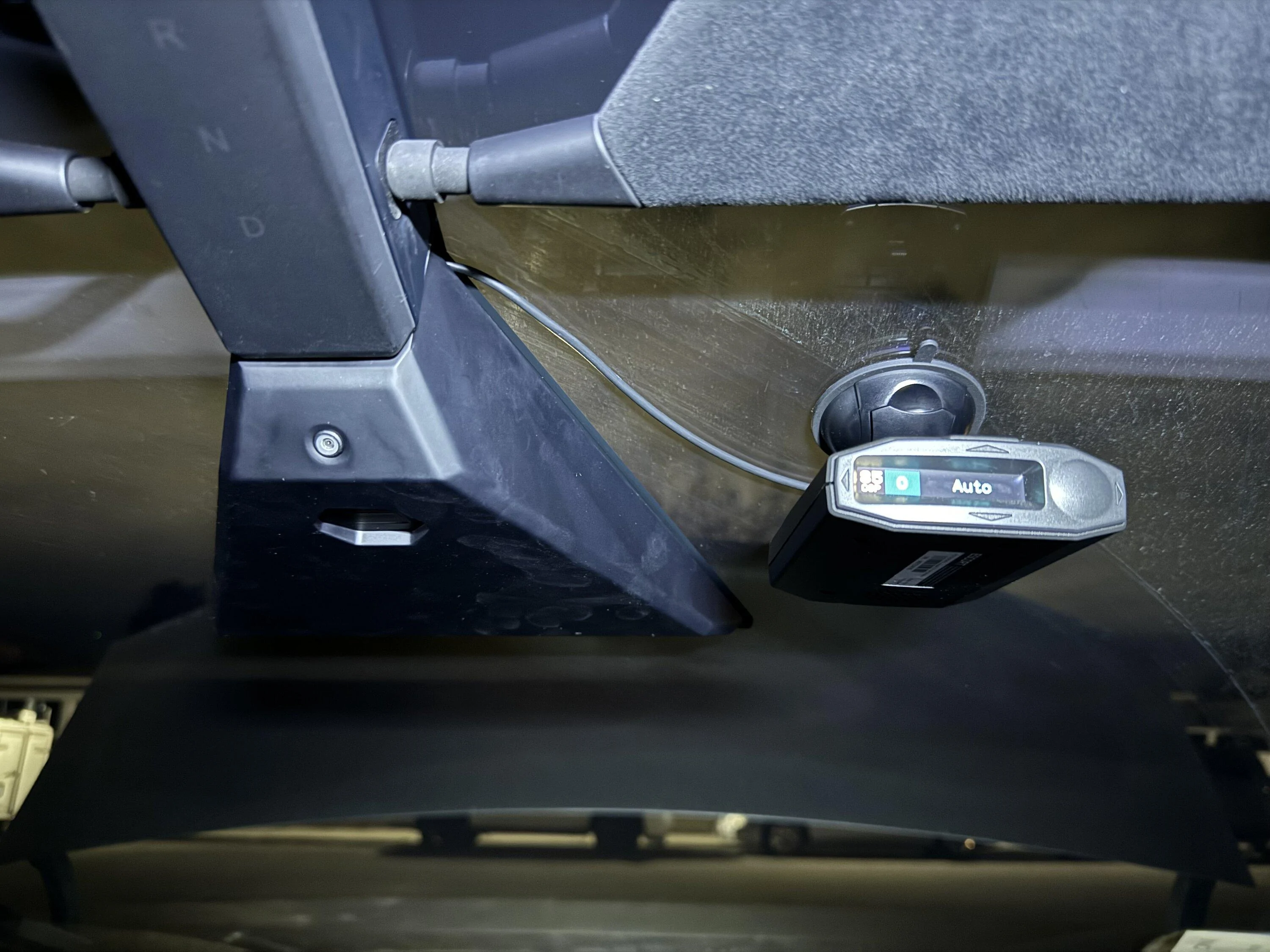

Just wanna add to the thread. I tied into the cabin camera power. Came out to 15.5v. Tapped in with a rj11 phone cable. Power draw on the detector is pretty low. Been running it all day without any issues or warnings so tolerance on the efuse must be pretty high.
Tesla Cybertruck 12 Volts DC - Available in cabin? IMG_1022
Tesla Cybertruck 12 Volts DC - Available in cabin? IMG_1024
Wooohooo! It looks awesome! Thanks for sharing!
Are those two red wires the same? Which one did you use?
