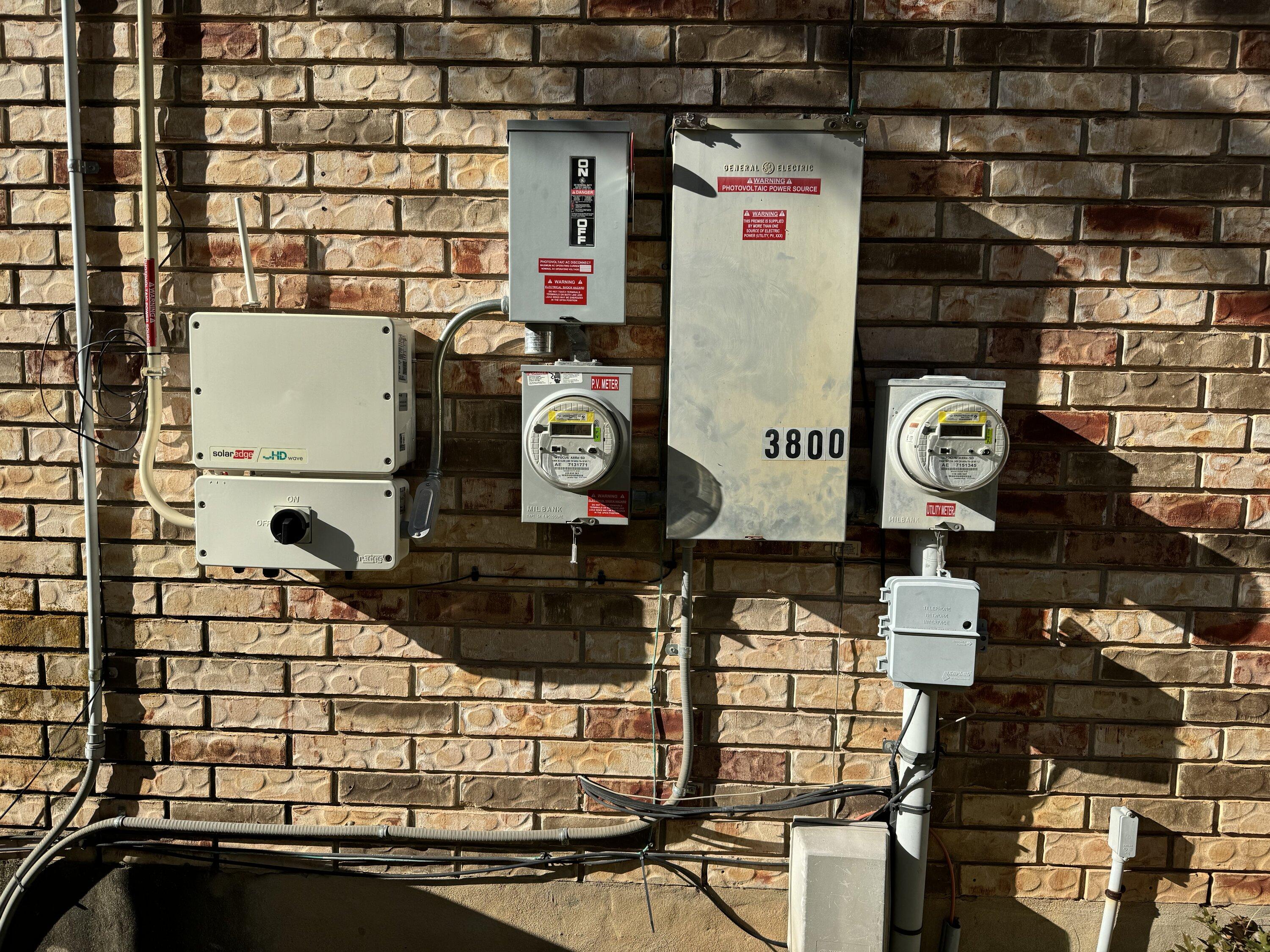

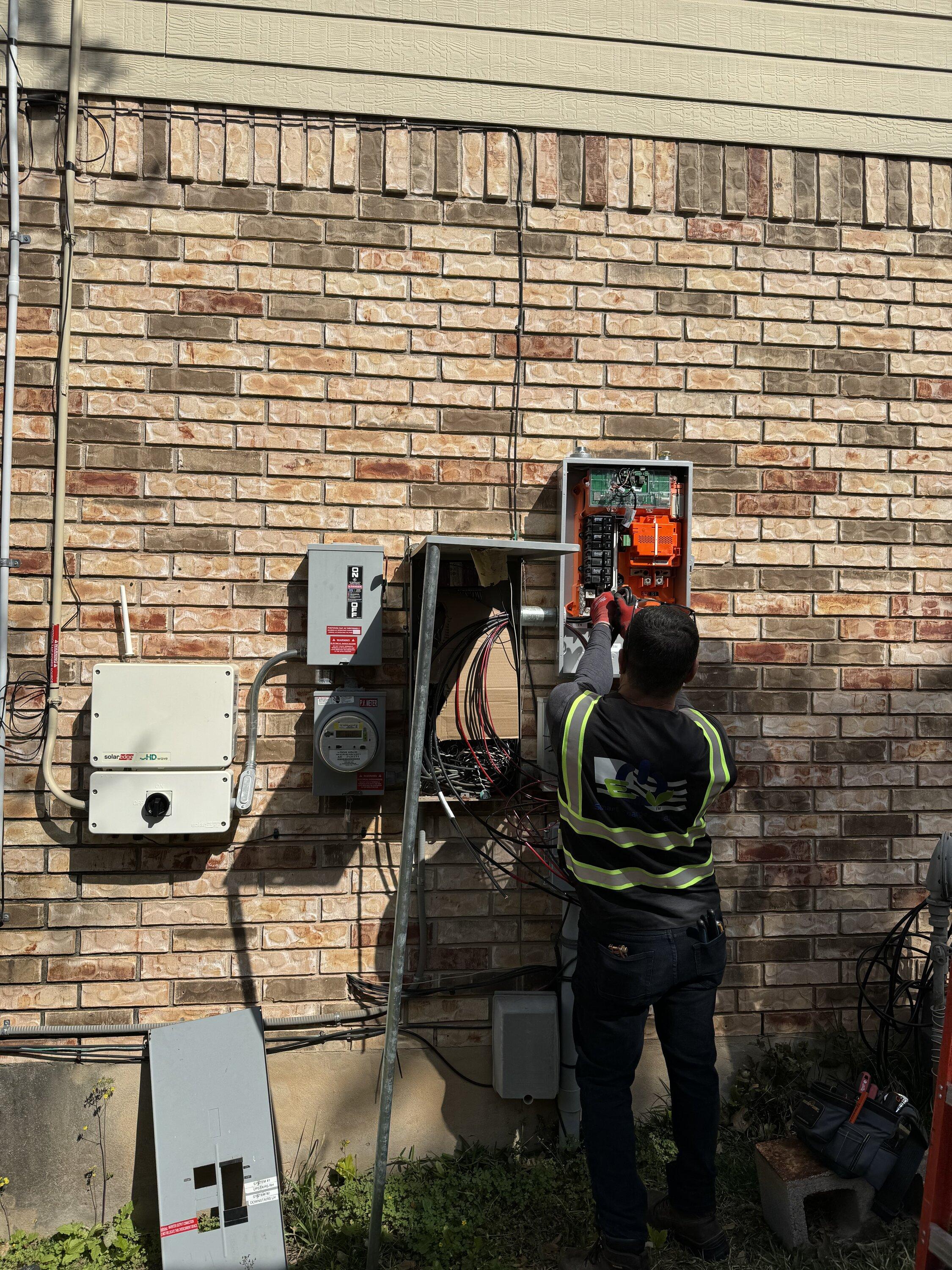

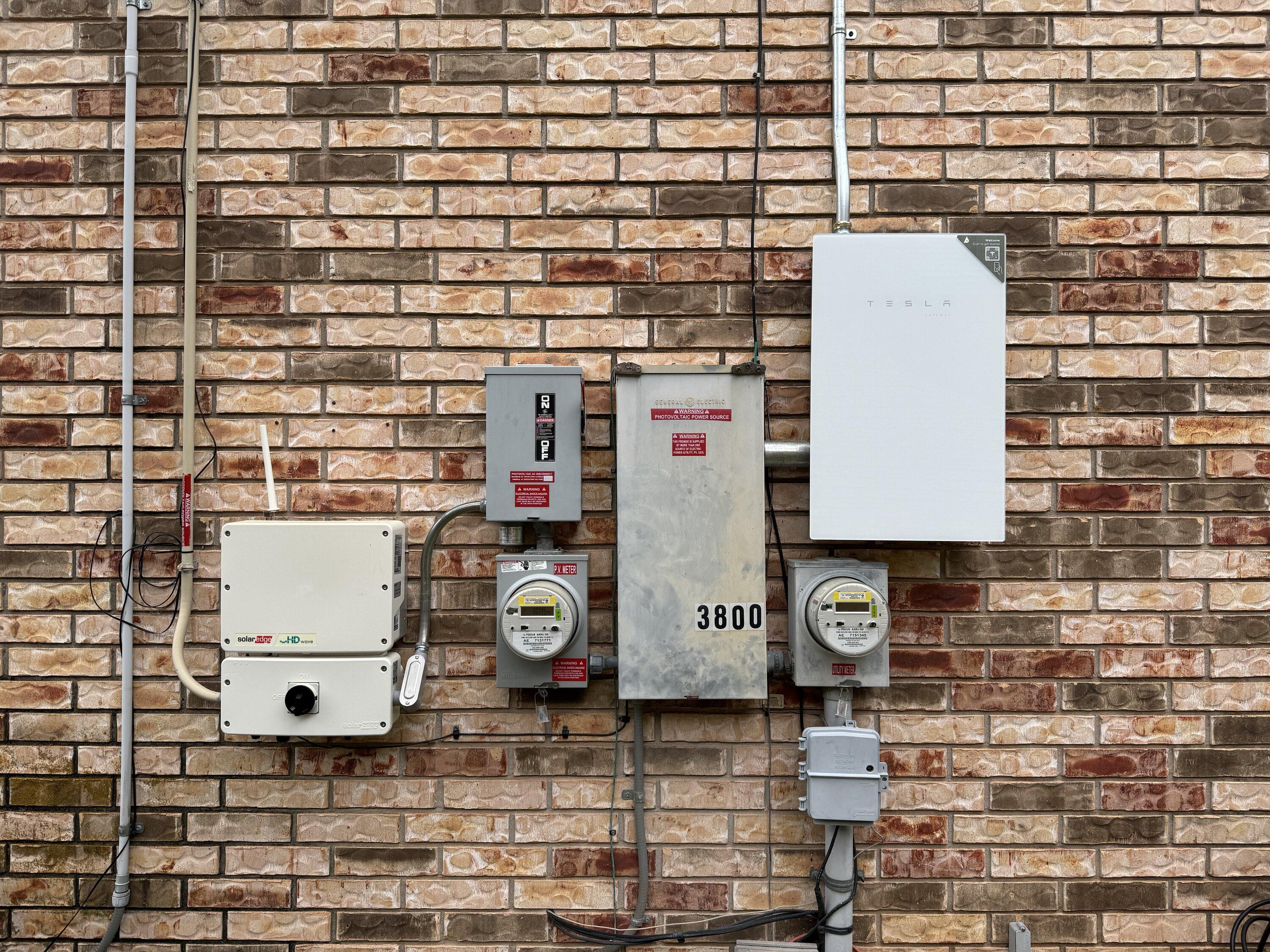

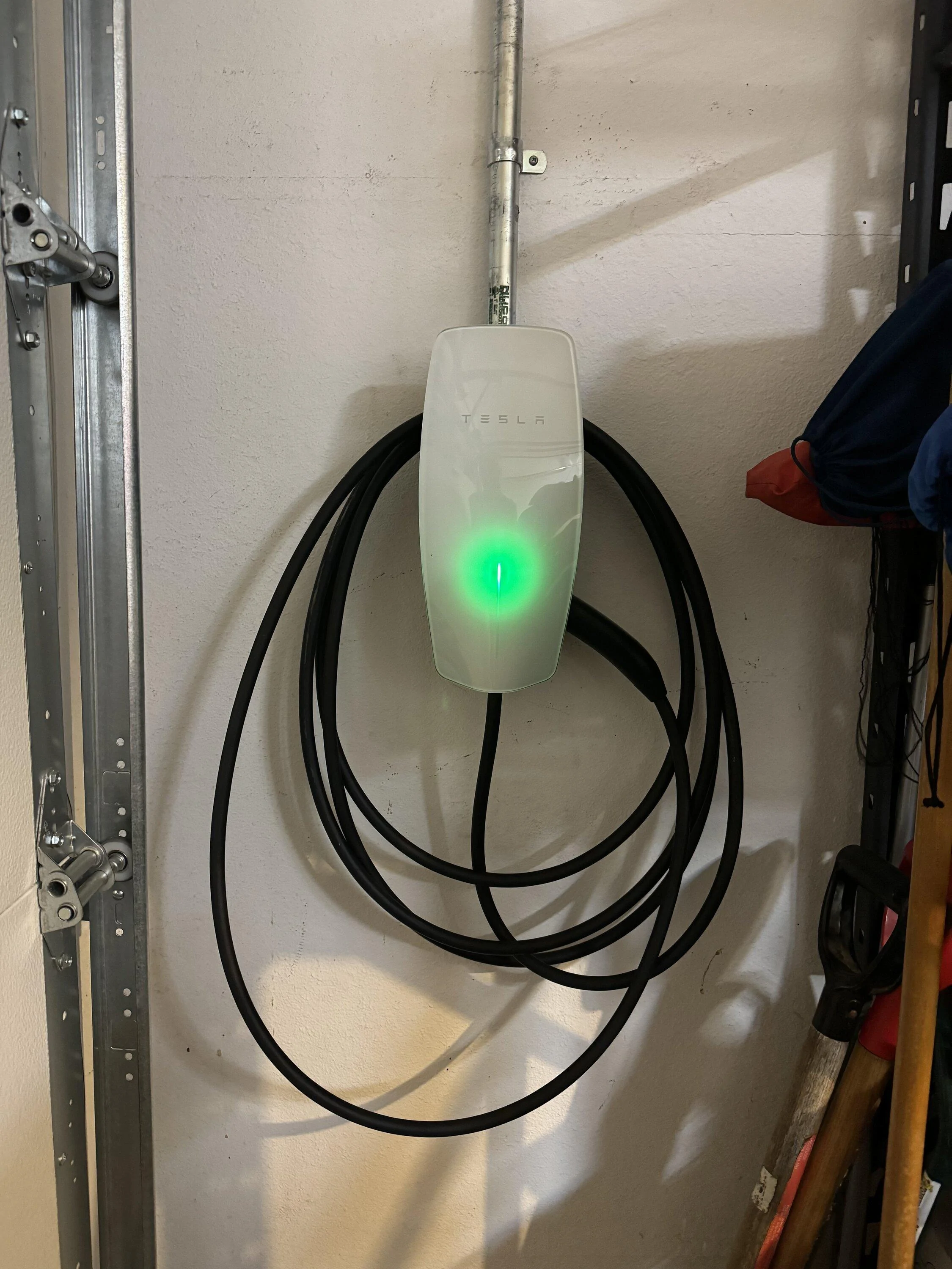

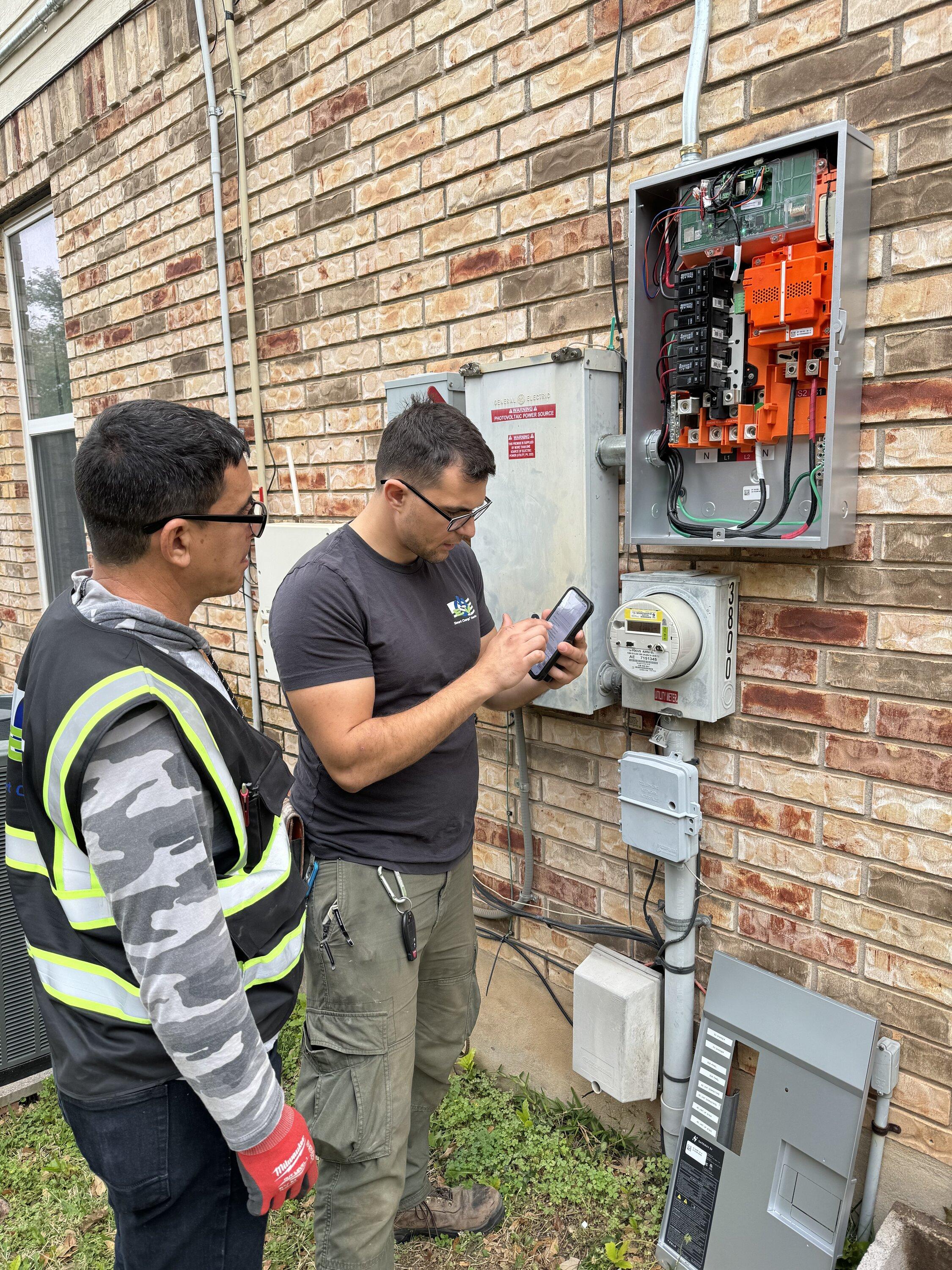

Smart Charge America completed my Powershare install today. Before and after pictures above.
I have non-Tesla solar so the Gateway was connected to my main panel after the meter and three loads (sub panel and two AC compressors) were moved inside as my backup loads.

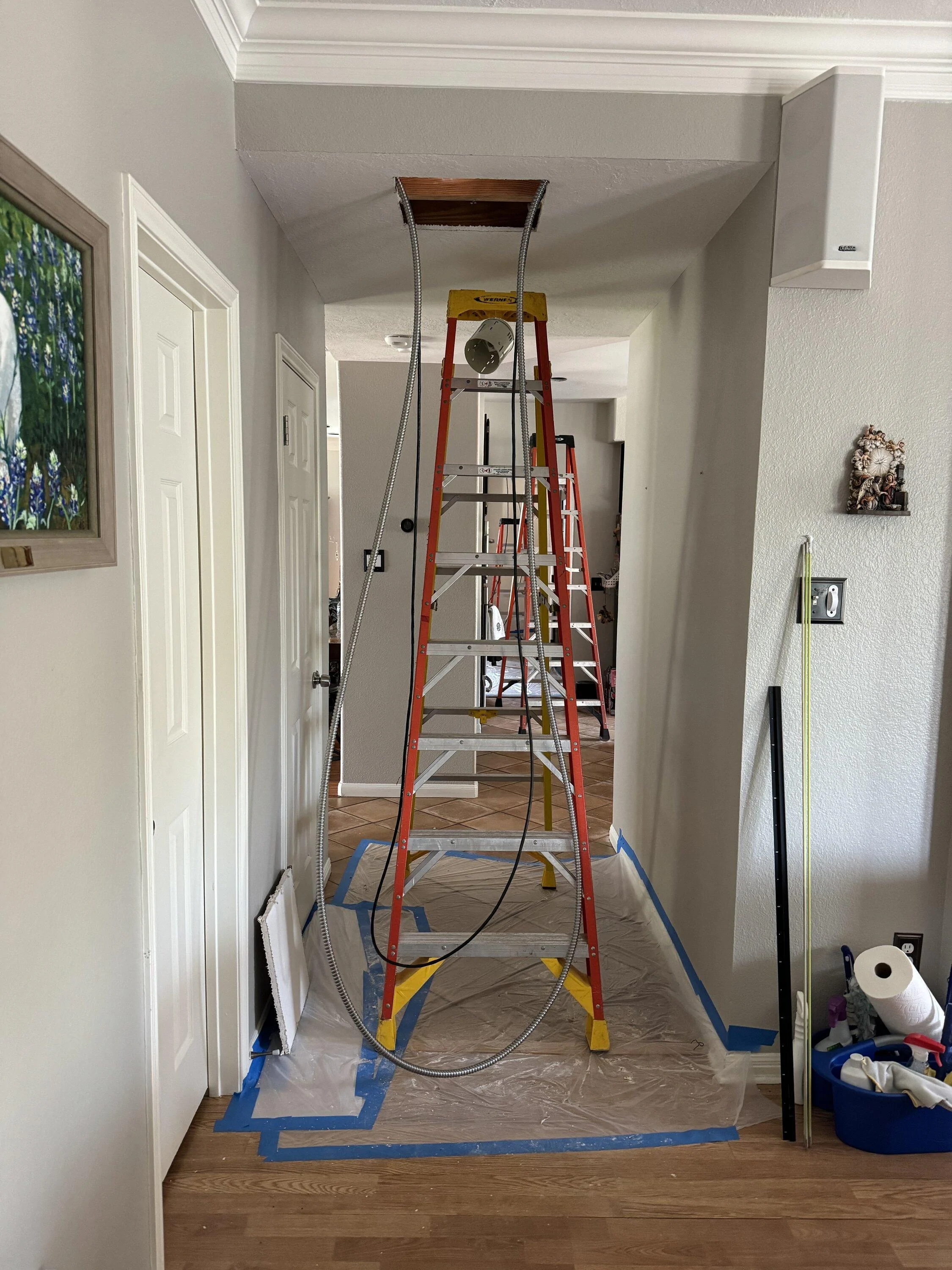

My garage is on the other side of the house so both power and communication wires were fished through my first story ceiling.
I will throw some more pictures in the thread. Feel free to ask any questions you may have.

Good question. Before Powershare, the SolarEdge inverter would shutdown during an outage since I didn't have a battery backup. Once my Powershare gets activated, the Cybertruck will serve as a battery backup, but the solar inverter will still shutdown. The only way to get keep your solar panels generating during an outage is to add a Powerwall to your setup.
Outages are rare in my neighborhood so I opted against adding a Powerwall.

Two holes, each a foot square, were cut. I offered to have my painter patch them. One hole was where the wire entered the house and the other was where it entered the garage. See the interior picture with the ladders.
The Tesla Gateway can be installed between the meter and existing main panel for whole home backup, but then you need to wait for approval (and inspection) from your electric utility. That can take months. By installing the gateway after the main panel, the utility does not need to get involved. (They treat it as a generator)
My installation allows the gateway to be directly attached to the meter if needed in the future.

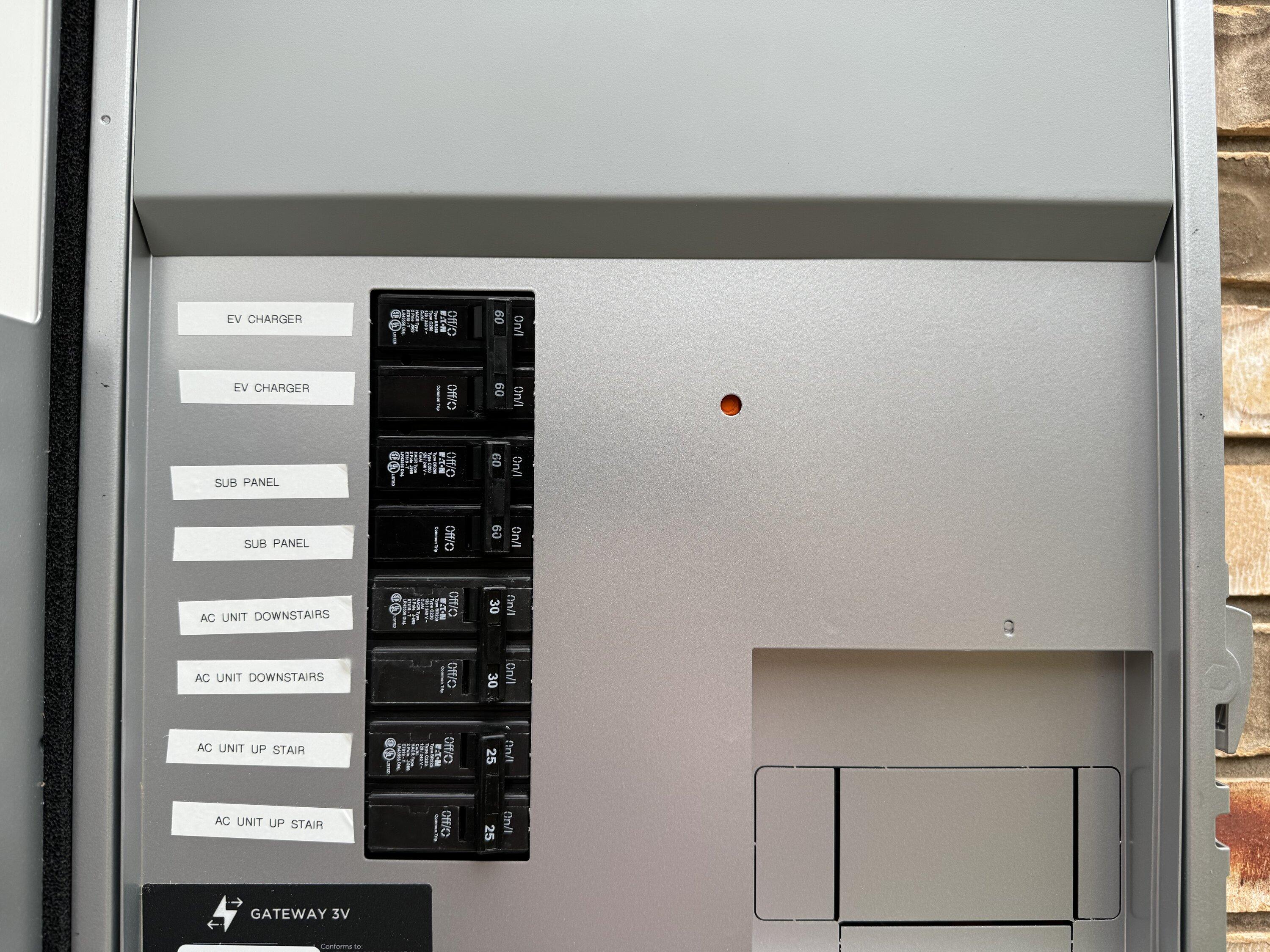

A 125A breaker was installed in my main panel that fed the gateway power. The electrician then moved three circuits from the main panel (my sub panel and two air conditioners) to the gateway panel for backup. A fourth circuit was run to the UWC in my garage for the Cybertruck. (The panel in the gateway only has room for four breakers which worked out perfect for my needs.)
The only remaining circuits in my main panel are my oven, dryer, and solar inverter. They are my non-backup loads. I didn't need to touch my solar wiring and it will shutdown during an outage as expected.

Your setup will still stop making power but depending on what equipment you have it can be swapped over to stop that

I am doing "partial" home backup for a couple reasons. See post #6 in this thread for the details. The most important reasons were I have solar that needs to be isolated from the backup loads and I didn't want to wait for approval from my electric utility.
I have the Universal Wall Connector. Looks the same on the outside, but the inside is different. In addition to the wires for power, a second set of low voltage wires is run between the gateway and UWC for communications. See the wiring diagram in post #13.
