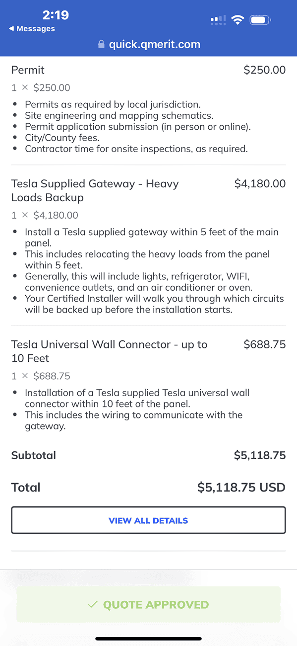

Mine was $6300. I am half a mile from the substation and I’d say I’ve had 4 outages in 16 years from 3-8hrs. Tough pill.

I wonder if there’s some royalty we are paying here’s my quote
my quote was exactly the same as your quote. I am in Honolulu. Description of work was word for word as your quote. I sent an email to the assigned electrician to ask about the $2,500 credit. It is not clear to me if the quote includes the price of the equipment or if this is just for the labor.
- I configured/ordered my Beast on 5/25/24.
