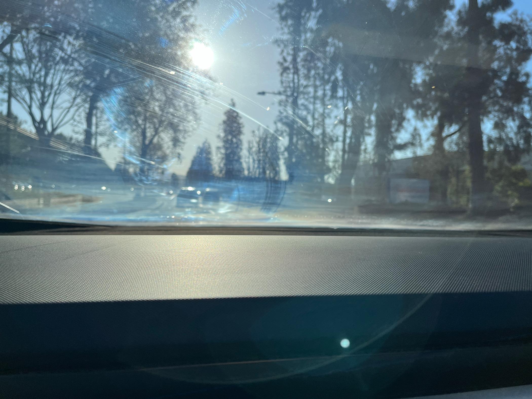

I found out the haze on the inside of the windshield is the result of the plastics in the dashboard off-gassing and sticking to the windshield, according to my tint professional. I noticed the haze would return one or two days after I cleaned the windshield so I asked. He said it will subside over time. It's common for dashboards and carpet in new cars to off-gas as the they heat up. His recommendation is a spray bottle containing purified water with 4-5 drops of baby shampoo. It's what they use to clean windows before a tint and what they use to lubricate and set the tint material.
I did not tint the windshield yet ($1200 was his quote for 3M Ceramic) but he said the solution works whether your windows are tinted or not. I made the solution and put it in a glass spray bottle from Target to keep in the CT. He's right; it works. It also doesn't evaporate too fast like Windex and any drips on the dash won't discolor anything because it's basically water.
Tesla Cybertruck Interior window cleaning recommendation (+ reason for the haze / hazy glass) 2024-04-11 07.56.29

Any vehicle will have the same problem. I think it is exaggerated by the slope of the windshield. In my experience, it never completely goes away (makes you wonder what we are breathing). You notice it more when it is colder and you are defrosting the windshield.​

thought it was just mine. Nice cake of residue even after cleaning it. Never had this issue this bad on the x and y

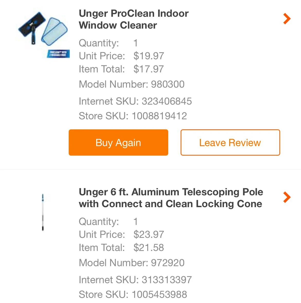

I picked these up at Home Depot to clean the inside of the windshield. Works well and reaches all the way to the bottom.
I got the exact same setup. I have tried a handful of different ones but this one worked the best.
