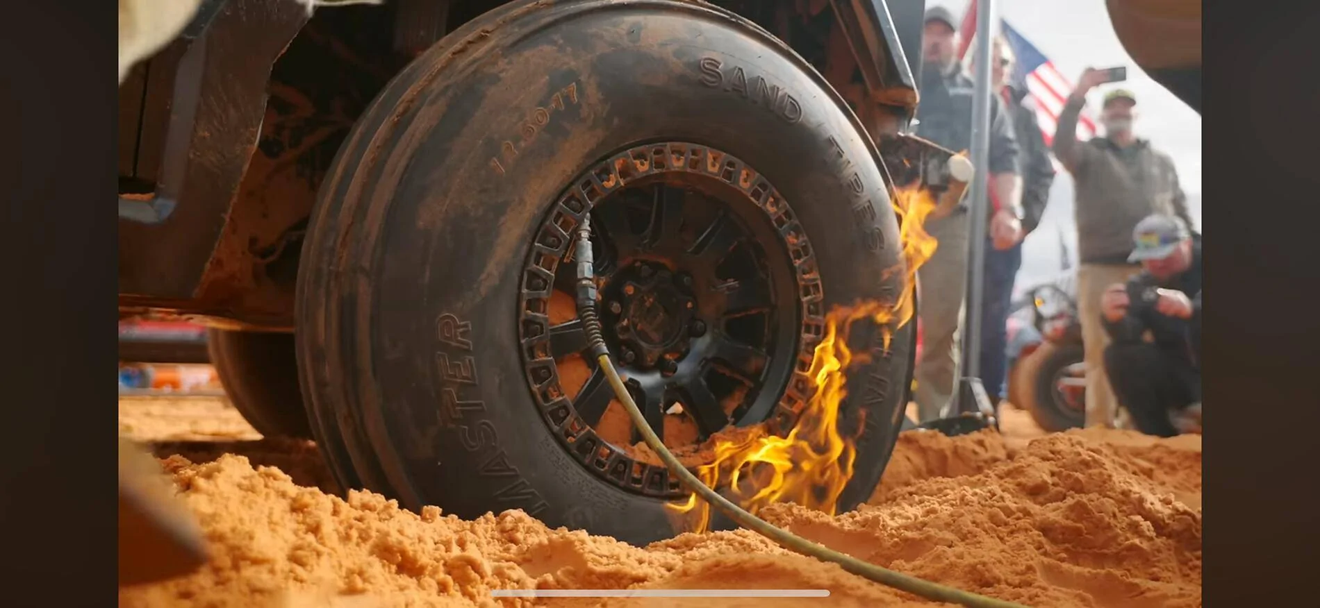

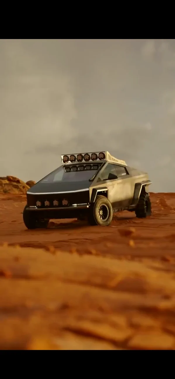

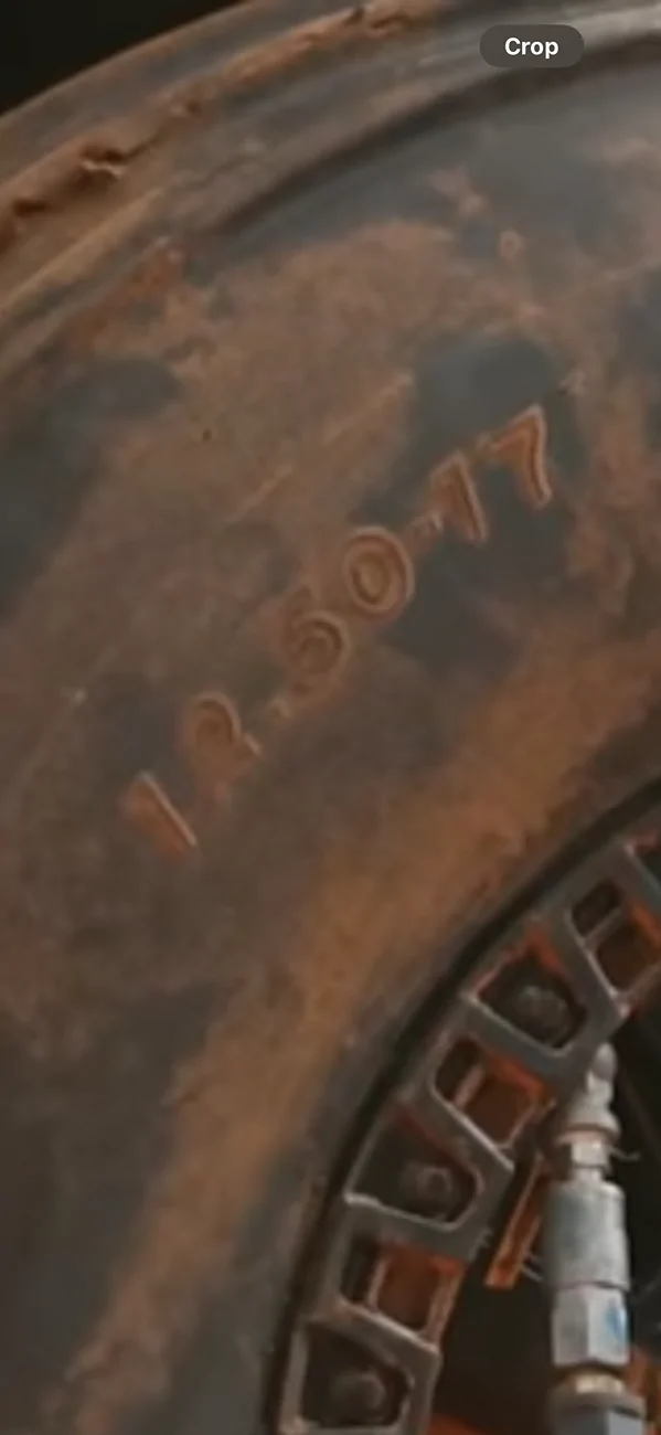

Does anyone have experience mounting 17" wheels on the cybertruck? I've put 18s on mine and it looks like you cant go any smaller, but i noticed SupercarRon seems to have 17s on his . The tires are also 37.5" . Not sure if these wheels fit right on or he swapped in smaller calipers, or grinded away material from the calipers.

You'll need new brakes and possibly rotors. The truck you referenced is heavily modified.
18" is supported according to the off-road guide by Tesla. But 17" is not mentioned.
