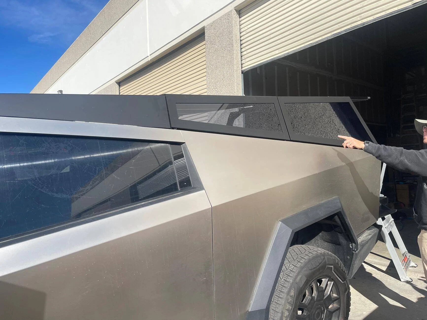

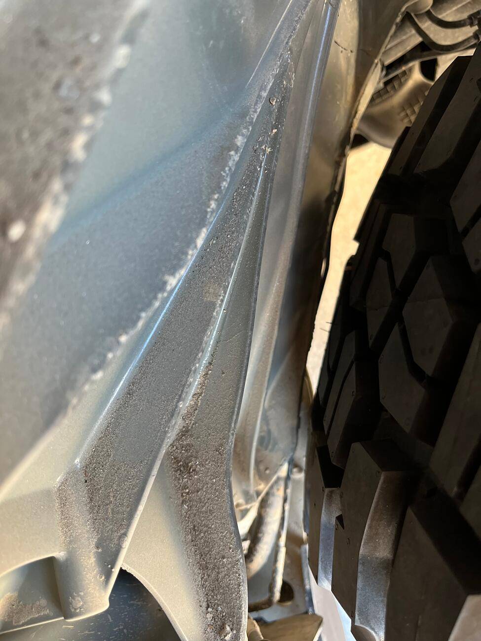

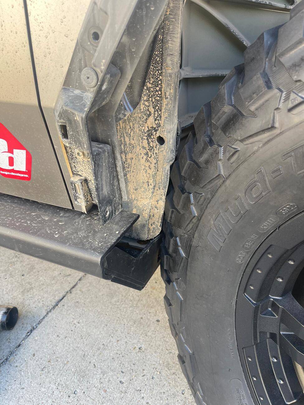

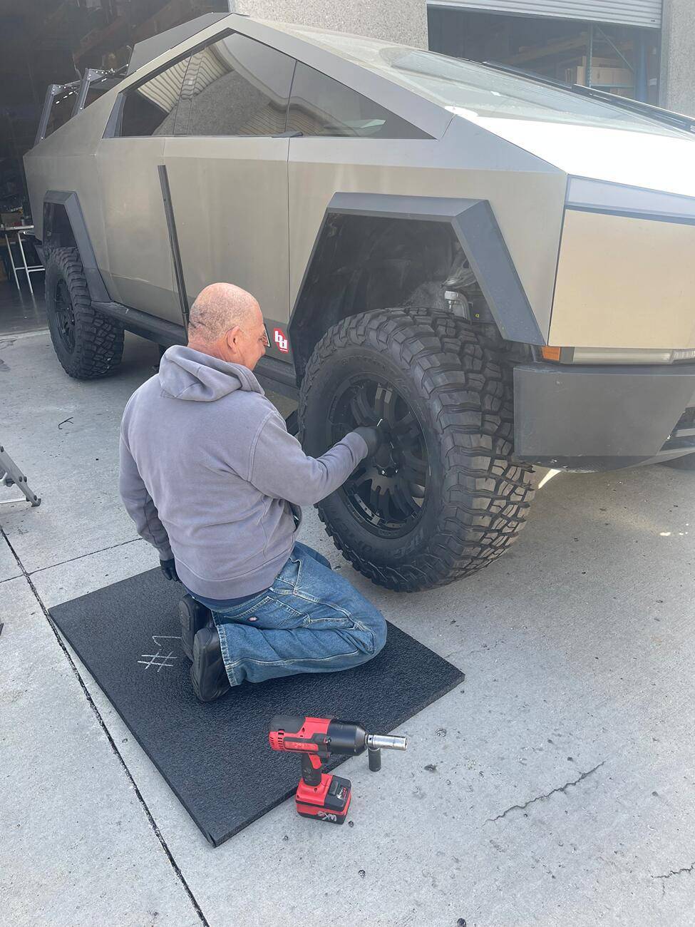

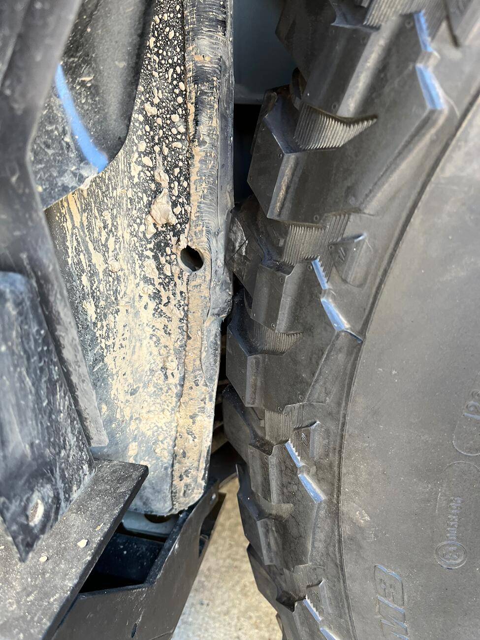

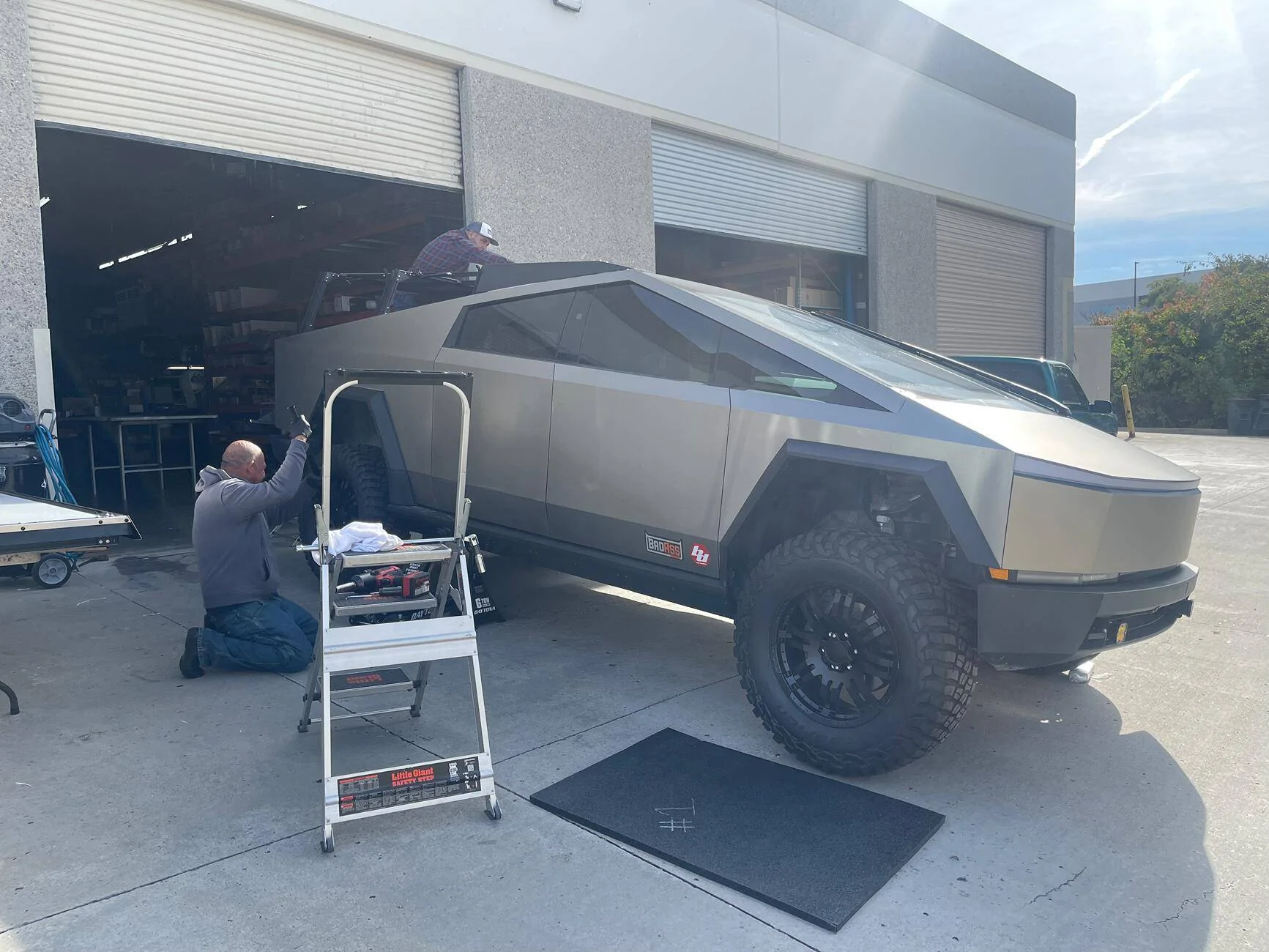

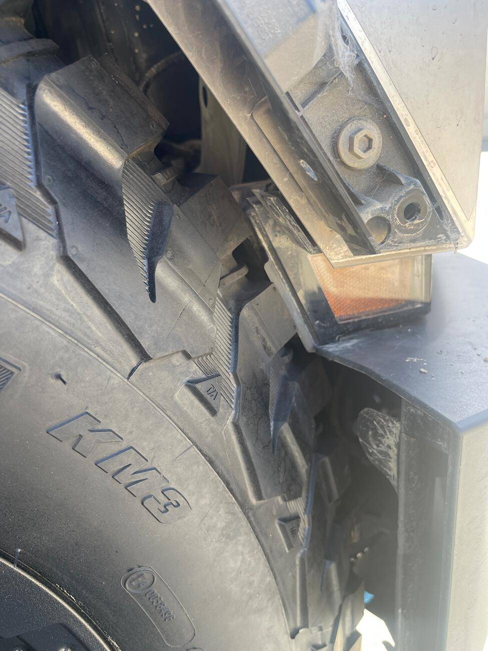

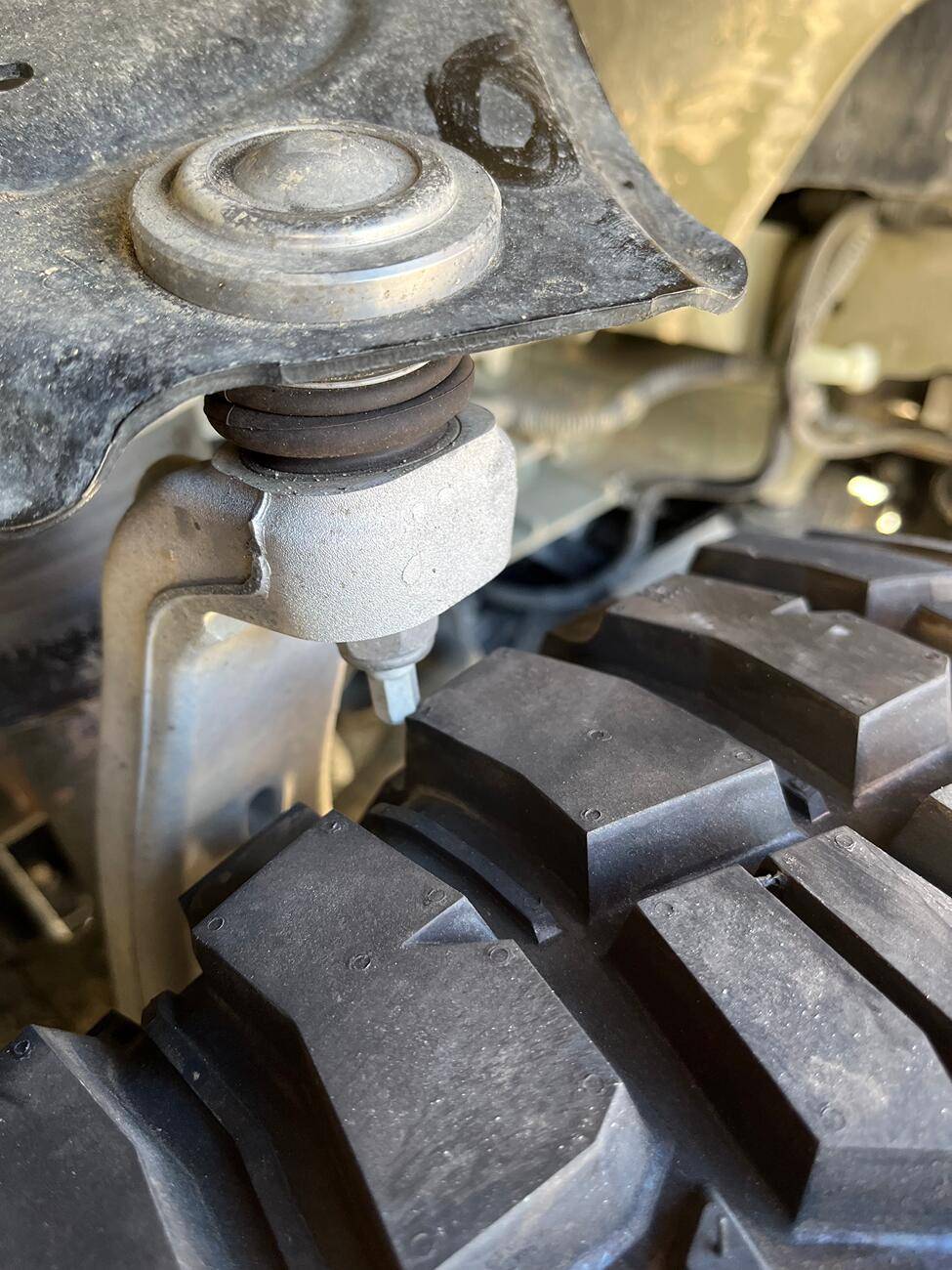

All,
As much as we wanted this to be this simple for our LA Auto show truck with BFG KM3 Mud Terrains, it is not a simple front bumper trim! Hate to say the video may not be complete for all tires and requires much more work to make work with KM3's..
For specifics, we used 20" rims with 1" offset + 1.5" spacers and 37" BFG K03 mud terrains. Looked like it was going to be badass, till it wasn't... and this was after we trimmed the front fender like the video...
Pic 1 - swap tires​
pic 2 - in high mode w/ lift rods​
Pic 3 - inner fender removed, rubbing welded part of the frame. Could be bent back or trimmed, but not everybody​
Pic 4 - going to rub out the corner lights​
Pic 5 - bed cap with windows teaser​
Pic 6 - removed spacers, will rub the adjuster bolt​
Pic 7 - looks like it will rub the frame webbing​
Pic 8 - removed spacers - still rubs the frame, though less mod needed​
Pic 9 - Tire specs on width and height.​
In our opinion, we also owned a Land Rover service shop for 25 years, to make the 37's work on the Cyber, you need a narrower front bumper w/ lights moved forward, replace control arms front and bottom, moving wheel forward 13mm w/ 54mm lift. Not a cheap or easy project. But we have been wrong before...​
@oldspice can you please share what tires you used and final pics trimming and can you drive the car without tearing off the front bumper, lights and rubbing the frame in entry and high mode?
Hope that helps everybody before you order tires and start trimming thinking this is easy...

Thank you for the update and being so honest and informative on this build .
