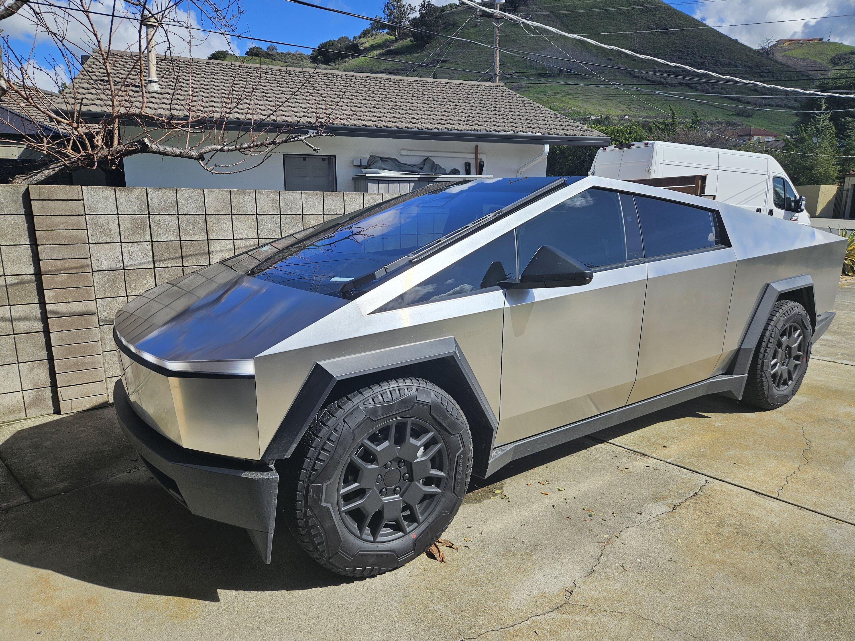

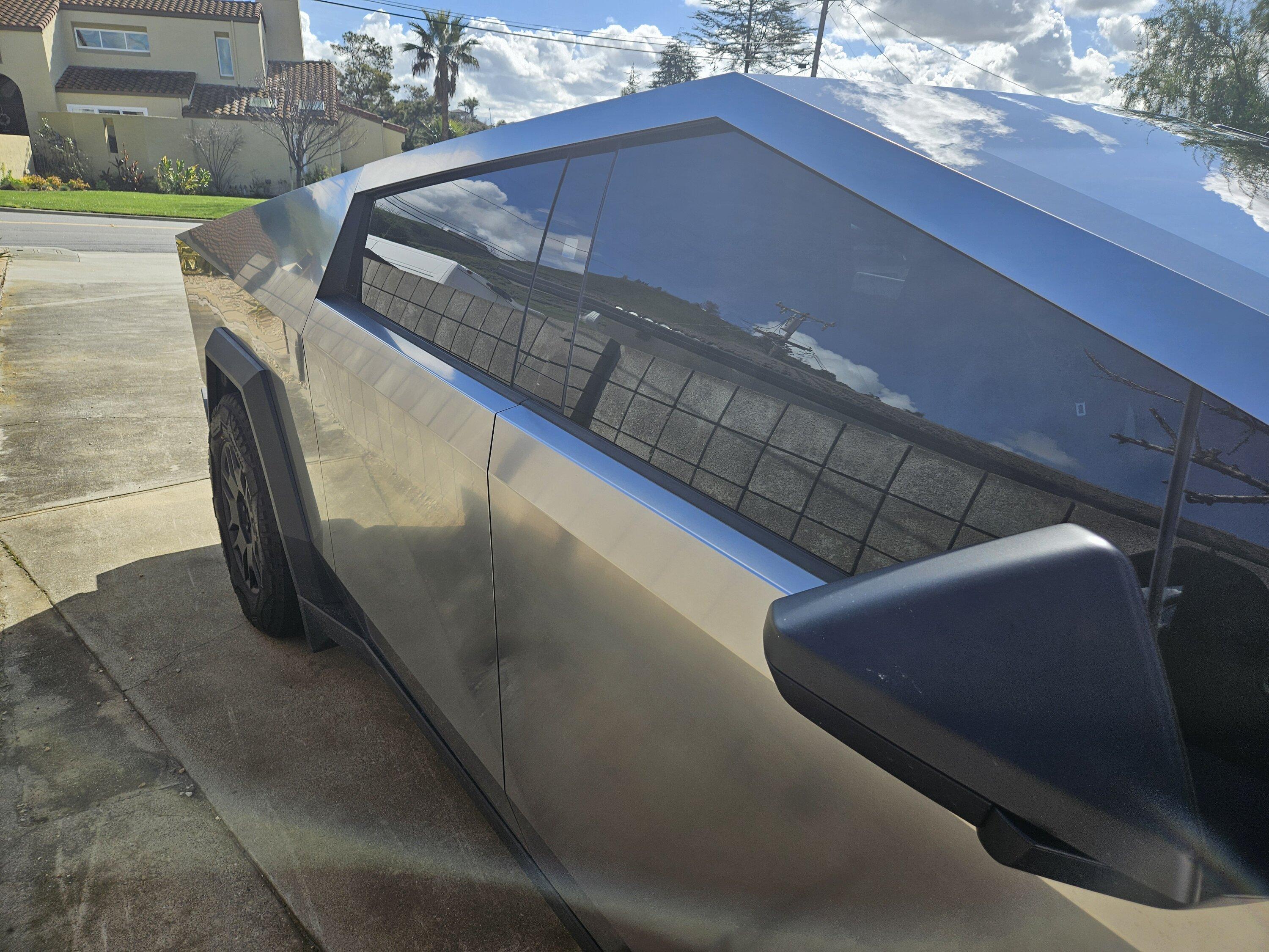

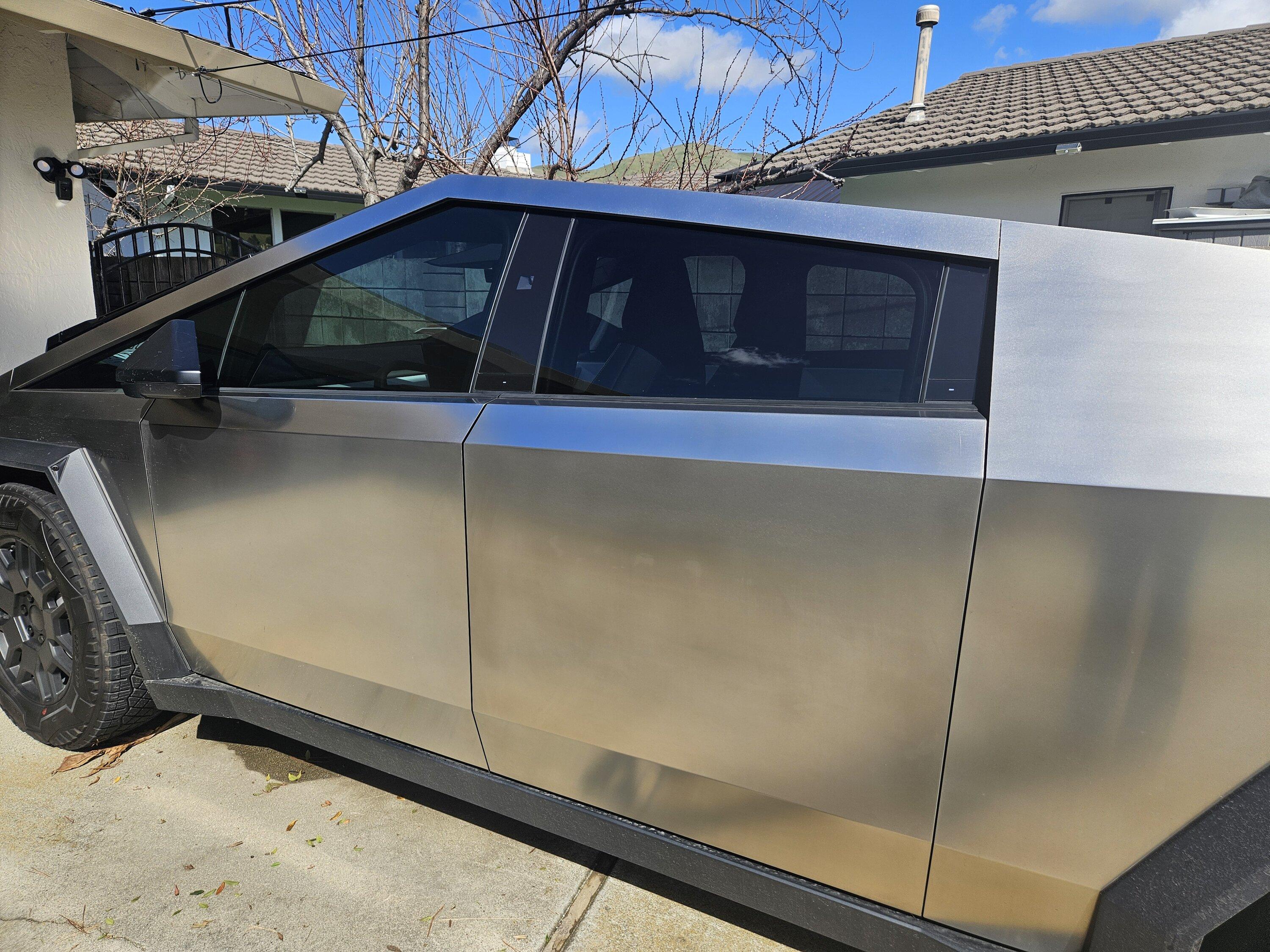

After obsessing about tint choice and finding only a few good photos and videos, maybe this will help some.
Went with 3M ceramic IR 25 on the fronts yesterday. Last minute change from the Crystalline 20, which I was worried would be too dark... Anyway, I'm happy. Wanted a close match to the rears, and not quite so dark I'm getting hassled by the cops. Shapes and movement are visible, but no features. Planning crystalline 70 on the windshield, but needed to special order the material and come back.
$200 fronts, $700 windshield, CA bay area.

Well it LOOKS really good.
Two questions.
1 Do you notice much difference at night with visibility?
2 Notice any heat difference? Lot of "cybertruck is a solar oven and 115 degrees" posts out there
Like how that setup makes the front and back a pretty close match to my eye

Looks like 20% may have been more matching? Front looks bit lighter
Maybe. It's close, and part of it is that the front is much brighter due to the ginormous windshield, vs closed vault. I also think even the 70% windshield tint will knock it down a bit. But yeah it seems lighter than the back from outside in most situations, but I'm ok with that given CA tint laws...

In anything but bright sunlight, 20% front and 50% over the died windows is pretty much exact match in my eyes as a tint dork. Totally uniform needs tint on the windshield

I've been Tinting windows on cars for a daily gig for 35+ years. It's funny this guy posts that 35% is a decent match to the rear. It's DECENT at best. So the rear factory privacy glass meters at 23/24%. The front doors is 72% green glass. If you want the closest match you will need to go to each manufacturers website and look at the "off the roll" % number. Some companies films are called what they are like 32% and some are called 30% but off the roll may be 33%. In Florida here the legal limit for the two front doors is 28% but there is a 3% meter tolerance so they can net down to 25% without getting a ticket. I put 30% on front doors and they are usually 4-5% lighter than the rear. If you put 20% on the fronts, they will meter at about 17% which is about 5% darker than the rear which looks terrible. I just did a Cybertruck last week with 30% and the customer was extremely happy with the match
