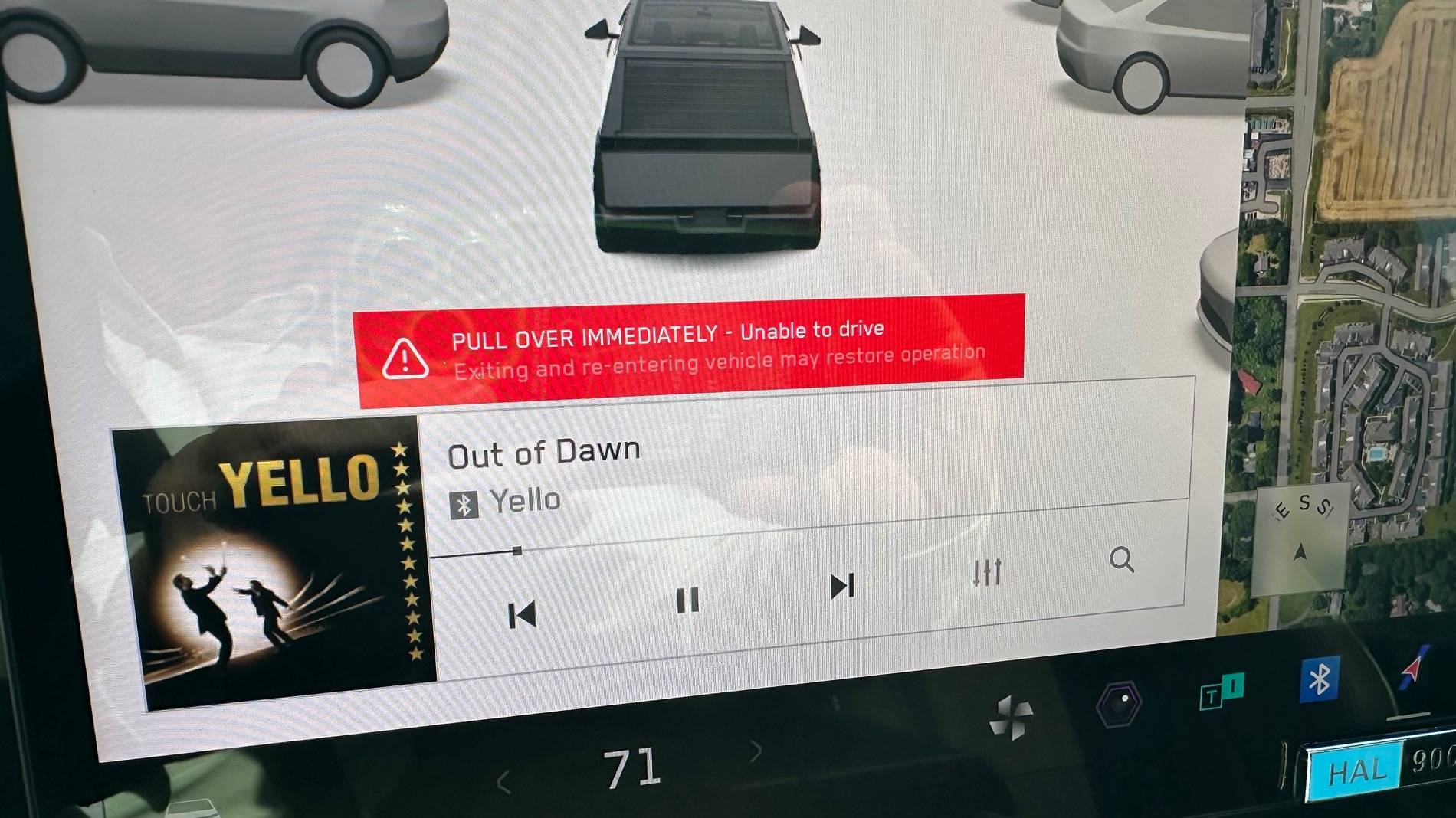

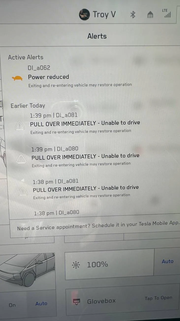

Well I picked up my Cyberbeast yesterday at 11am and today at noon I get this. Dead being picked up by flatbed.
This fix is in. Yep they fixed it. It was a partially cut wire and a smashed wire somewhere near the throttle pedal they said. Said that the pedal has redundancy and since one two if the wires where smashed and partially open it thought it was a fault. I saw the photos. My beast is home and running great.
