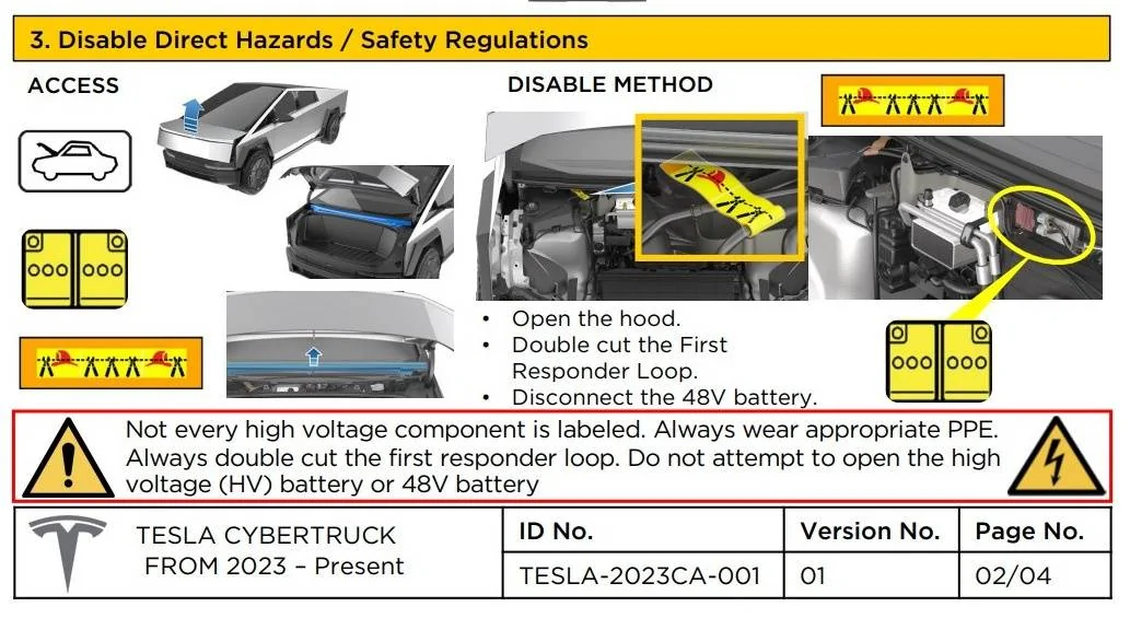

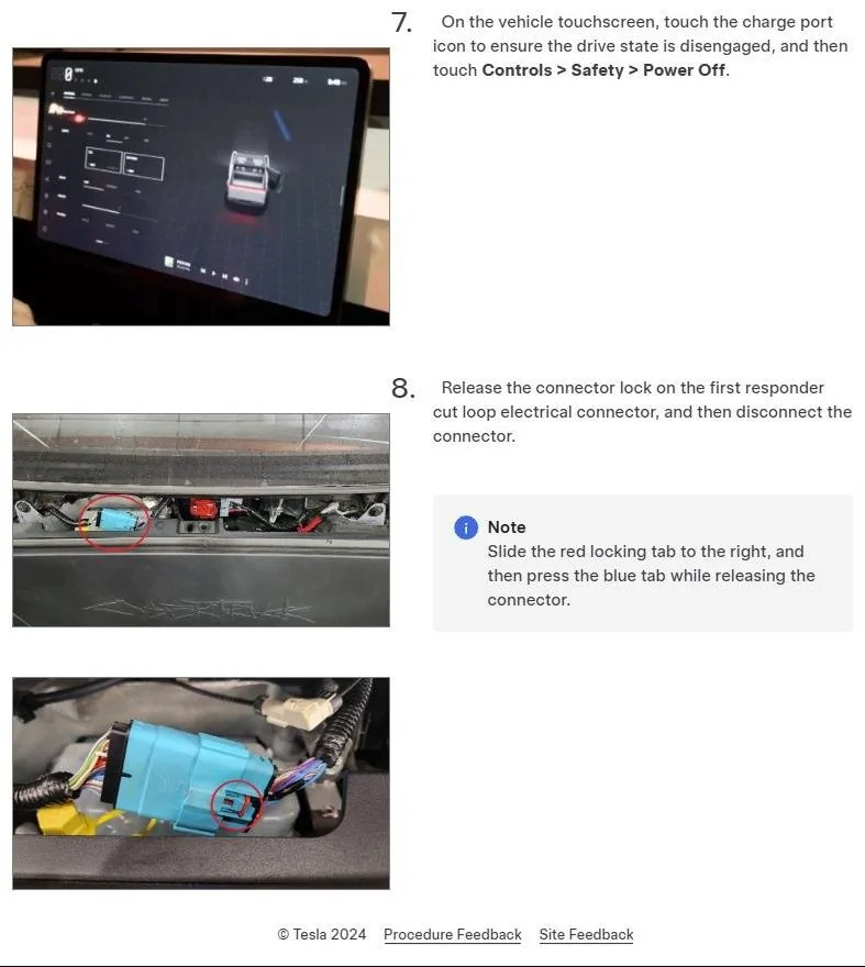

[UPDATE-BEGIN]: I would assume that the MV/48v would disconnect the HV contact too.
Service doc show disconnecting the first responders loop.
Tesla Cybertruck Dead Cyberbeast 2Iar4aQ
https://service.tesla.com/docs/Cybe...UID-A399E8AE-5DCF-4095-91FA-AF0148503F3B.html
[UPDATE-END]
Here is the only place I could find the Cybertruck First Responder loop mentioned:
https://digitalassets.tesla.com/tesla-contents/image/upload/Cybertruck-Rescue-Sheet.pdf
