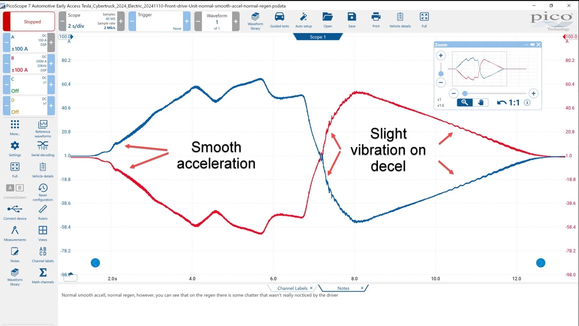

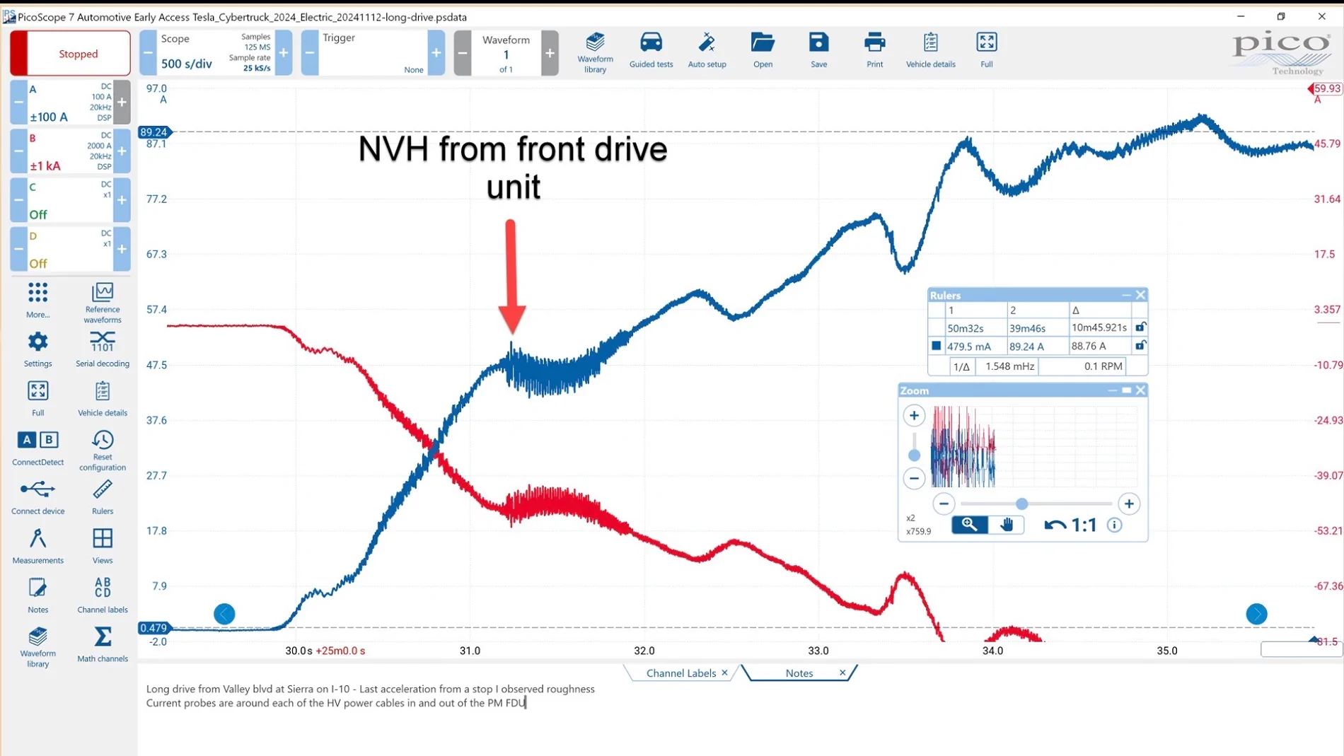

Can you share more about what you are experiencing? I had a problem with my vehicle. Intermittent roughness leaving stops. I used my Picoscope and current probes to record any abnormalities and I did capture correlation. I shared that with them and a month or two later the problem was resolved. I believe that the issue was related to phase angle.
Additionally. Has Tesla checked the drive unit oil level? I read service docs that talk about this and if low, they are to top it off and log this info in their system. It’s possible for a low oil condition due to assuming line calibration errors.

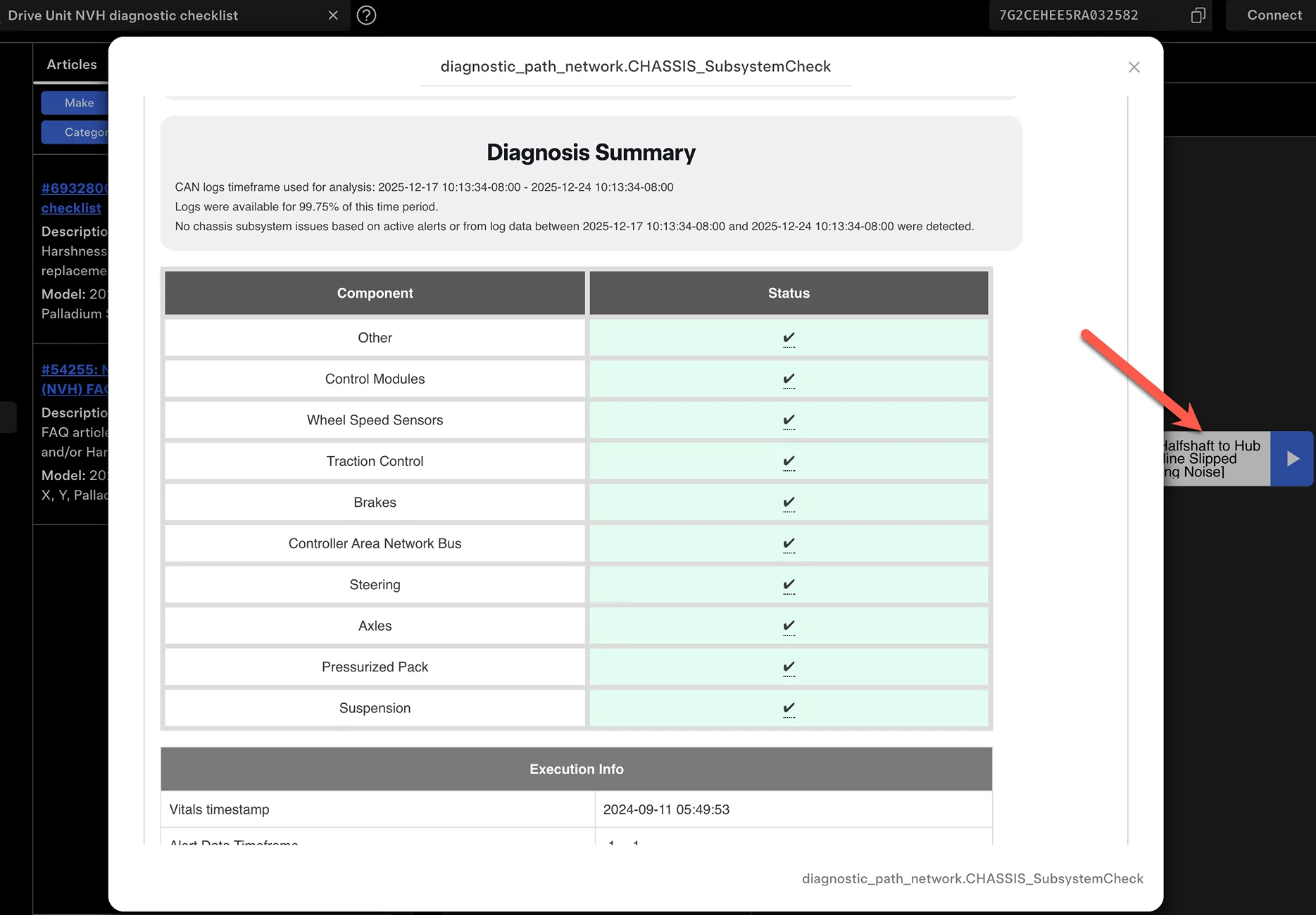

Do you know if they inspected the drive half-shafts and the mating surfaces of the front hubs?
If you'd like, I can remote into your vehicle and run a test that would look over a specific time period at conditions that could help identify an issue. The reports would look something like this:
Tesla Cybertruck Dead truck. 1766603161221-49
PM me your VIN and email and I'll perform an owner authorization request to gain remote access. Provide a date/time period that you observed the vibration and as long as it has occurred within the preceding 30 days we can examine the logs.
