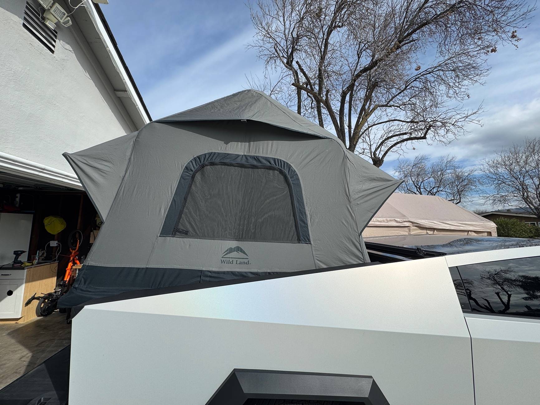

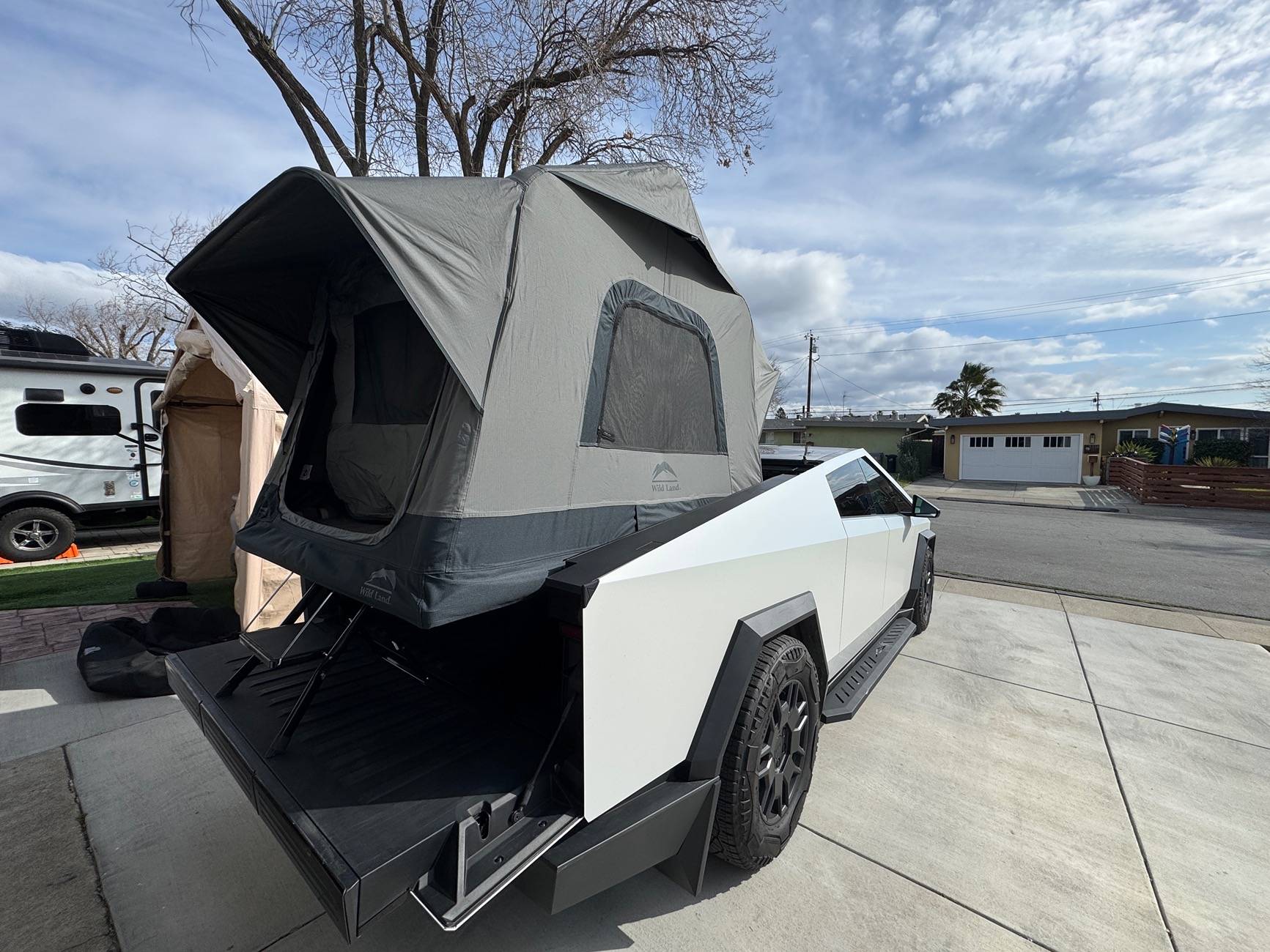

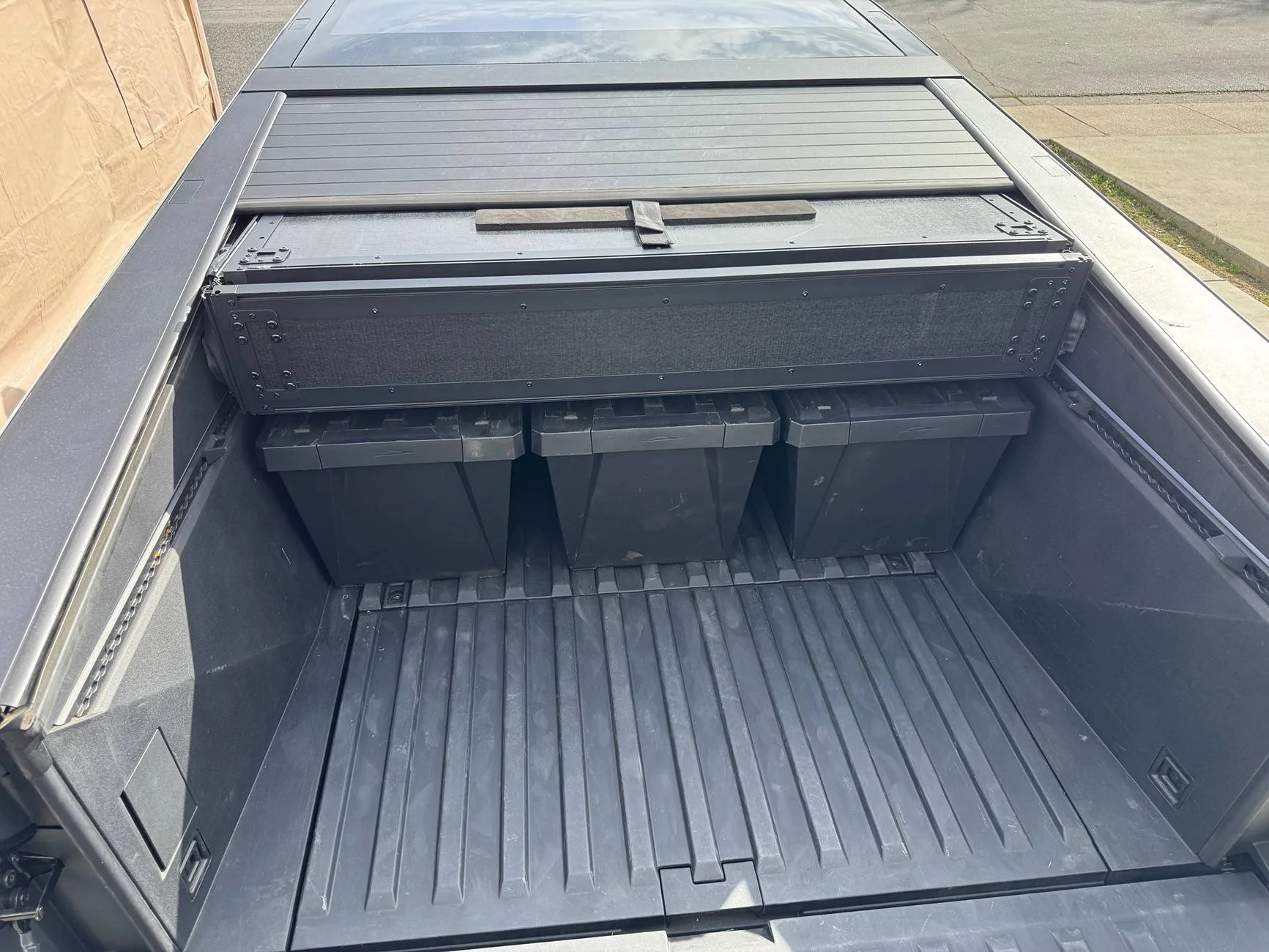

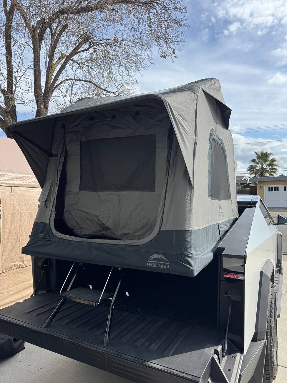

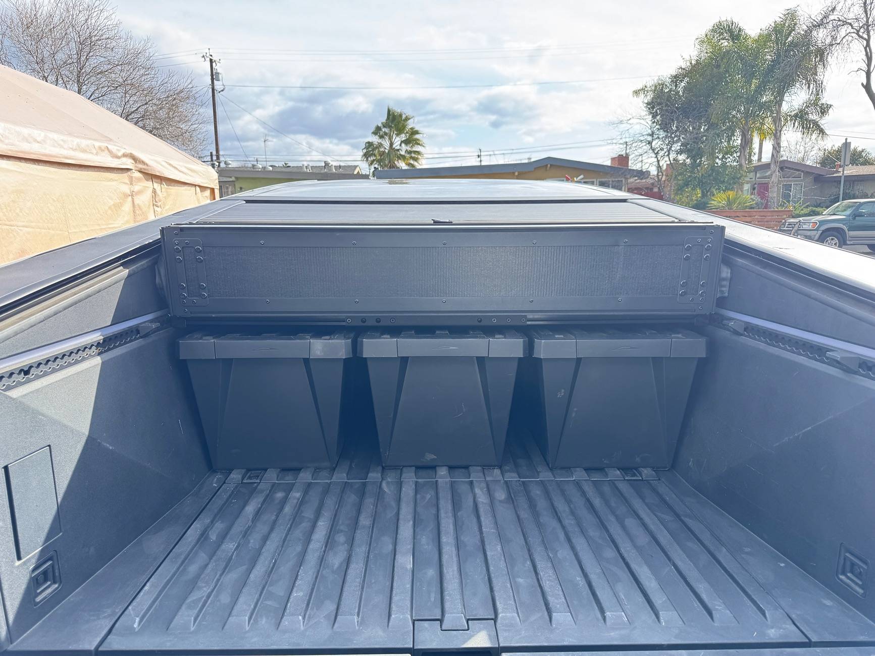

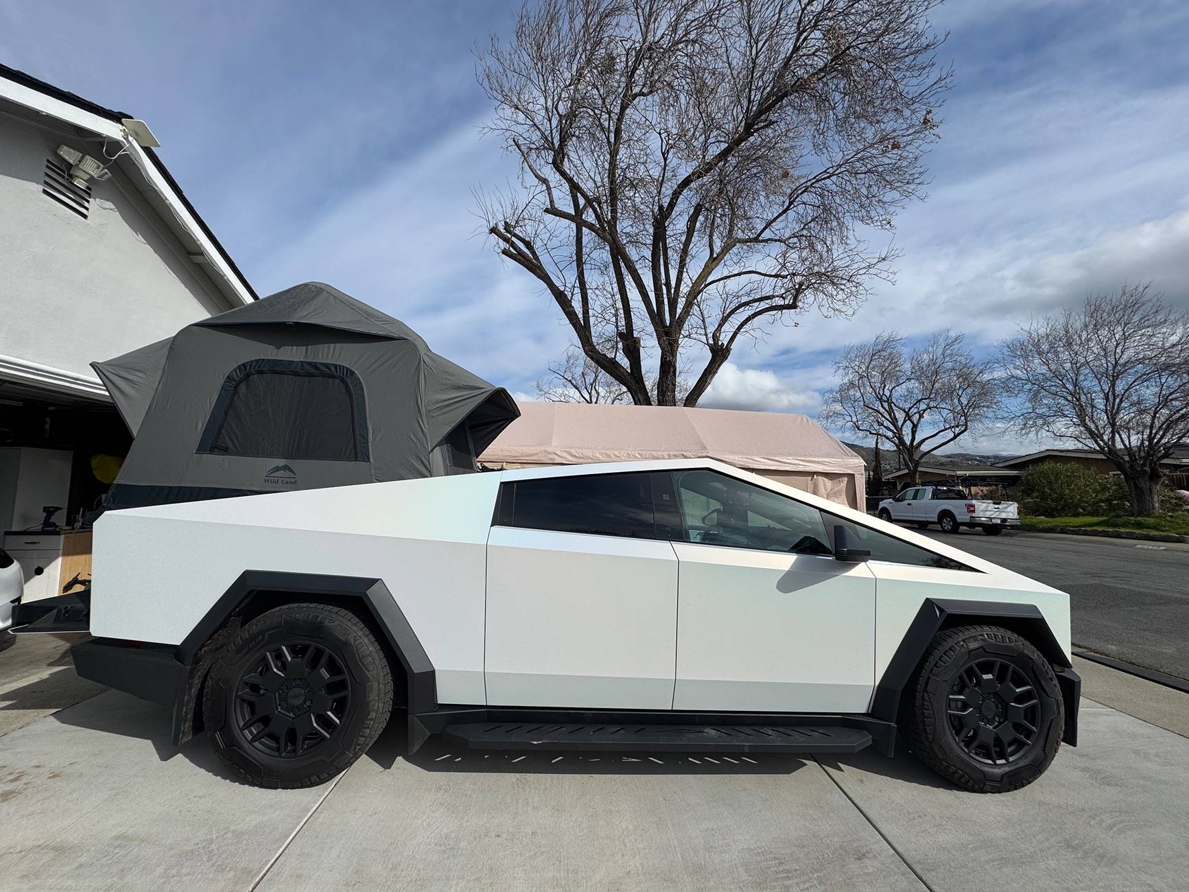

I used to mount my RTT on top of truck. But my RTT (Air Cruiser) is too thick. The wind resistance is too much. I lost 30% more electric. (400 wh/mile to 520 wh/mile)
So I am thinking mount the RTT in truck bed. It should reduce wind resistance much more than put it on top.

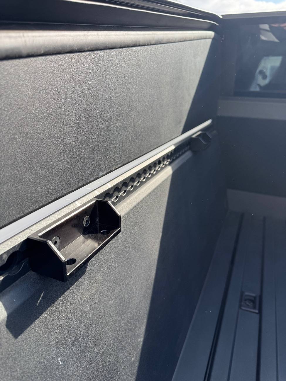

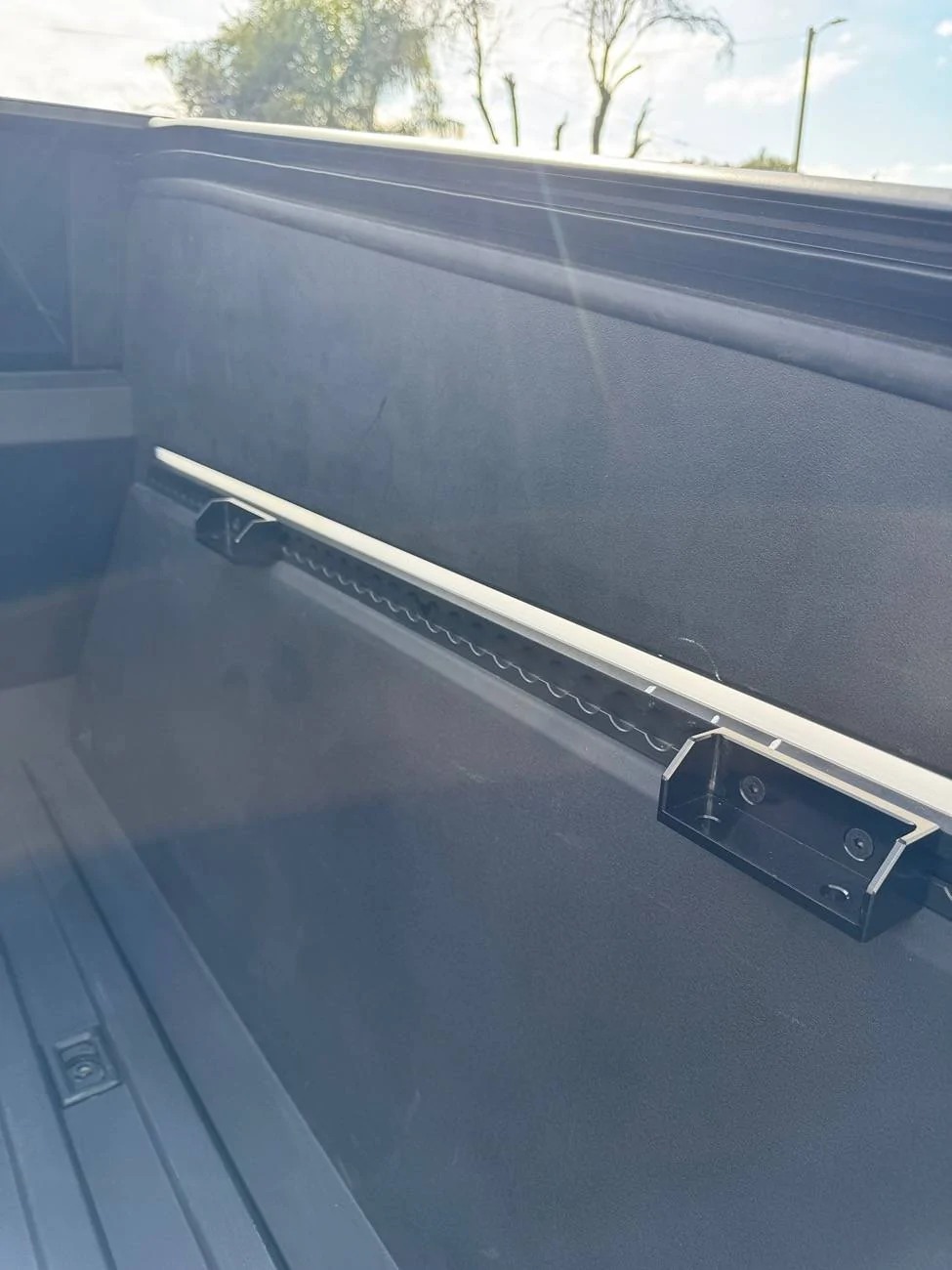

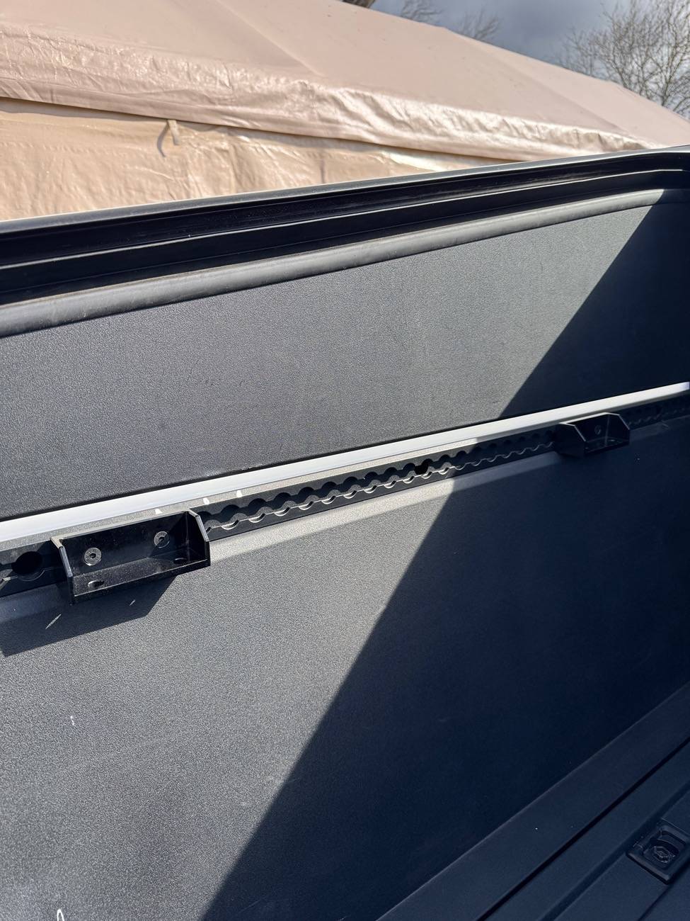

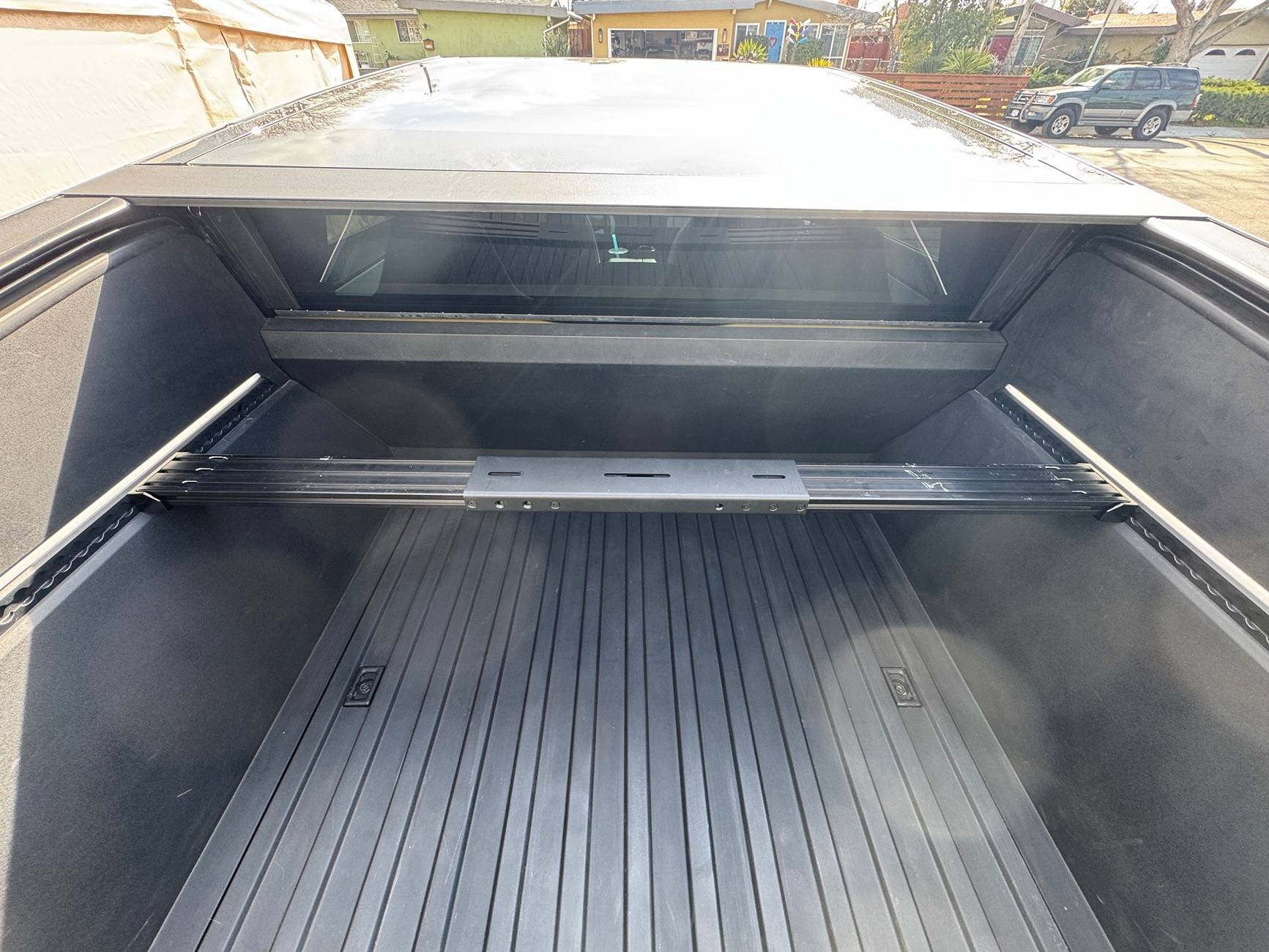

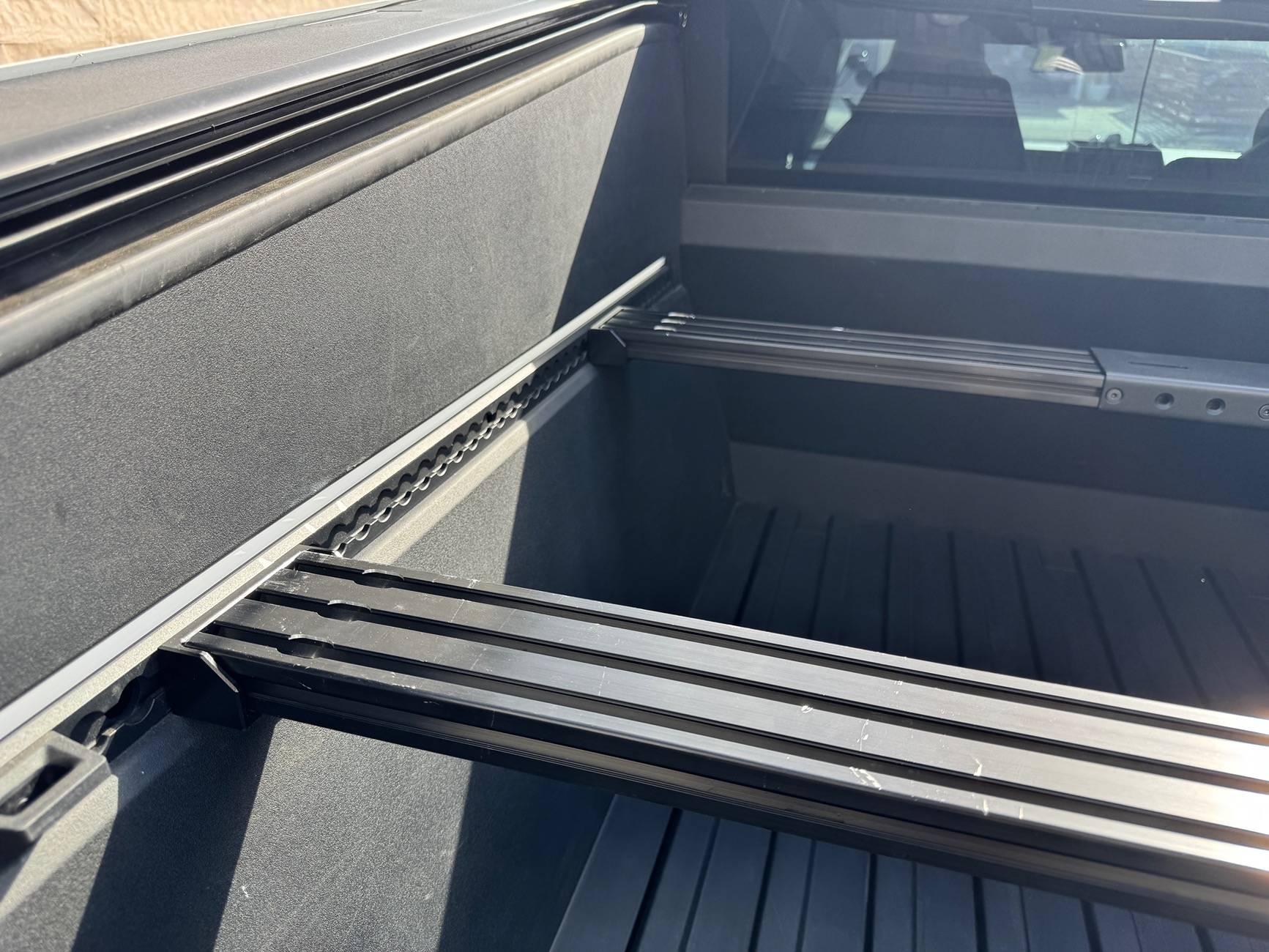

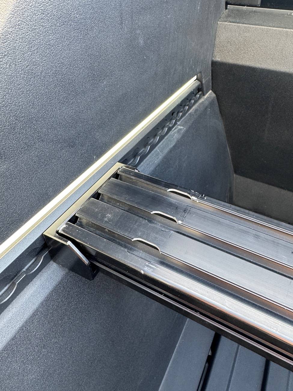

Thanks @Mars Adventure Gear. They have new product - Truck Bed Mount. Then I can mount my RTT in truck bed now.
https://marsag.co/products/truck-bed-mount-for-mars-expedition-adjustable-crossbars

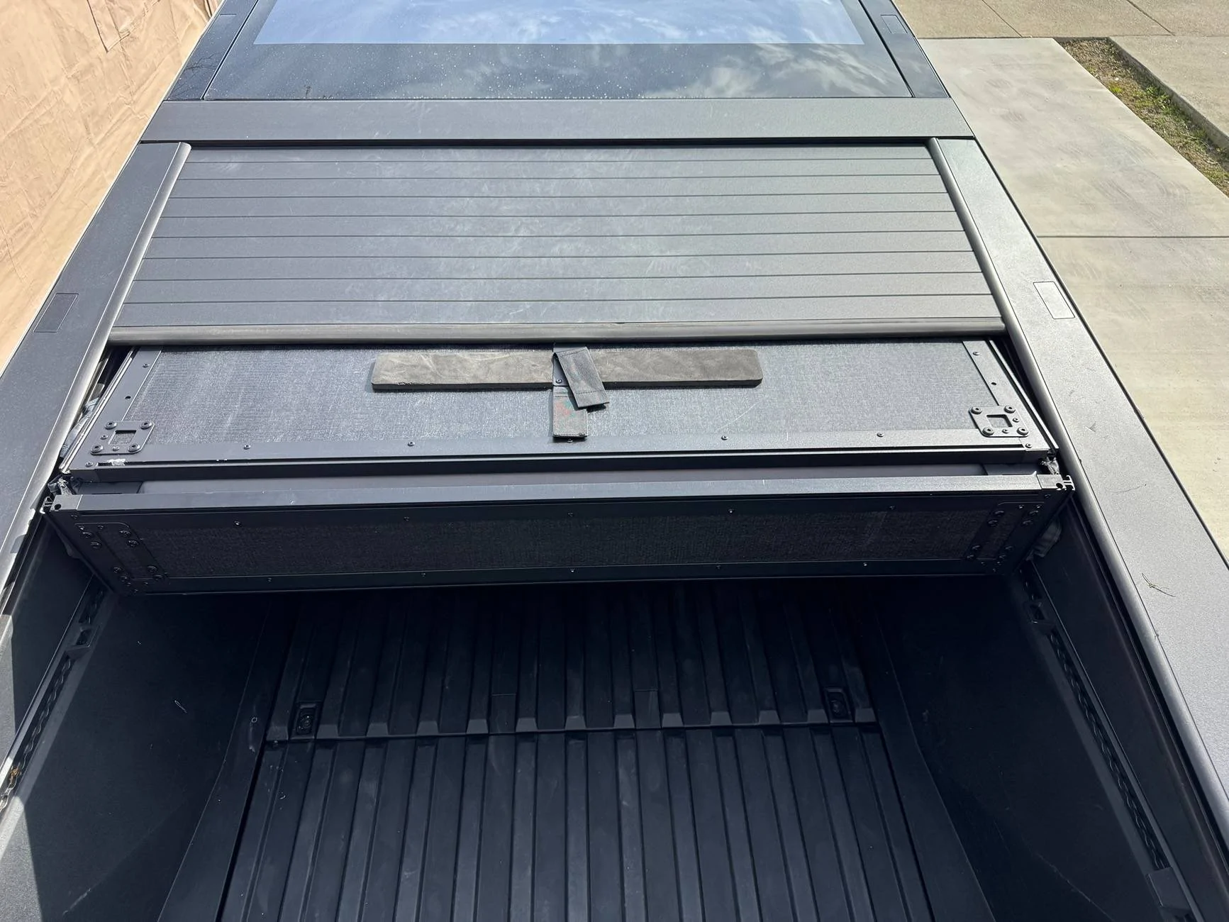

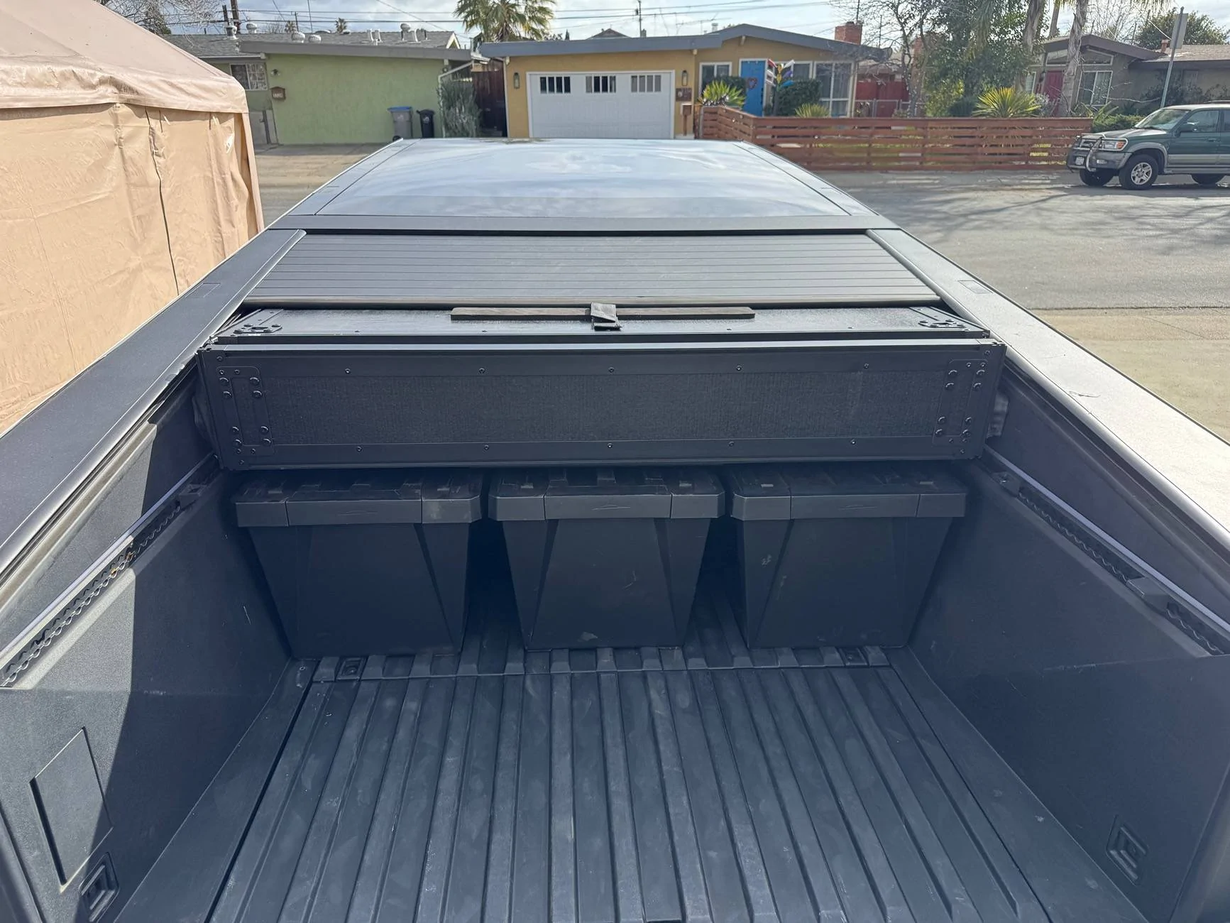

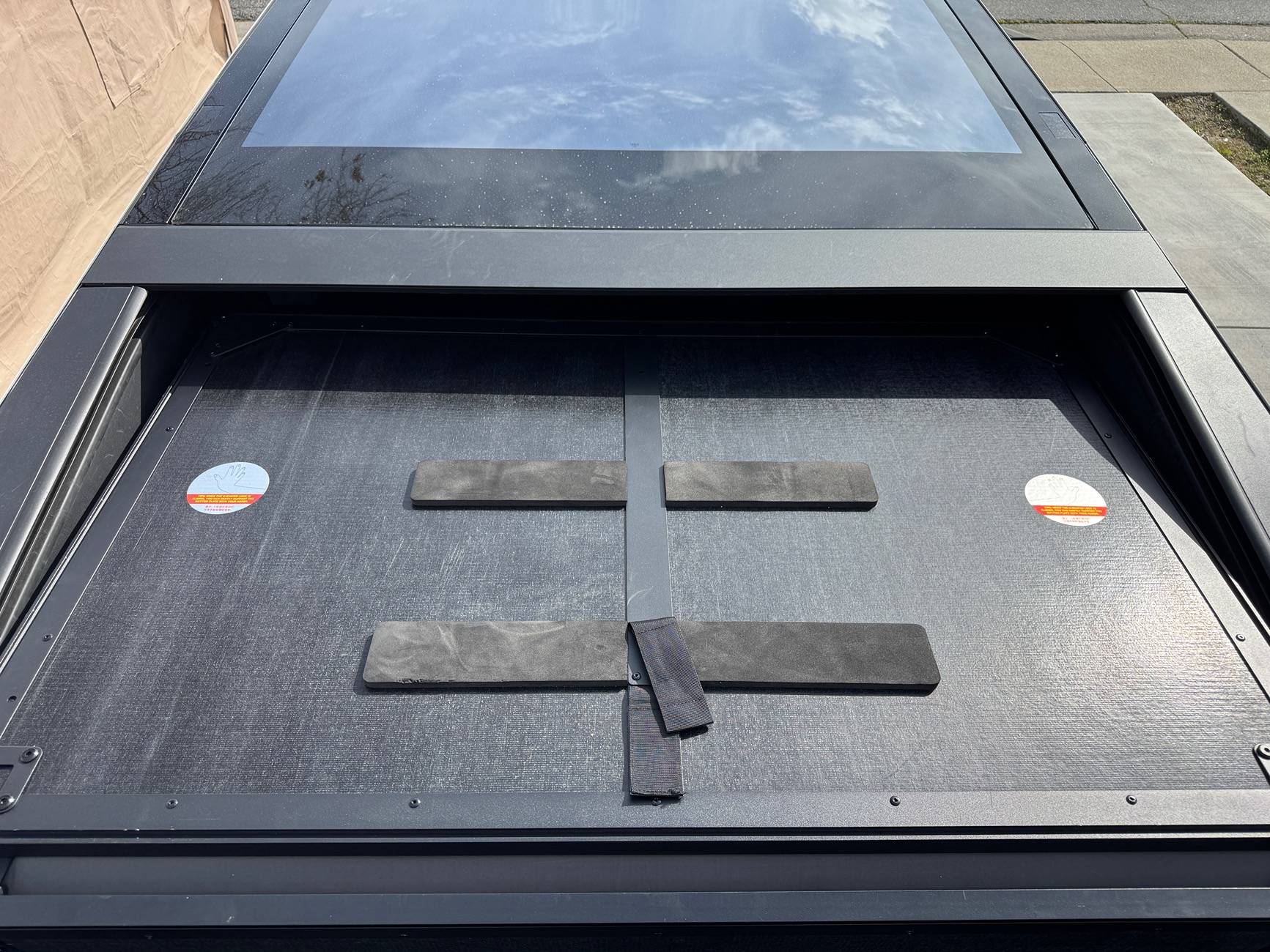

The drawback is. My RTT is too thick. The tonneau cover cannot close completely. If you have thiner RTT, maybe it is closable.
I just set it up. Not do road trip yet. Will update the result of electric usage later.

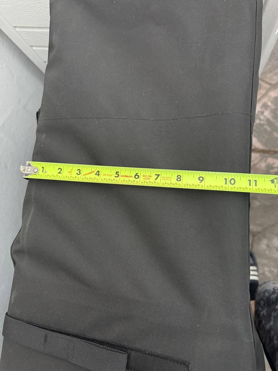

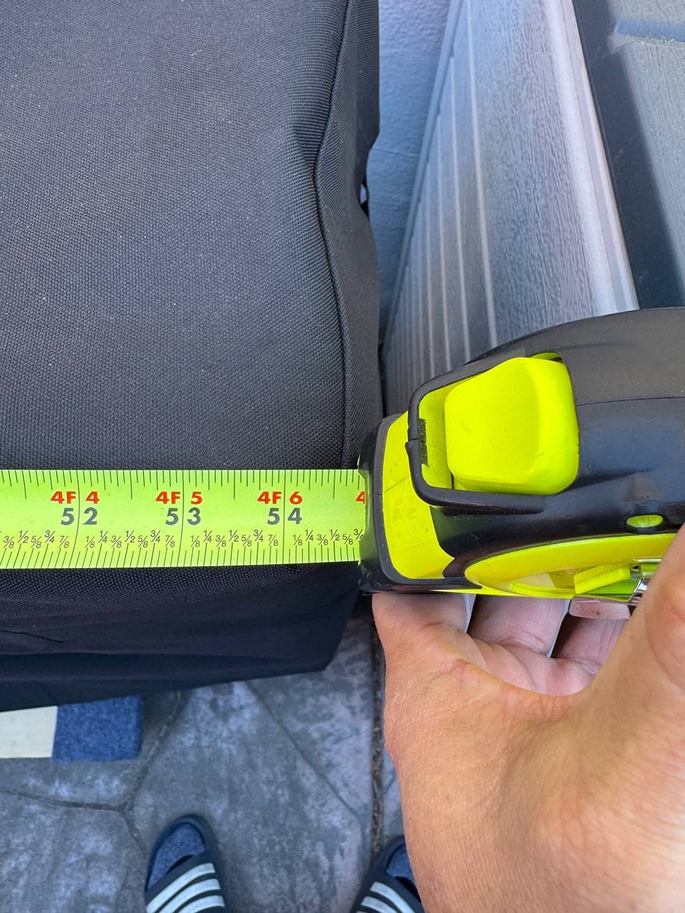

The tent width is 54 3/4."
Not 39". Because I turn 90 degrees makes tent door face to tail gate.
Tesla Cybertruck Cyber Tent Style - Using RTT mounted in truck bed IMG_2781.JPG
This is Cyber Tent width (57")
Tesla Cybertruck Cyber Tent Style - Using RTT mounted in truck bed IMG_2782.JPG

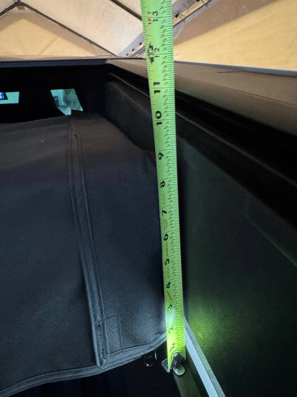

Air Cruiser's height is 11"

Air Cruiser length is 39" (folded)
