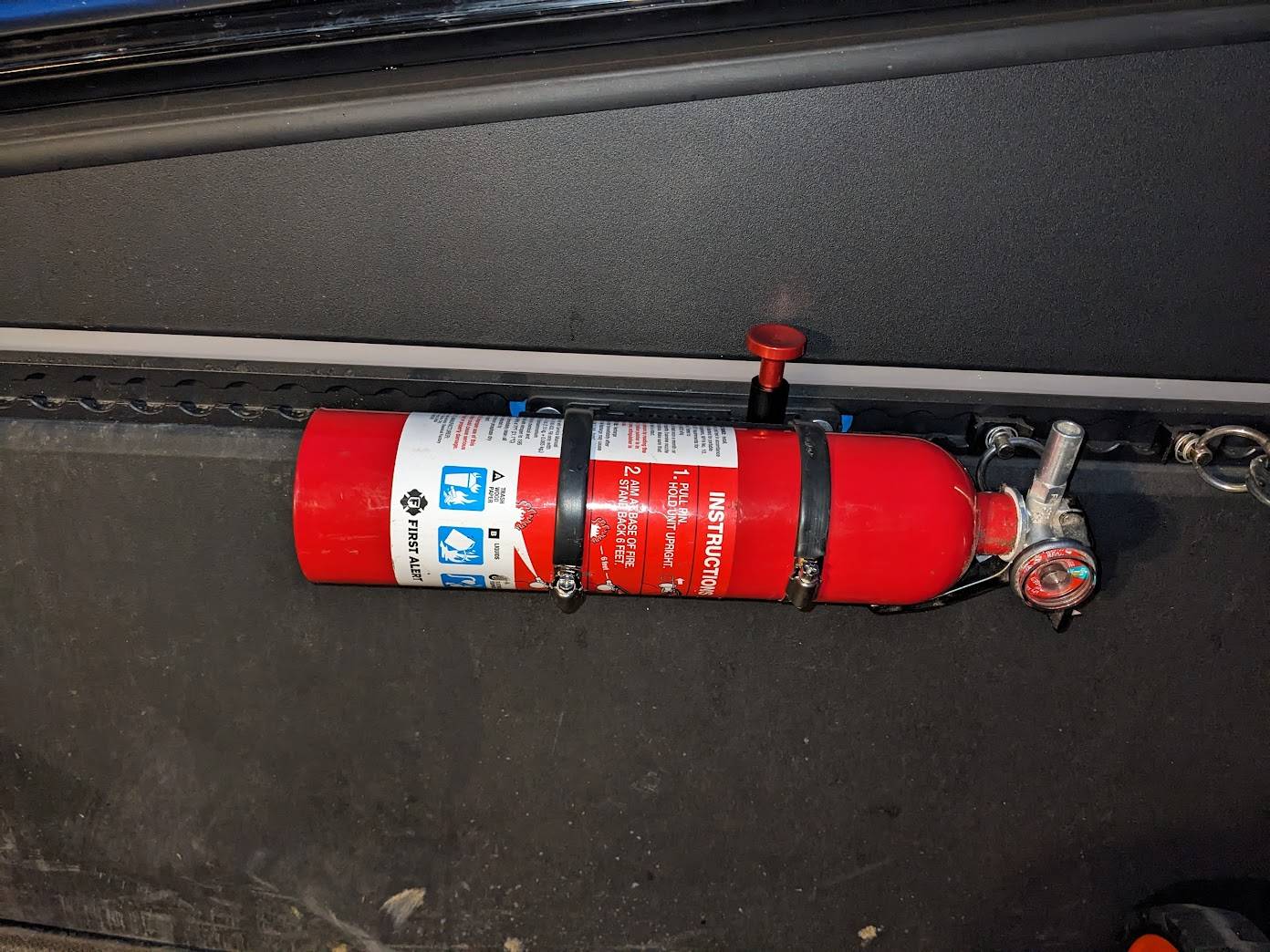

I want to mount a fire extinguisher in the bed, and decided to use a quick detach mount like this :
https://www.amazon.com/dp/B0DB1XX27K?ref=ppx_yo2ov_dt_b_fed_asin_title&th=1

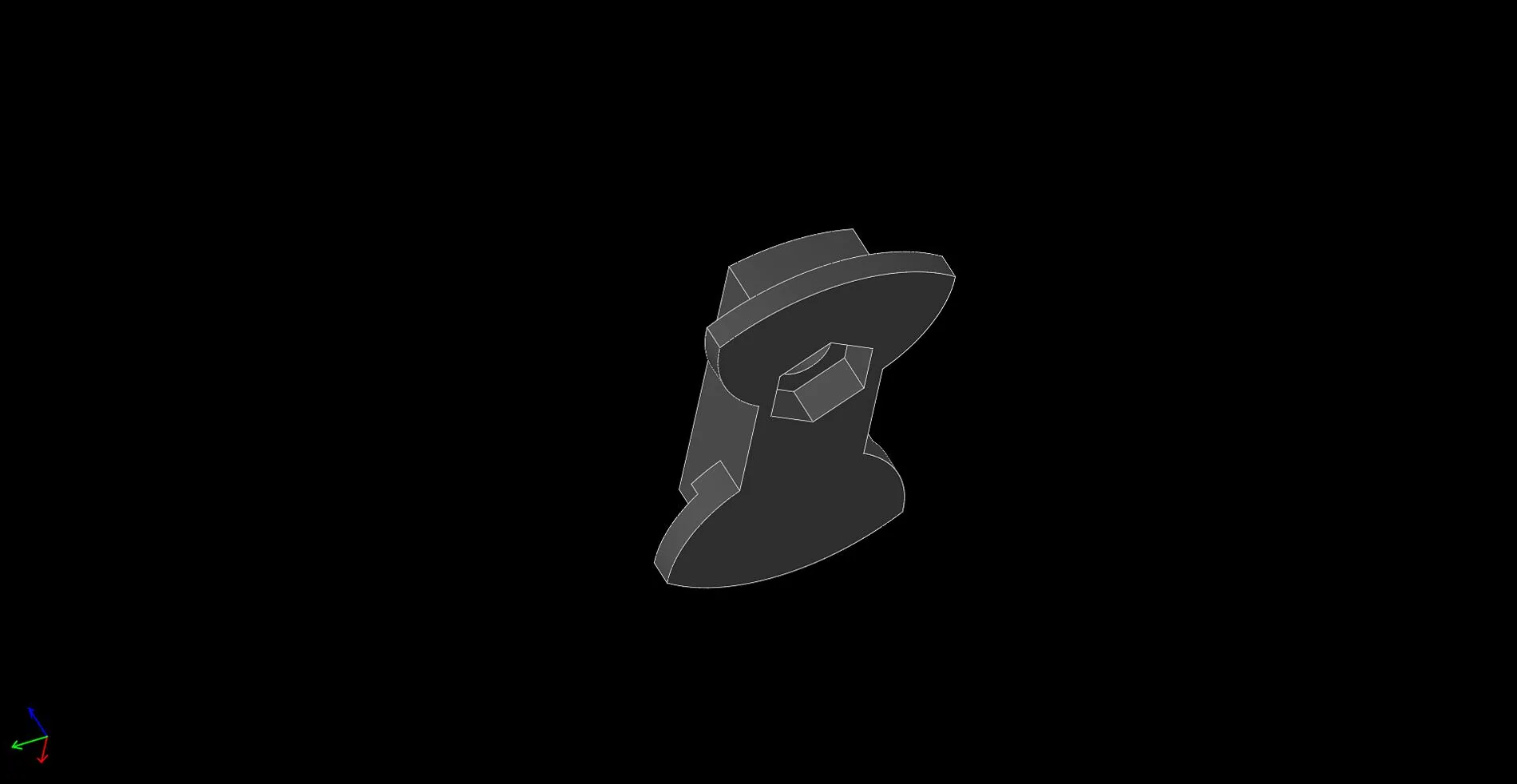

I was then looking at different bolt-style accessories for L-Track for light duty applications and didn't find anything I liked, so I sketched up this part that can be screwed into with the screws similar to those found on PC fans. The hole is currently 5mm, but I can make changes to that easily if anyone needs a different variant, including with a recessed hex pocket for a metal nut.
As for the fire extinguisher mount above, the holes unfortunately don't line up to the L-track spacing. Will need to make an adapter plate.
Tesla Cybertruck L-Track Nut (3D print w/ STL file) ltrack_nut
STL file attached.

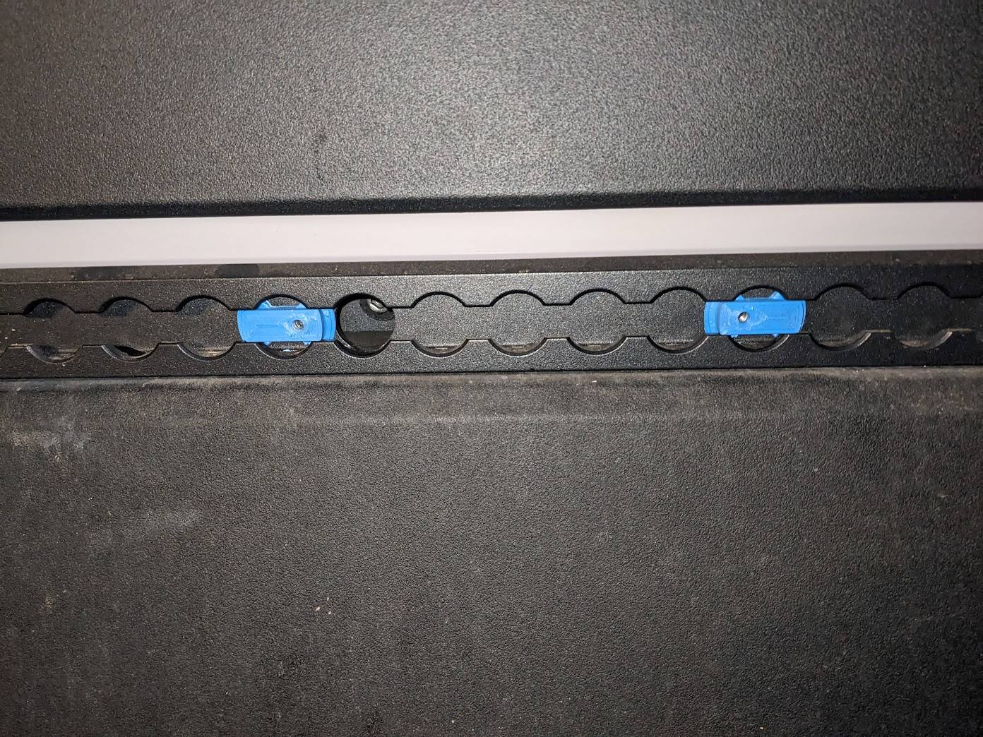

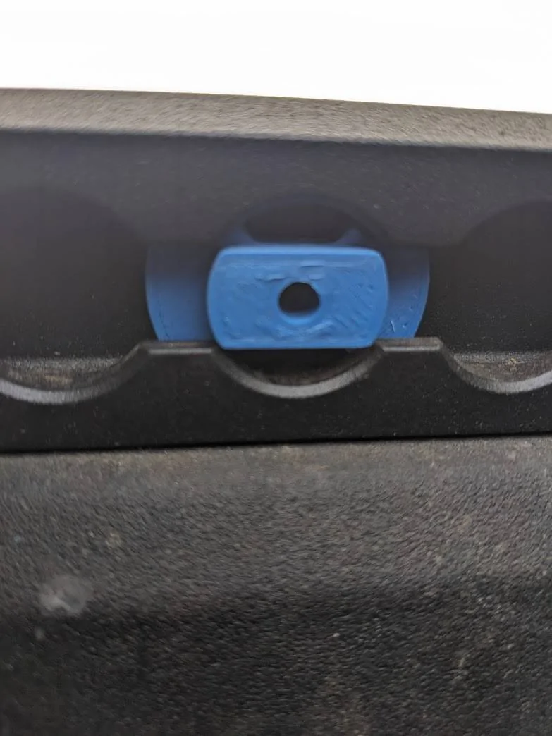

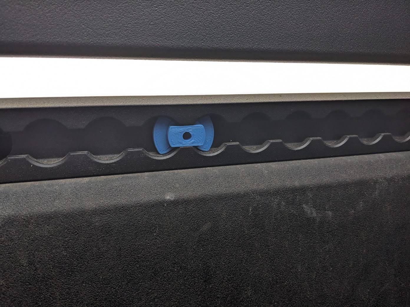

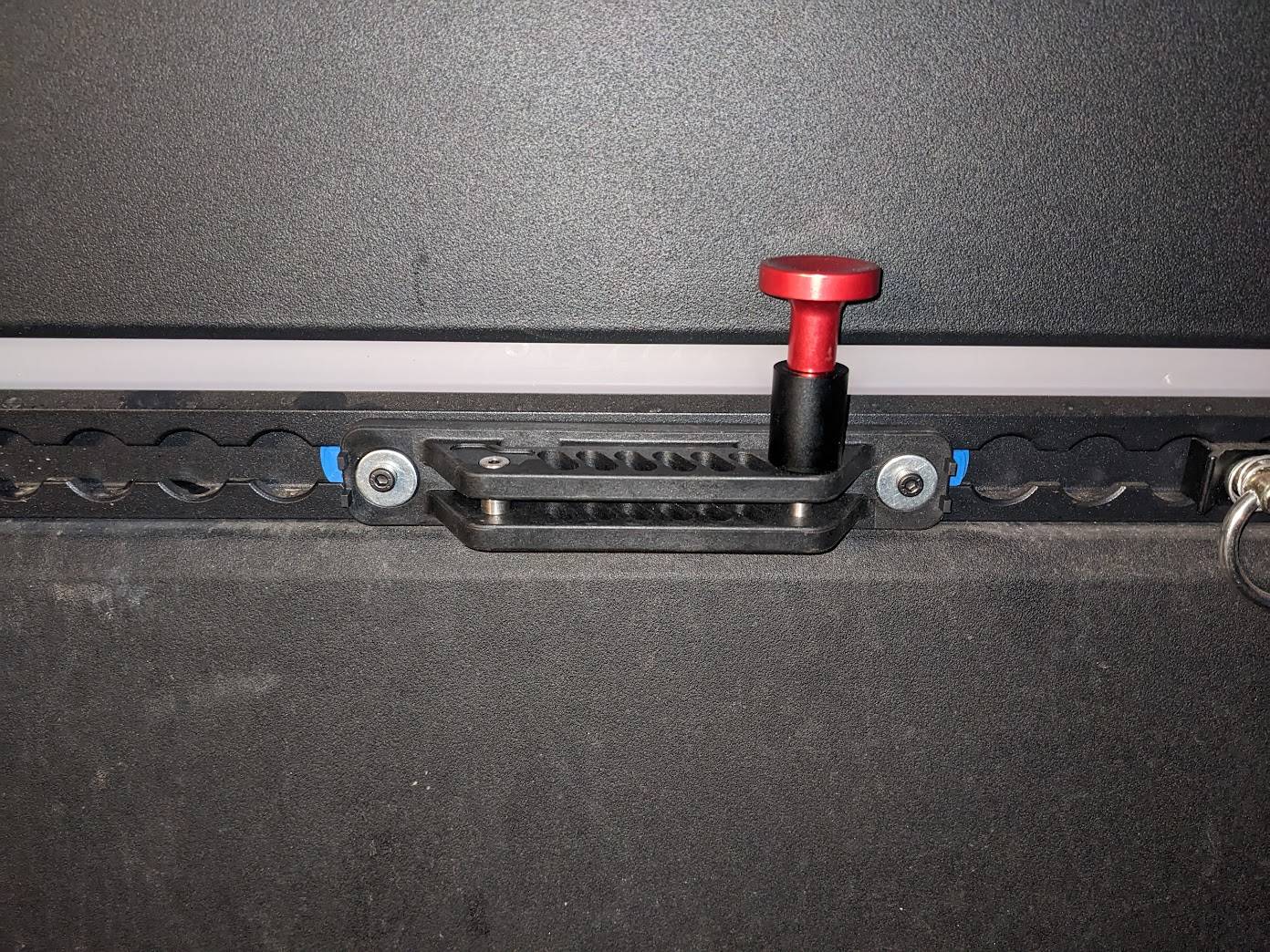

Here are some pics from the actual fitment test... At the second glance it looks like if I offset the hole slightly within the part, it should line up with the mount I want to attach. I will post the modified version later as well.

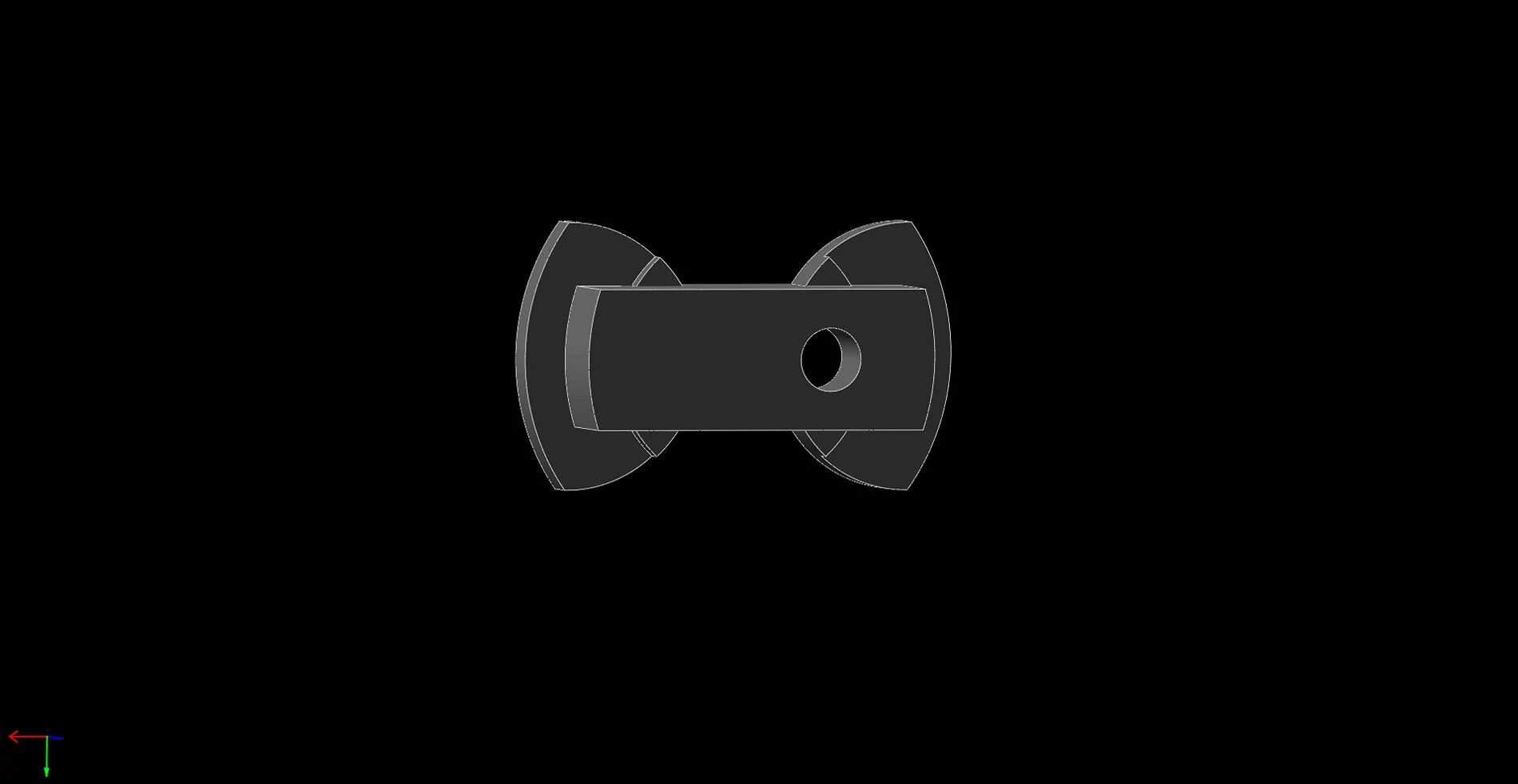

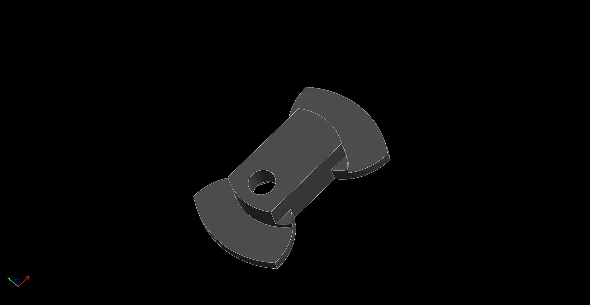

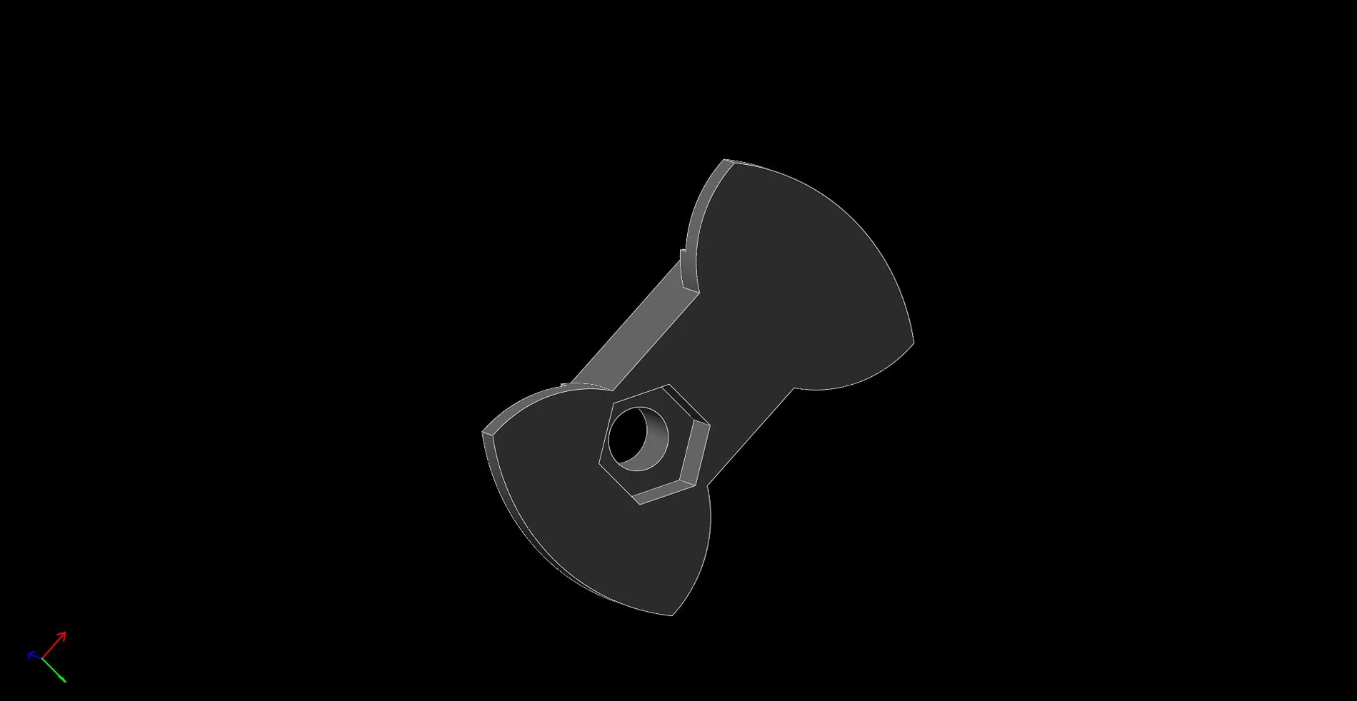

Here is the offset version. The hole is shifted by 5.2mm to give 142mm needed for the extinguisher mount. Also the hole is a bit smaller to clear an M4 screw and has a pocket on the back for M4 nut (7mm sides). Figured there is just not enough meat there for a large self-tapping screw, hence the change.

I don't quite like the offset version as that nut pocket compromises the strength significantly. I will redo it for use with a heat set insert.

I extended the business end a bit for the previous version to give it more strength, I think it should work for now. Previous geometry was circular as an optimization for the idea to make that part on a manual lathe (with a follow up on a manual mill), but for CNC (including 3D printing) that isn't really necessary. Technically it is possible to make the part sufficiently extended to place multiple holes on it at different offsets to allow for attaching things that are pre-drilled either for metric or imperial dimensions.
