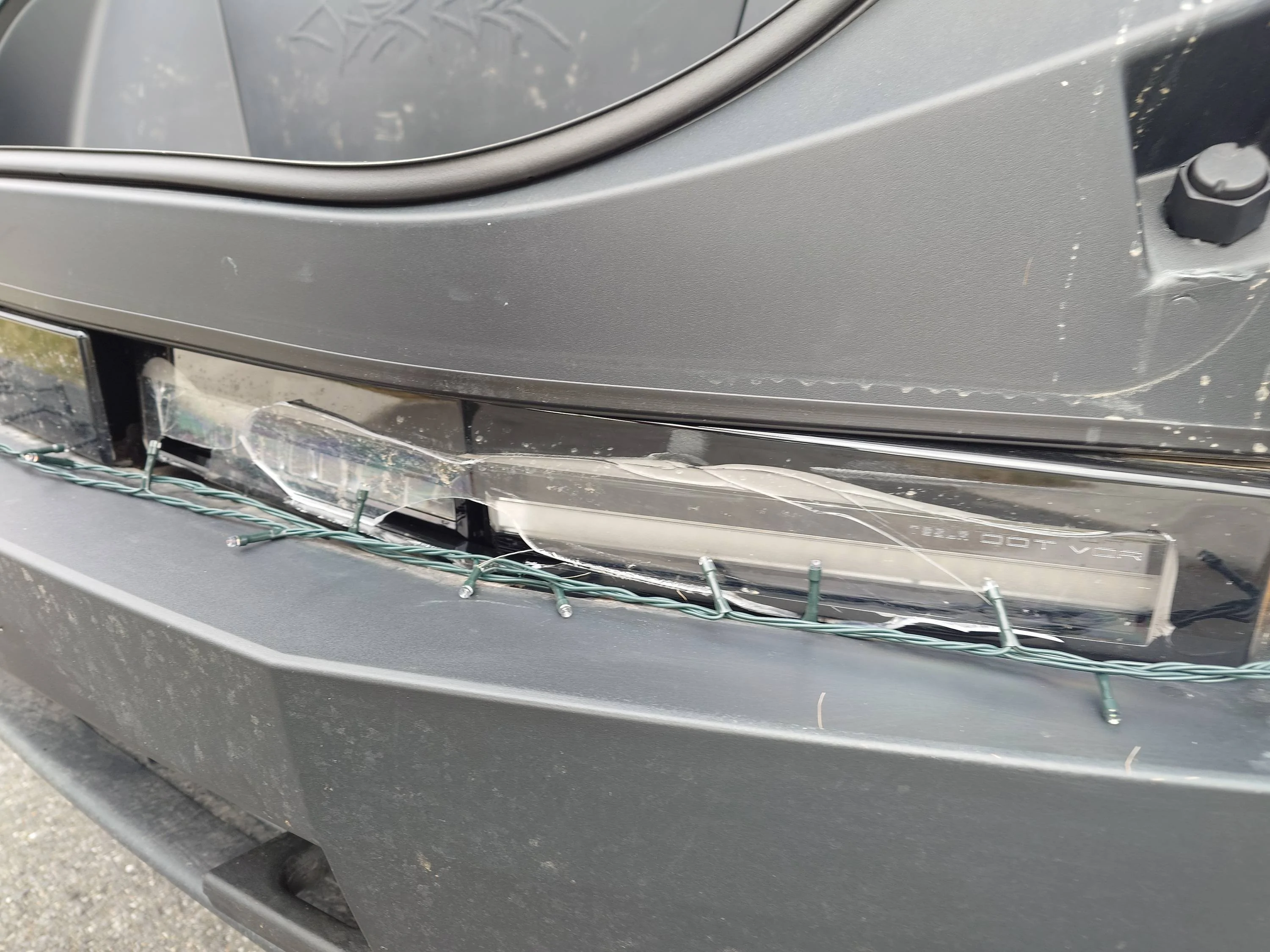

12/17/2024 after putting Christmas lights on my cybertruck a deer decided it wanted to play.... They were nice (for about 2 hours....). I was using autopilot it didn't see the deer at all (ironic, we received the first FSD 13.x late that night...).
Tesla Cybertruck Headlight Replacement (now that I finally got it) DIY Install Process After Hitting Deer 20241217_1918562
Needless to say the deer had other plans : [

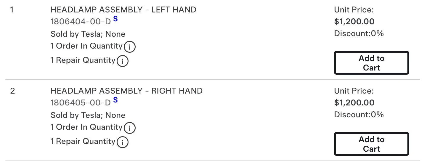

First we can now buy direct from Tesla. Often we will be told to order through the parts catalog, even by service staff. This is not legitimate and DOES NOT WORK. In order to purchase using the Tesla service catalog one must have a business account, to get that business account the business must be in the relevant auto industry.
Tell the service center what part you need and that you have to buy it through them.

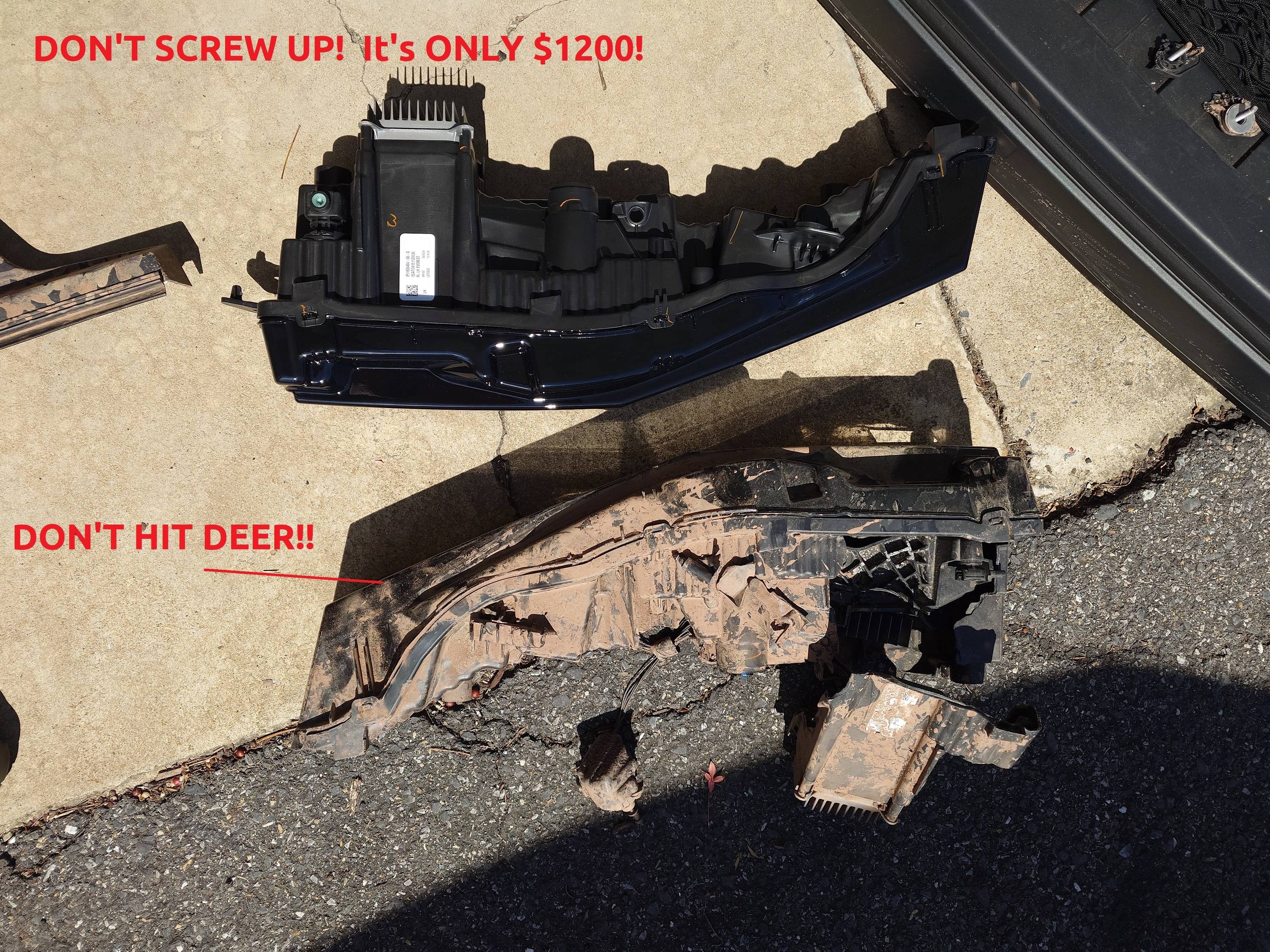

Tesla Cybertruck Headlight Replacement (now that I finally got it) DIY Install Process After Hitting Deer 20250327_141448

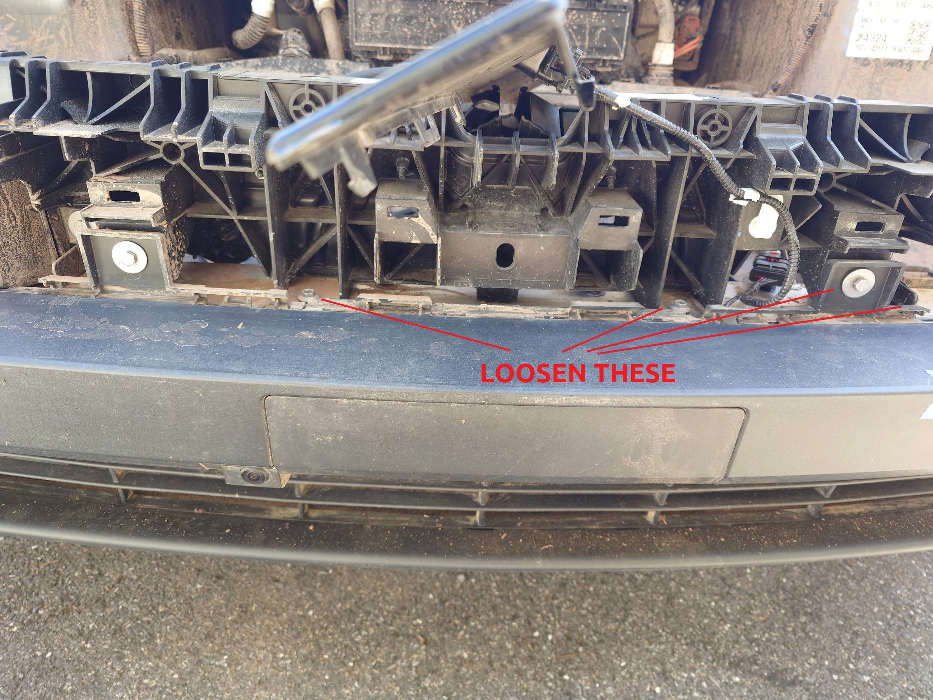

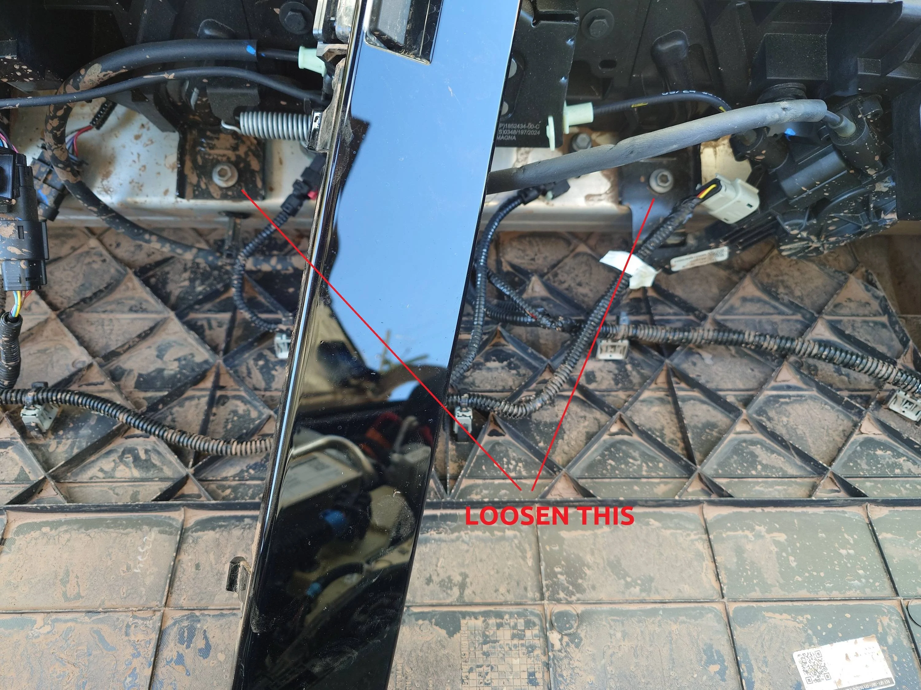

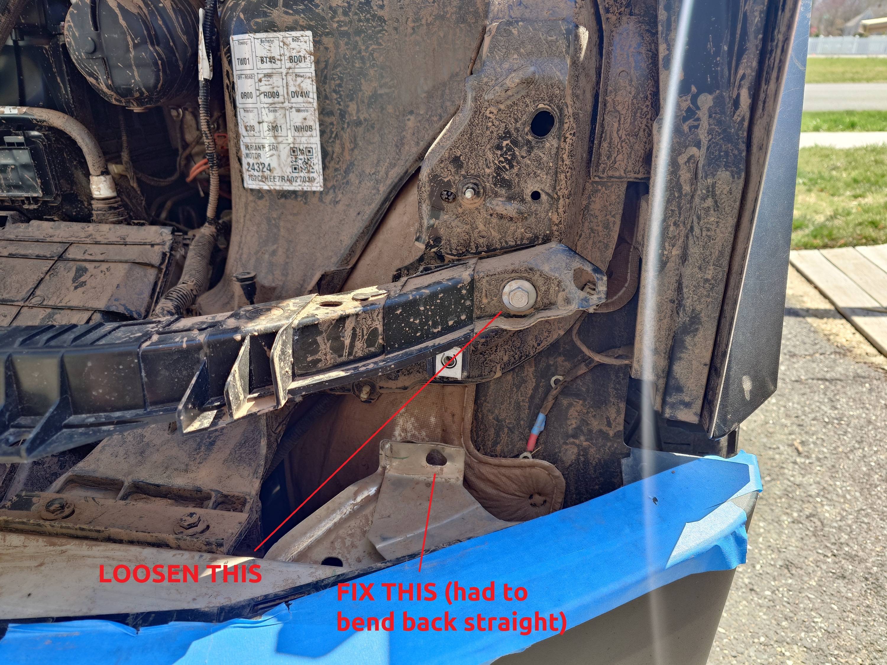

Loosen all the components BEFORE removing the old headlight to save some headache (guess who didn't....).
Tesla Cybertruck Headlight Replacement (now that I finally got it) DIY Install Process After Hitting Deer 20250327_141328
Tesla Cybertruck Headlight Replacement (now that I finally got it) DIY Install Process After Hitting Deer 20250327_142323
Tesla Cybertruck Headlight Replacement (now that I finally got it) DIY Install Process After Hitting Deer 20250327_142328
Tesla Cybertruck Headlight Replacement (now that I finally got it) DIY Install Process After Hitting Deer 20250327_142334

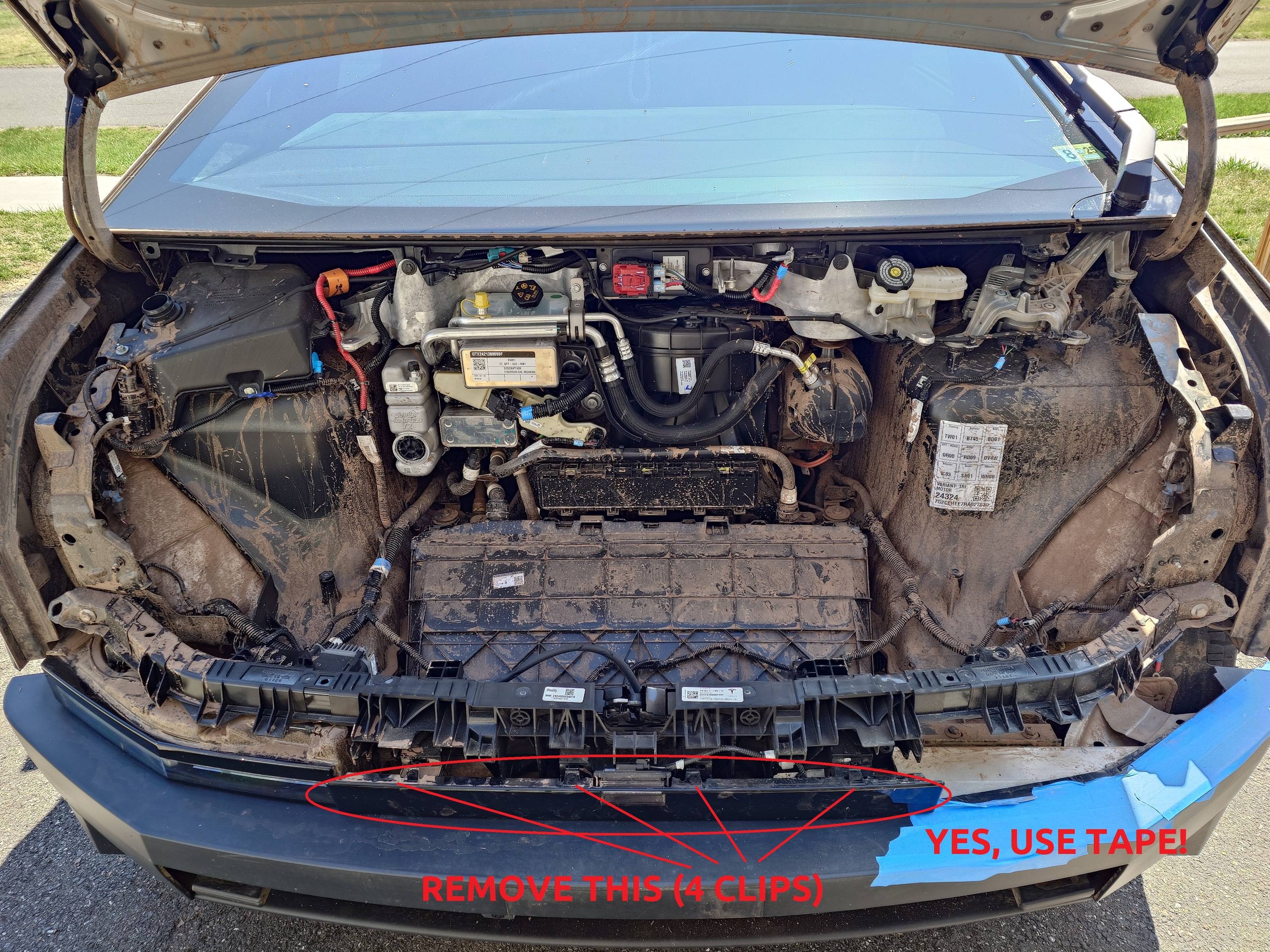

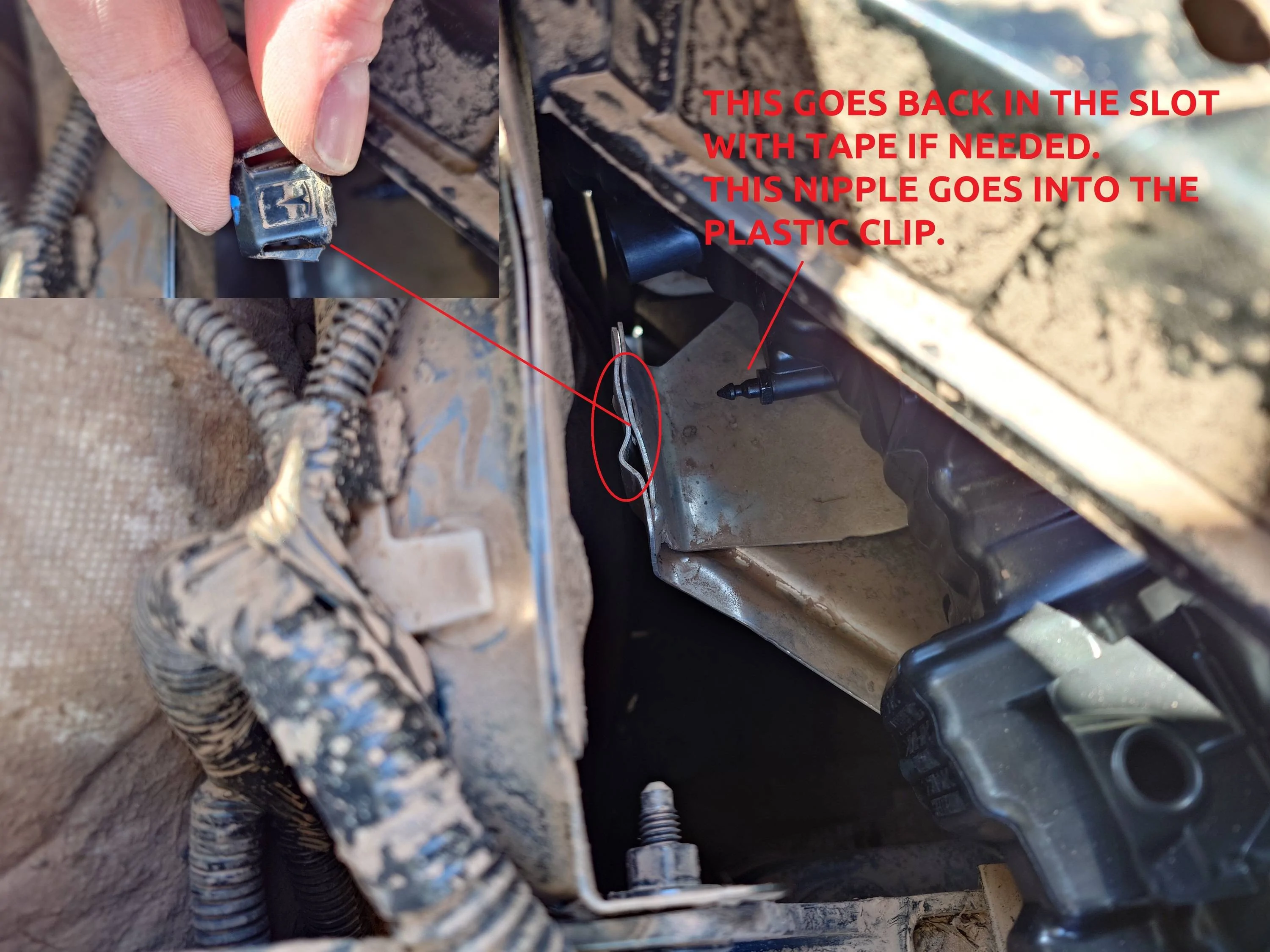

Once everything is loosened and the headlight is removed there is a clip that needs to be found. (disconnecting the headlight is in Teslas instructions read that)
Likely it will be slightly damaged and will need to be wrapped in tape (I used the painters tape) this makes it snug especially as the bracket behind it will likely be damaged (we are replacing a headlight due to impact after all). I had to put and pull the headlight a couple times to get the bracket fit right.
Tesla Cybertruck Headlight Replacement (now that I finally got it) DIY Install Process After Hitting Deer 20250327_142516

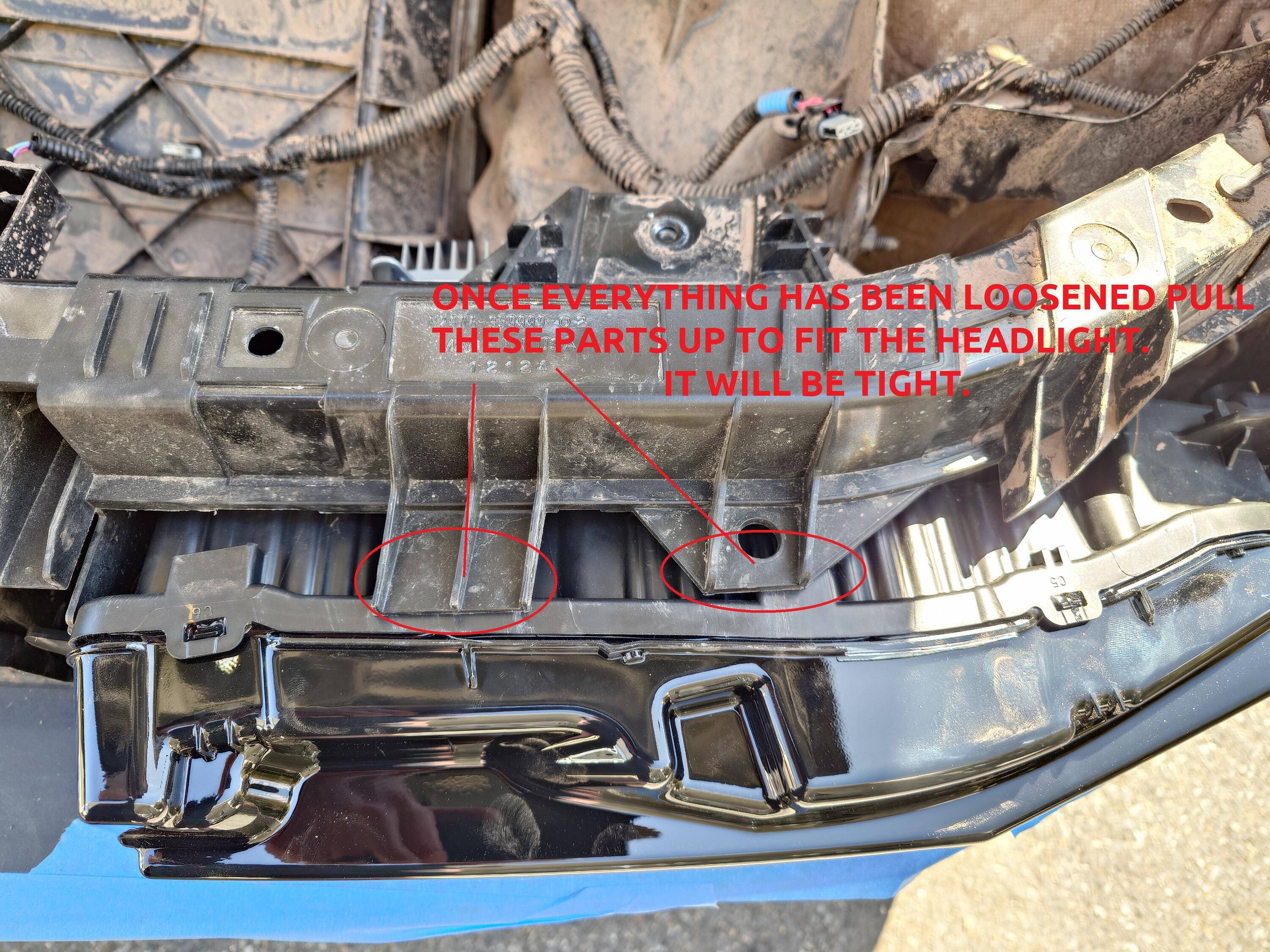

If all the bolts mentioned above are loosened then this will only be a small PITA. The headlight doesn't actually fit, it needs to be gently forced into the slot. The two circled components will be the biggest pain for this. Looking closely at my headlight in this picture there are a bunch of scuff marks on the top part as I had to trial and error learn this. I found pulling up between the two circled brackets worked the best.
The headlight 'falls' into place after it slides in 2/3s of the way (there is a bottom lip that falls behind the bumper).
Tesla Cybertruck Headlight Replacement (now that I finally got it) DIY Install Process After Hitting Deer 20250327_142829

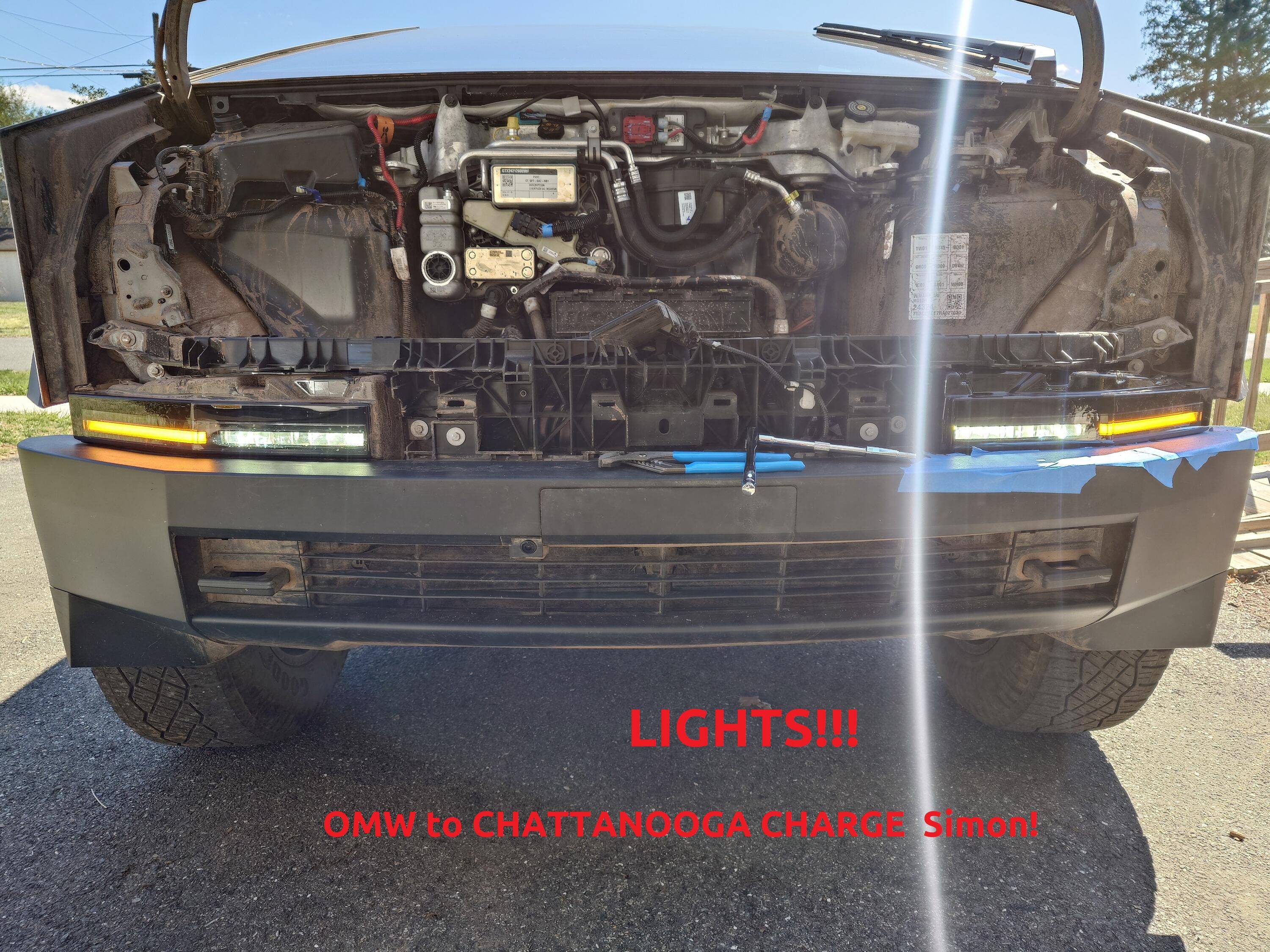

Before tightening everything back down plug the headlight in and test flashers, running, headlight, and highbeams.
Now tighten everything down and LIGHTSHOW! err.... I mean HEADLIGHT!
Tesla Cybertruck Headlight Replacement (now that I finally got it) DIY Install Process After Hitting Deer 20250327_144015
Good thing I have a business account!

Then yours would probably be a little less than $1200 @_0
Nope, still the same price. I don’t get any kind of discount.

When the frunk liner is removed is the amount of mud I'm seeing in these pictures average?
Yes.... Normal mud content.
Although to be fair I was surprised by the amount of mud in there. I would have thought that would have been better protected.

Exactly what I was thinking got the mud up there - I guess if you're doing something like this then next stop is a creek or lake to clear some of that out. The car wash isn't going to get that out of there. Seems to me if you're off roading a few times of year that mud will build up and before you know it you will have your own cyber biom with all sorts of fun plant life and critters catching a ride everywhere ????
